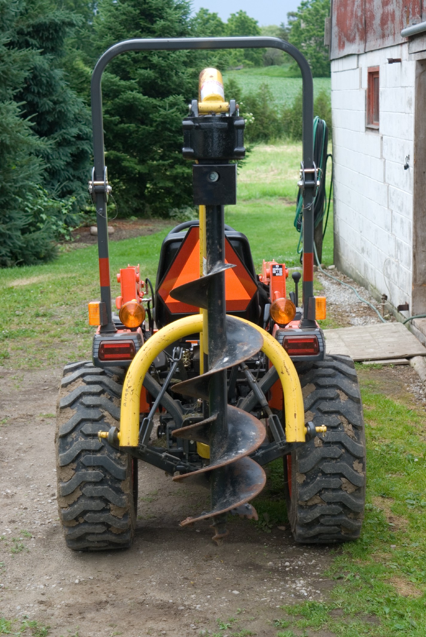

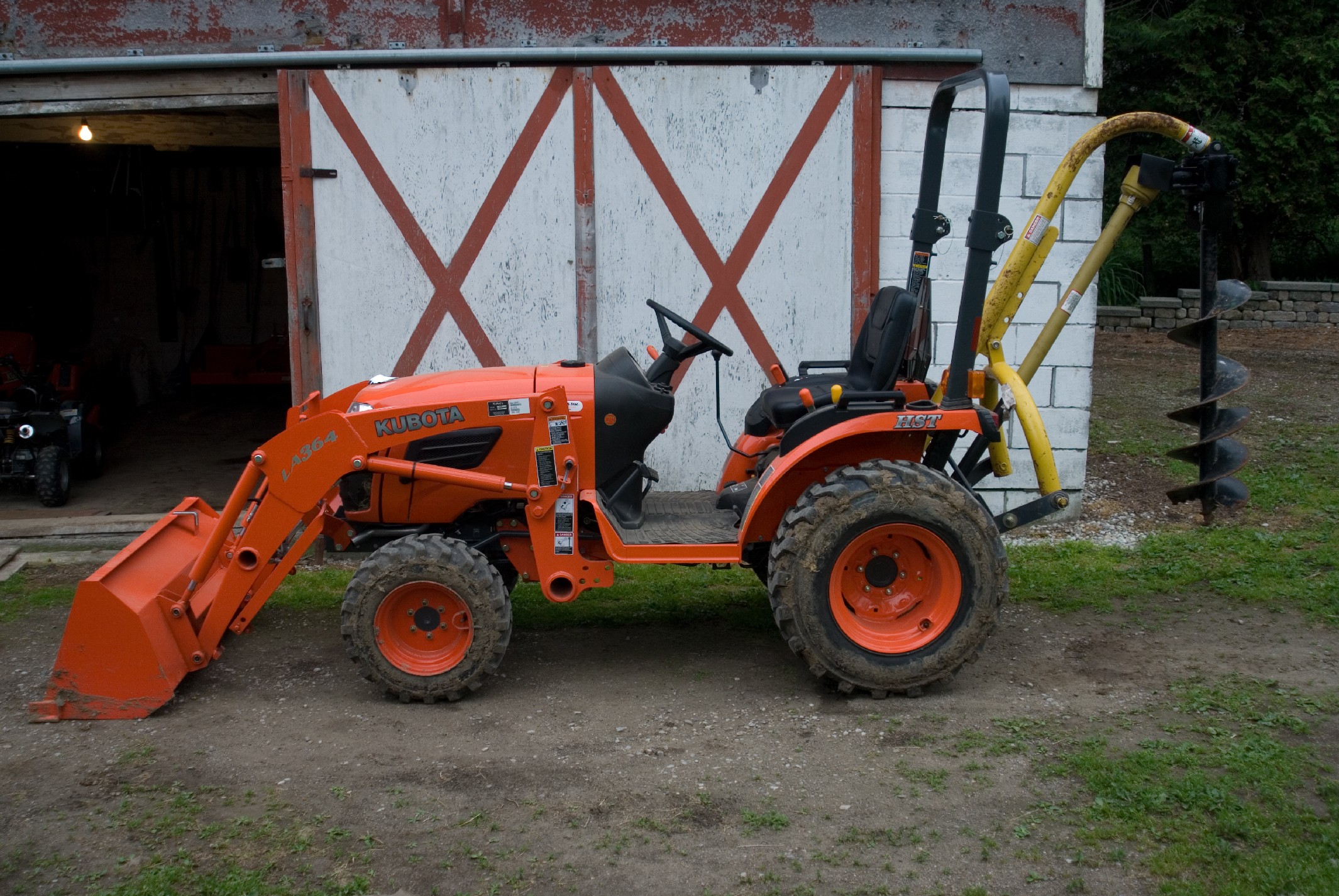

Sorry for not getting pics on sooner. Been having way to much fun.
I've since picked up a used phd and finishing mower. Managed to rack up about 16 hours in a month and the tractor has been worth every penny.

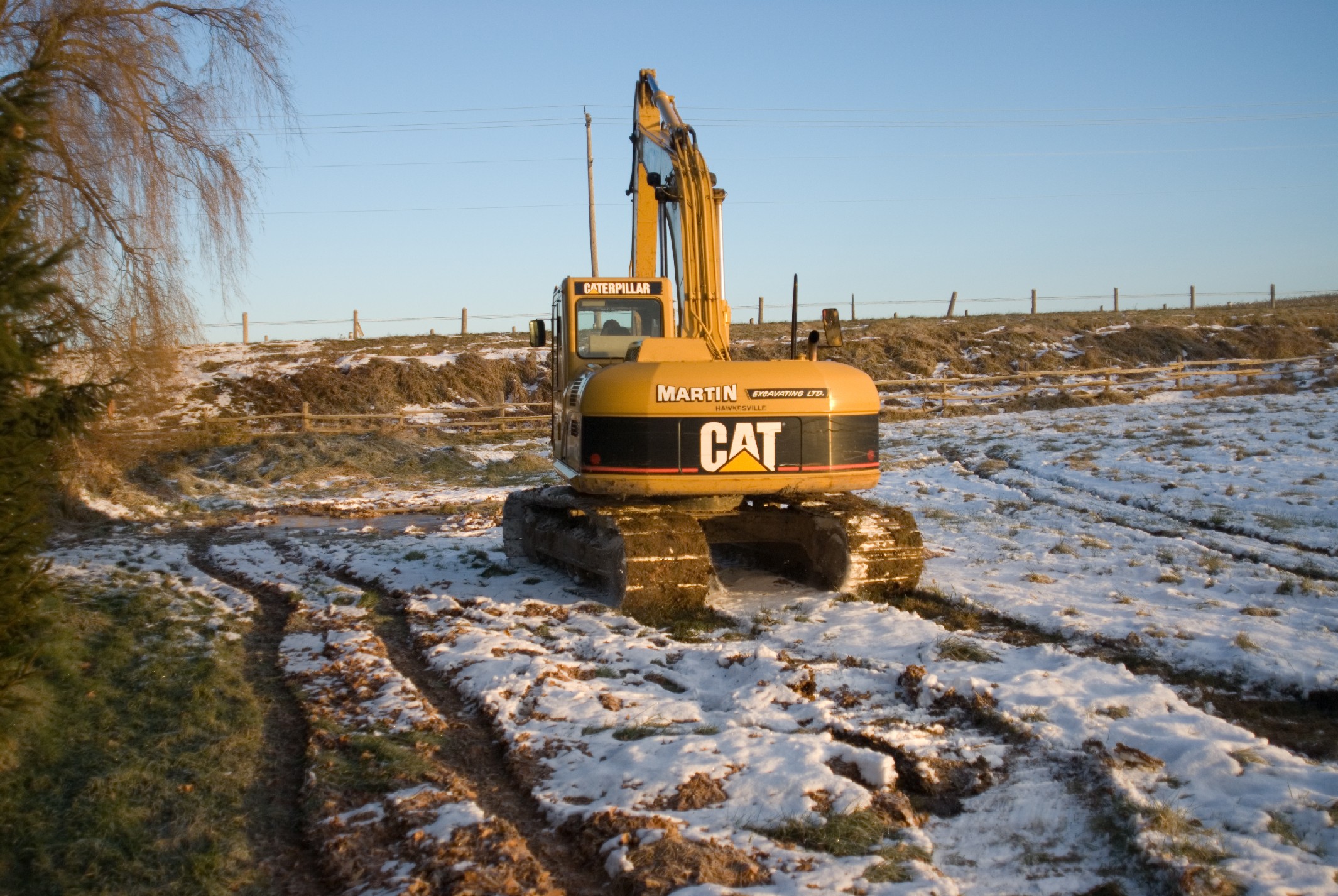

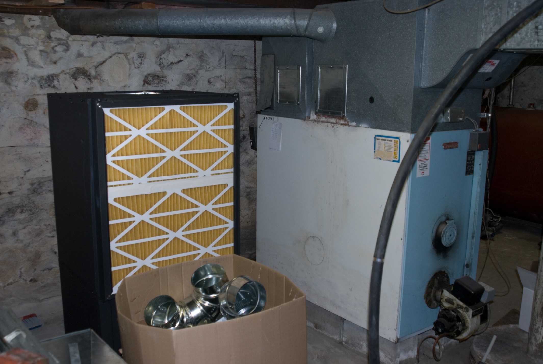

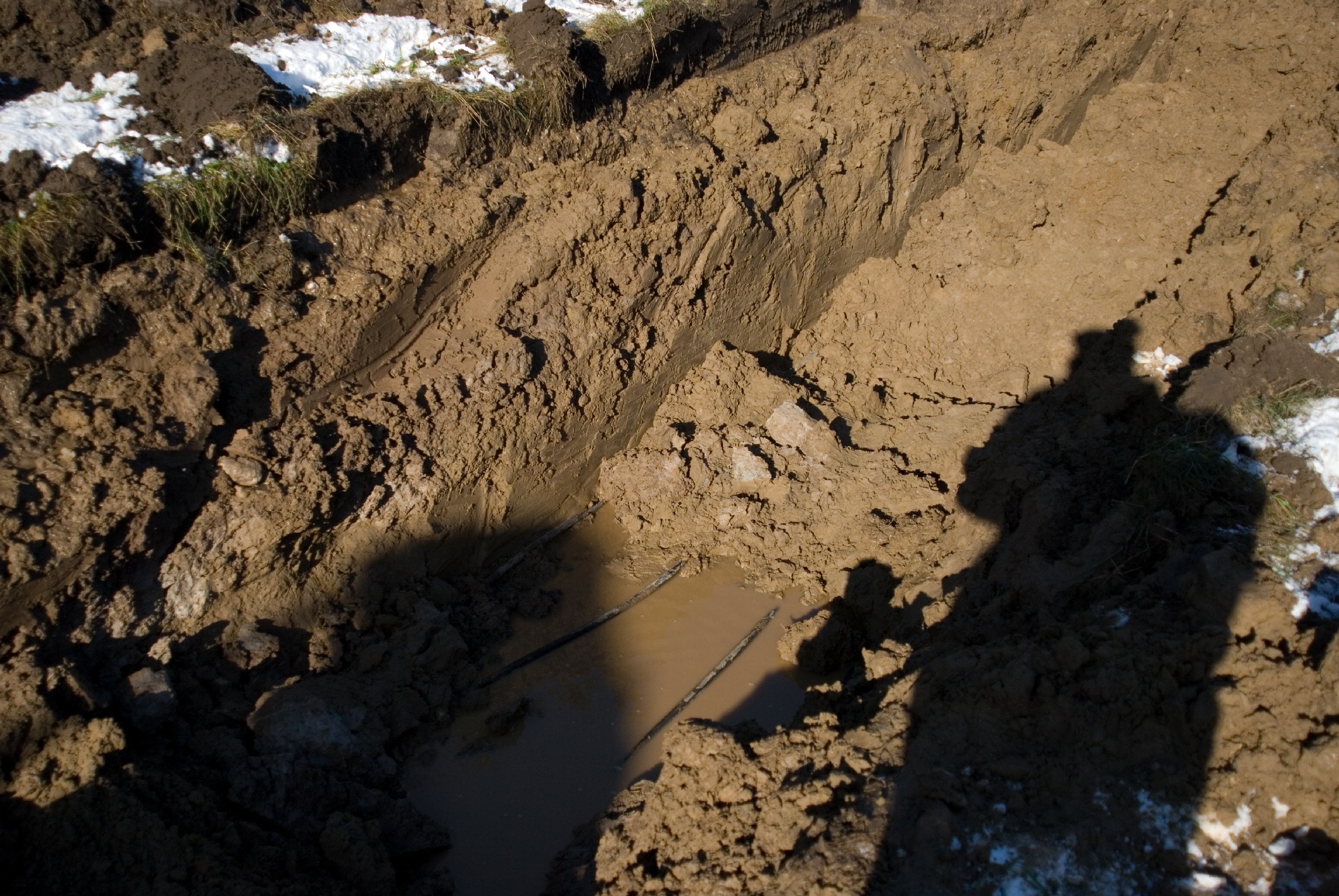

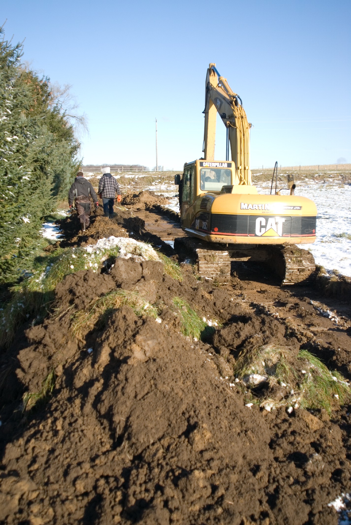

Some of you were asking about the geothermal furnace (water furnace). We installed a 6 ton horizontal loop with about 3600 feet of pipe last november. The loop was installed in the pasture about 150-200 feet away from the house. The pipe from the house to the pasture as installed using a directional driller (see pics). This guy usually installs fibre optic under existing infrastructure and this saved a pile of landscaping and cost. The geo heats and cools our century home through conventional forced air means but at a lower average air temp. Natural gas air is heated to about 120F but geo air is only 95-100F. Therefore you need to move substantially more air. The unit works great and kept up with our heating demands without ever using the auxilliary electric heat backup. After the install, the pasture was a mess and I convinced the boss that a Kubota would make short work of that. I'm sure that an experienced operator would be done buy now but I have a steep learning curve and am enjoying the experience. It is going well but slowly.
