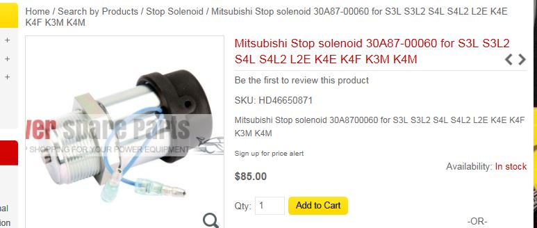

Well so far I completely drained and cleaned the fuel tank. I then took the fuel filter off and drained and cleaned it ensuring fuel flowed correctly. I took some bends out of the fuel lines. I turned the ignition switch on a let fuel flow to ensure it all flowed well and the pump was pumping. The intermittent dying continued with the Stop Solenoid making it's clicking sounds. Could not find this mysterious "Module" and I completely removed the loader arms and hood and mounts to really get in there and look around for wires and anything else that did not look right. I also checked my digital service manual for it also.
I ordered a new ignition switch and ordered a new Stop Solenoid from China paying for quicker shipping. I hate changing parts like this but I figure it cheaper than letting the dealer do the same thing and paying threw the nose for it.

While you are waiting for the parts to arrive, unplug one or both of the wires connecting the shut off solenoid when you need to use the tractor. 'Just might do the trick to keep you running. ;-)

So if none of the parts you ordered solve the problem here is my solution.
If the fuel solenoid shuts of the fuel by having power sent to it for 5-6 seconds then it should be quite easy to wire in a momentary on switch (ie like a starter button) that you just hold in untill the engine shuts off. This would bypass all of the electronics. This doesn't solve the problem but it makes the tractor usable.
