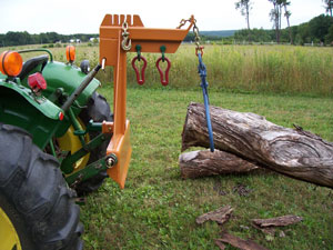

How about those log handlers on the three point . The chain attaches high , the 3 point lifts the log a bit and you can drag it away. Seems like with all the discussion about attaching too high this method would not be too safe. I just dragged out 10 logs like this.

May be this is why i always have my foot right at the clutch when i a on it. I fear rolling sideways, since all my property is on hills but never once have i not been able to push that clutch in fast enough to bring the front end back down while pulling way to many trees up out of the woods. Their must be something to be said about going through the weekend at .5 mph.
