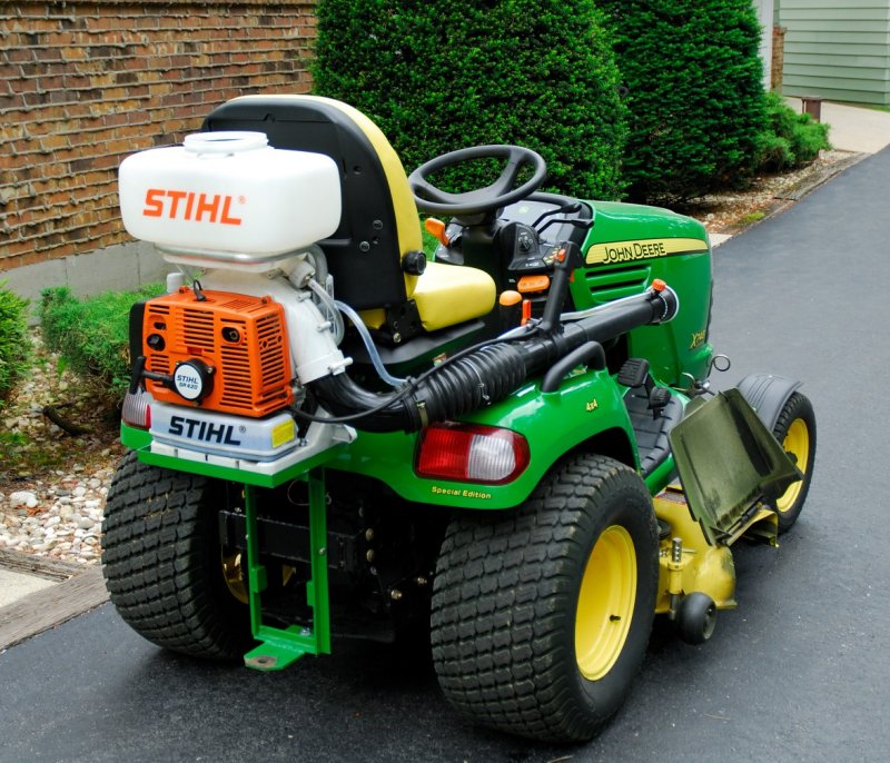

I bought a Stihl ULV (Ultra Low Volume) mist sprayer. It was a backpack unit but I made a bracket and mounted it on my 748. It works fantastic. I use a mix of equal parts of permethrin and PBO. It has reduced my mosquito population drastically. I've been doing this for 5 years now. It's made my property much more fun.
That's exactly like the mister he started with! Bigger demands, bigger mister. He may be willing to sell the Stihl.
