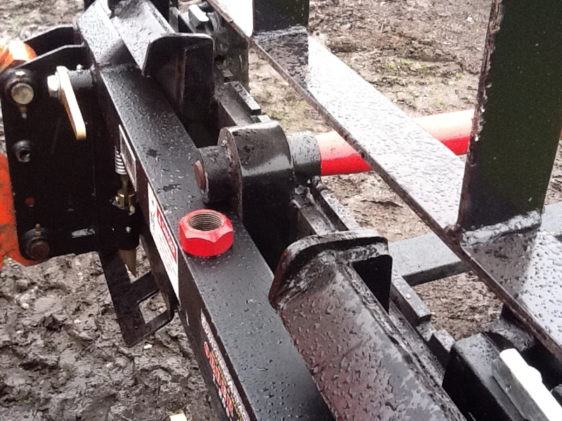

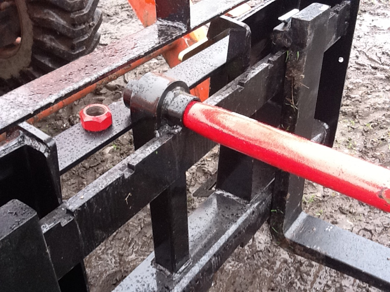

The forks slide right off and the hay spear has a single nut on the end. Using my battery powered ryobi impact wrench I can swap out in under 5 min.
I also have their 3pt spear. Same setup.
Correct. Here is a picture of mine on day 1. Mine had a welding bead inside the taper and the spear would not slide all the way in when I took these pictures. I was like "what the" until I felt inside. I rat tail filed the bead off and the nut fit fine.
