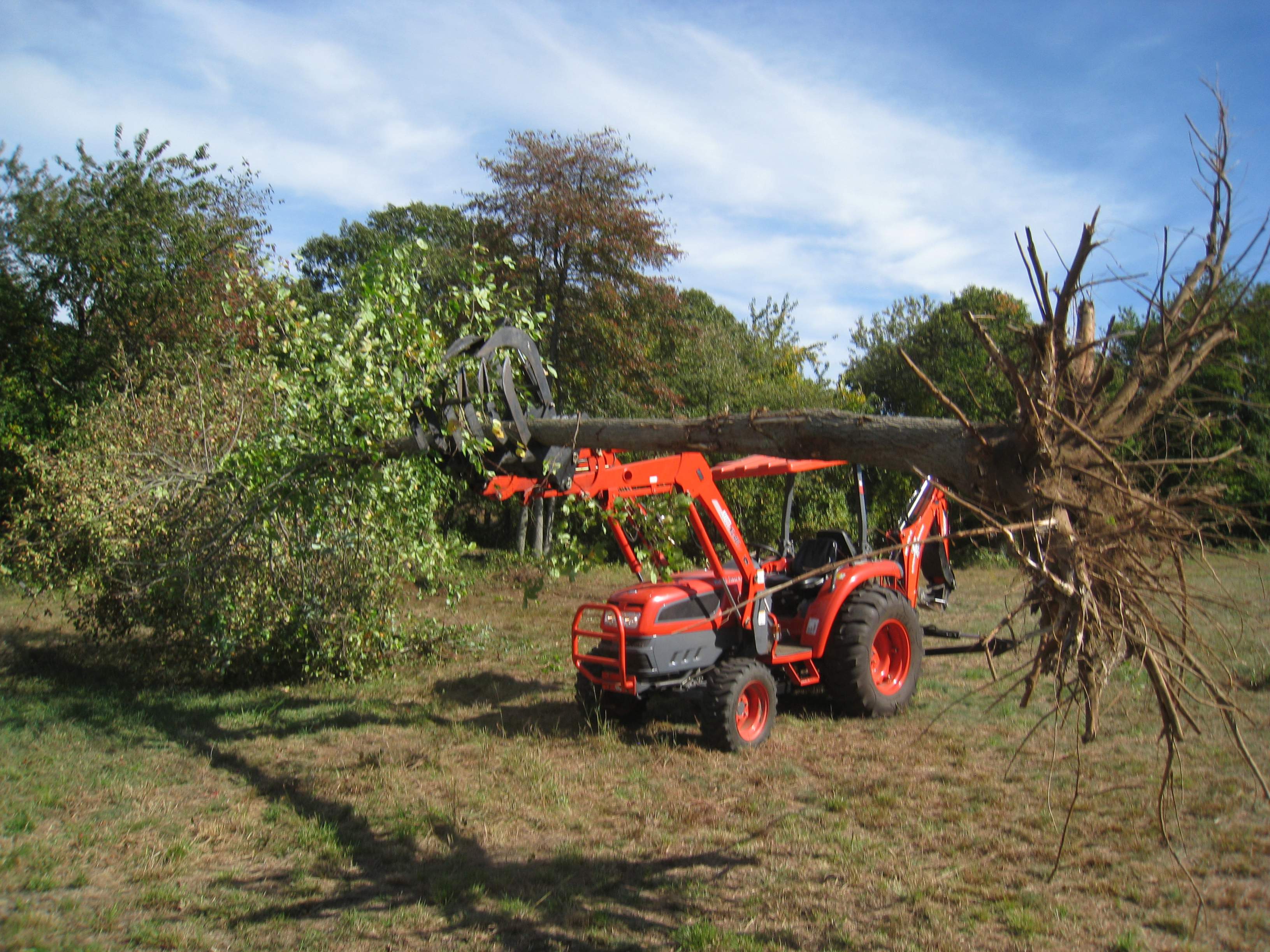

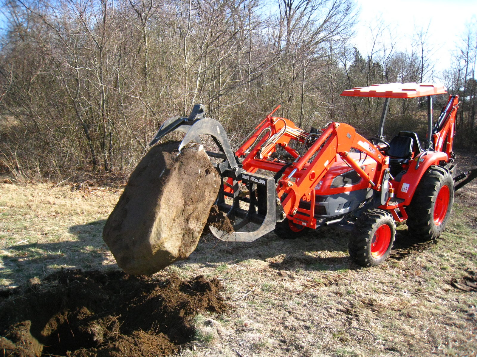

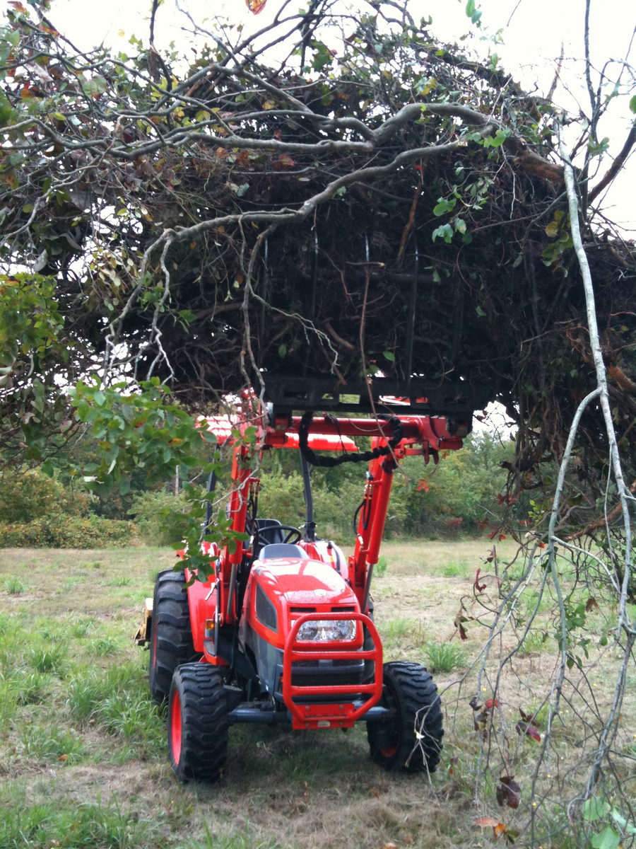

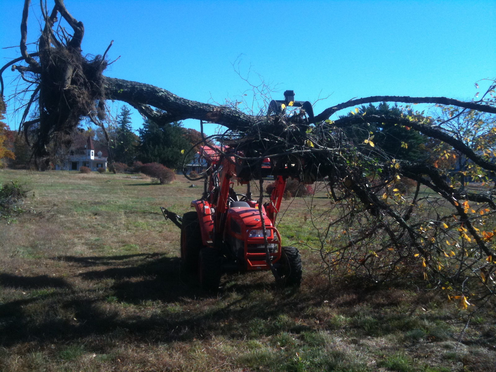

What if you are grappling large trees and backfilling dirt? Does that justify a M9540 sized tractor?

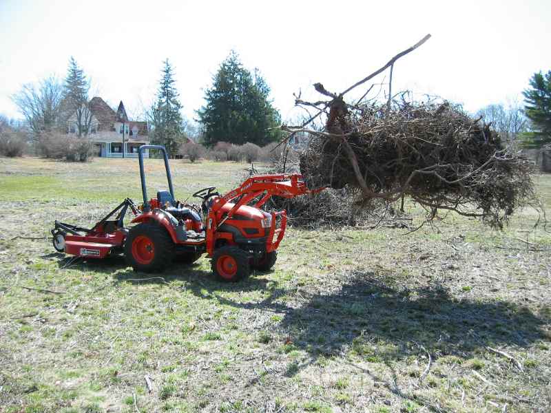

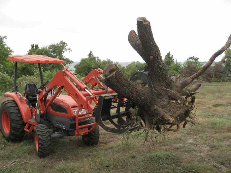

No. A 40hp tractor can lift 2700lbs (maybe a bit less if it is a Kubota;)) and you will never grapple more than half that much brush in one bite. Even a whole moderate sized tree can be lifted and moved by a 40hp tractor. Few tractors have buckets bigger than six feet or so and that is the size you'll find on a 40hp. Get a bigger bucket if you are just moving loose dirt but you won't need more than a good 40 hp tractor.
Here is a 40hp tractor at work with a grapple: (note that the biggest brush load is being lifted by a 20hp tractor (CK20), the rest are a DK40se).
