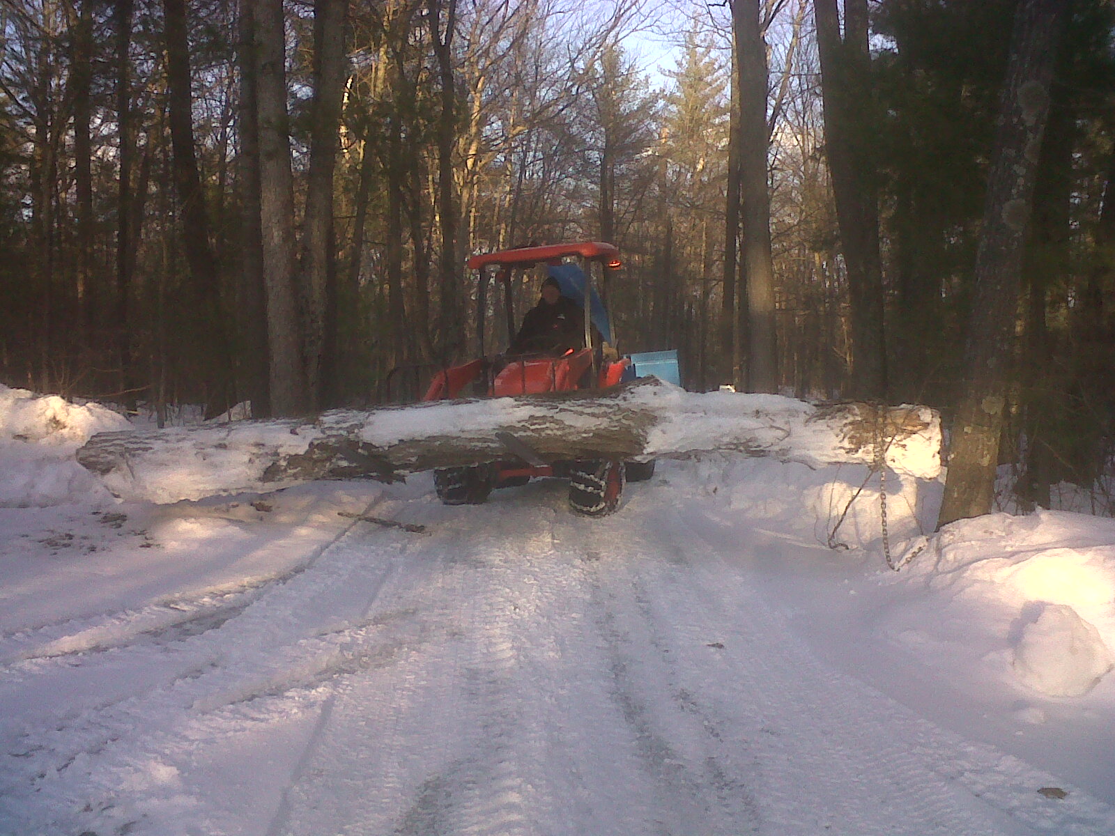

The size if the trees is about 20 in. diameter and 15' to 20' long, although you could cut it in half.

With a 39HP Tractor I can just pick it up and drive it home. I did need someone standing on the snowblower as it was light in the back end.

   / Tractor for 20-50 acres #46
LOL, might need a pilot car for that wide load.

For the size tree your talking about 30HP w/ a log arch may do, w/o it won't.
About 15 minutes ago I got back from trying to haul a 12' chunk of oak about 16" DBH.
attachment.php
30 hp Satoh, no can do. Lift it w/ 3 pt, front end leaves the ground. Sure I could load the tires, add weight etc. but it's near the limit. I figured it would be close.
Time to get a better method or bigger tractor.
