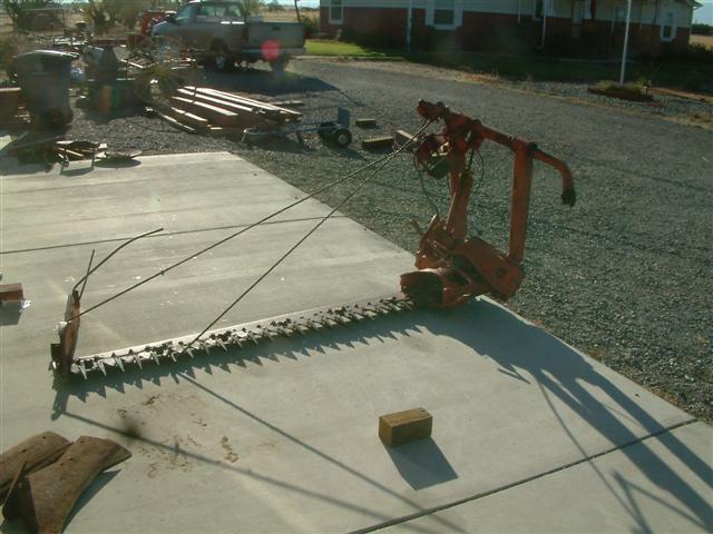

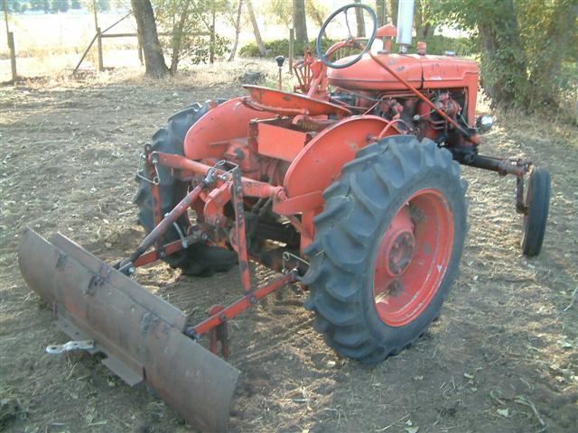

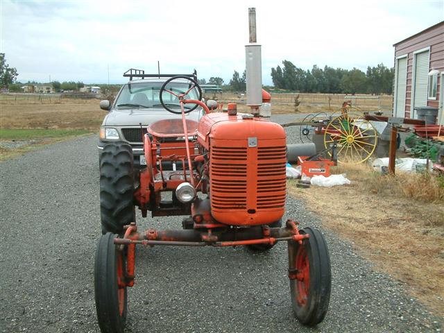

If your budget is really limited, check out older iron like my 1951 Farmall Super A. Bought it several years ago for $1300. Came with 3 point hitch (Farmall's of that vintage usually had 2 point hitches), a mid-mount 6-ft wide sicklebar mower and a 5-ft rear scraper blade). I formerly was a CHP tractor for mowing highway ROW.
Small as it is (about 16 hp pto), it can do impressive work--like running a hay baler. This video documents a Super A restoration project and shows it running a baler (about 6 minutes into the video).
[ame="http://www.youtube.com/watch?v=Cvz8-Sw1ntA"]FARMALL Super A - YouTube[/ame]
Good luck
