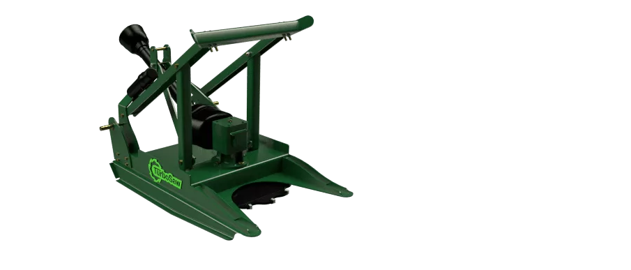

If money was not an object and you enjoy working the land" I would buy a Turbow saw.
