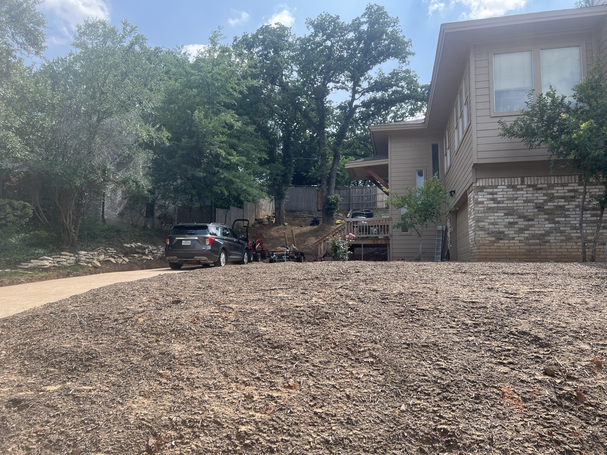

I’ve read and skimmed almost every post.
Tanzania?! Wow! You’re really committed. But who could blame you with a good price on land. I think I’m a little more practice than most of those responding. Going big is not always the best way to go if you’re limited in resources (parts and equipment). Definitely buy something you can repair. You should start by making yourself a vegetable garden, assuming you have access to water. If no water, drill by hand. There are videos on YouTube that can help. If the water is too deep that’s a whole different research project. A veritable garden will give you food to eat and sell or barter with. It will also give you a feel for the soil. I’d start by clearing about 5 to 10 acres. I’d definitely start with a decent size tractor. But nothing less that 50 HP. I have a 20 HP Mahindra. It’s awesome. Bought it for excavating (digging and moving 2700 psi clay and stones varying from 3” to 18” mixed in. This thing is super powerful and strong for a subcompact tractor. It would be great on a 5 to 10 acre property.
Buy a beginner mug, tug welder. Flux core welding could save you a lot of trouble finding and buying the gases used for them. Learn as you go or OJT it. Just don’t get to brave with structures that could kill or injure yourself. Lots of YouTube resources for that too.
There are several tractor implements that will enable you to achieve your goals. But I’d parse out the land in a way that makes sense and clear and cultivate as you go. In order to prevent erosion problems plant something that you can turn into the soil later and after a spell plant your desired crop. Make sure you have a way to provide enough irrigation to the fields though. Water filled tires can really help you lower the center of gravity who’ll adding much needed weight to your tractor. Add something that plugs up punctures too. Start basic and add ass you can. My grandfather had a farm with 40 head of cattle. He planted several different crops like snap beans, field peas, corn, melons, potatoes, etc. he also grew hay for the cattle. We were all expected to help.
Terrain wise I assume there aren’t a lot of “real” trees like in our forested or wooded areas. Probably like midwestern Texas. Mesquites. Small trees.
I wish I could help just for fun and the experience. But I have my own family. My crop is lawn grass. 🤣
I miss being on the farm. Great experience.
Bulldozer is way out of wack unless you’re clearing and grading land for development (homes). I have experience in all of these areas. Excavators are nice but you can do those things with a backhoe and loader. I’m also an experienced civil engineer. Surveying and mapping are part of my skill sets. City Planner too. I wanted to do environmental Engineering but learned it OJT. Terrace you land. Learn to grade.
