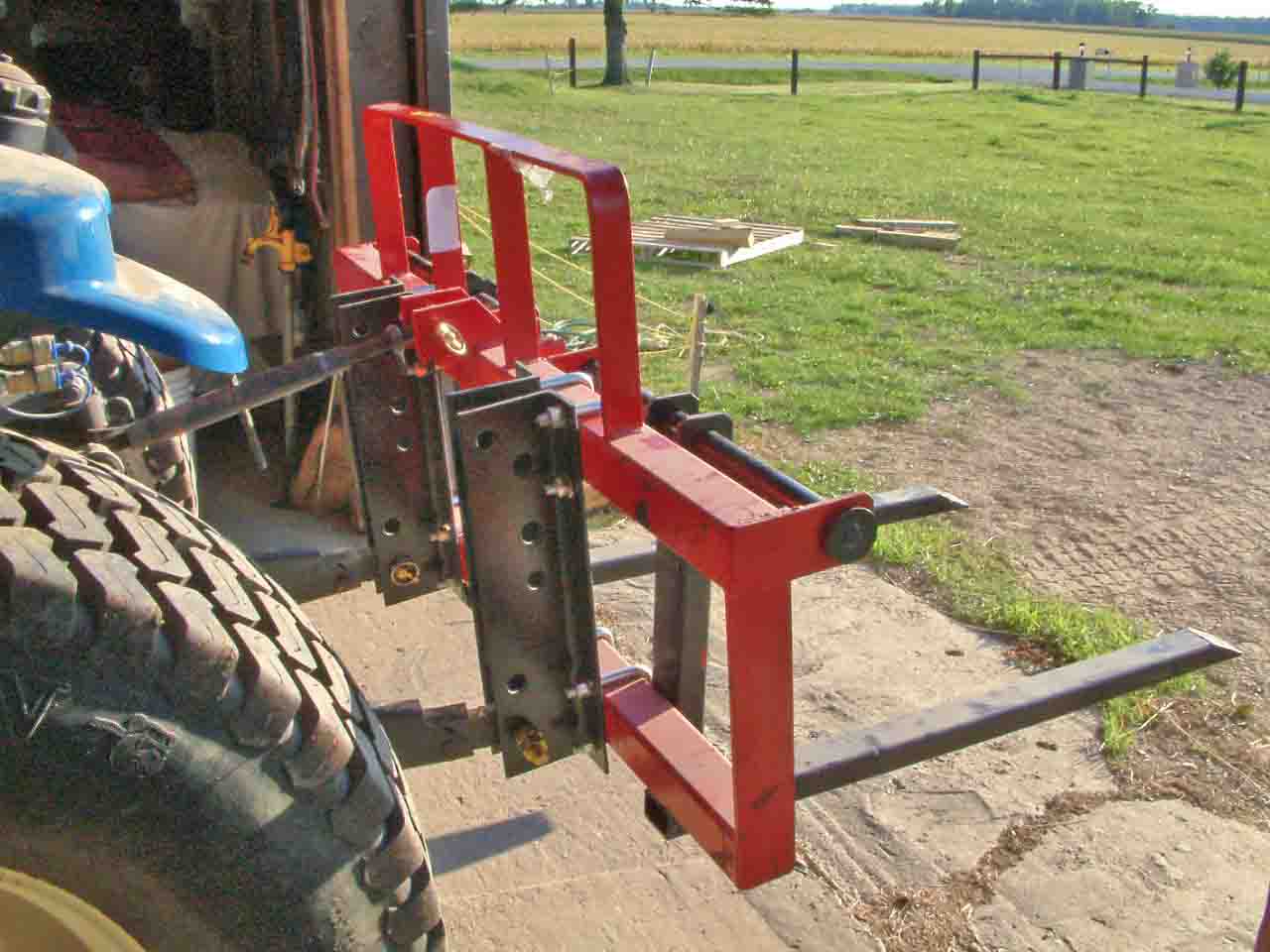

Got myself a set of forks off of e-bay. Check out the pic. Some of you may recognize these. They have been on sale for some time.....Seller keeps getting new ones in. Their built like a TANK trap. This is my first rear implement although they are also designed to go on FEL. Tried to install & guess what......no pins for either top link or lower arms. Needless to say I was bummed out. I paid $500 US for these. Seems rediculous to me that seller would not provide the pins. What are we talking about......$10 bucks. Had to go out & waste 2 hours looking for pins. Farm Supply source I checked out indicated they don't normally carry too much Cat. 1 lower links as they are NORMALLY supplied with implement at time of purchase. NOW I'm really starting to get bummed. :mad: Ended up getting something that was Cat. 1 but threaded. Tried it out & so far OK. Am I out of line expecting to get a rear implement ready to use without any additional hardware ????????:confused:

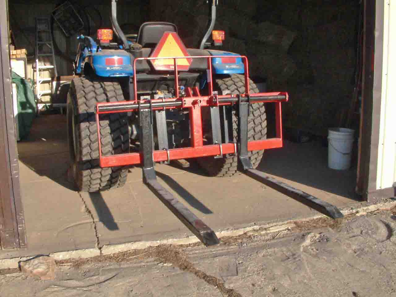

Here's a side view !!

These are a nice deisgn, that's why I wanted them. Can go on both the FEL & 3 Point Hitch PLUS the forks are adjustable IN & OUT.

I suspect they leave the pins to your imagination because of the many possibilities for mounting something like that. So don't be too hash! Looks like what I have been wanting for my FEL. Looks like the forks are free to move sideways on the bars, are they free swinging also? I can't tell from the pics - about how wide are the forks, 4-5"? Enjoy!

That's just it. Are not all Cat 1 lower link pins 7/8" diameter. Further, Seller knows from his design what length is required. So as far as I am concerned, should be provided....or at least an attempt made. If this was a private sale I would have no issues with it. However, this is a Company selling these with other items for sale on a regular basis. THEY KNOW BETTER. Without the pins the forks are useless.
On a brighter note, they do seem to work well. Only tried them out with some rock I plan to move this PM for approx. 20 minutes. The forks are free swinging. Made out of channel steel approx 4 to 5" wide. Capacity is 2000# but I suspect they can lift considerably more.

From the looks of the side picture, you need a through pin or bolt on the lower link, not a standard pin bolted to the implement. That might explain why there isn't one supplied.

Don't really understand what you mean. I do have a through pin but half of the shank is threaded. That's all they had. I called up a CASE Dealership & they also did not have a Cat 1 (7/8" dia) through pin, only threaded type.
To attach forks to FEL, I have to take "pin-on" bucket off. (Is not QA) This will be a bit of a pain but I would probably have spent $2,000 easily for QA plate, mods to bucket & then got QA forks. I wanted something that I could put on the back for the increased lift capacity. Unfortunately, as I learned yesterday, need top & tilt for 3 pt or this becomes almost useless if tractor is at an odd angle on a slope for example. Took me 3 hours to place one 1500 lb rock yesterday. Just brutal. Could not get forks out from under rock without rock moving with forks. DUMB !! :(

From the pic, it looks like your lower arms fit between the plates on the back of the implement. On other implements, there is a pin sticking out that the balls slip over and a lynch pin locks it in place. This rig looks to me like a 7/8" bolt through those black plates with your lift arms in the middle would work just fine to hold the lower links in place. I'd go wth grade 5 or higher. I suspect a bolt will be cheaper than pins and a lot easier to find. If you really want to use lynch pins, just drill the bolt or use a section of 7/8 round stock, but that's usually grade 2

You are correct with respect to pin going through first black plate then through lower arm link & then on through second back plate. Do you think threaded section will scar the inside of the balls of the lower links ?
