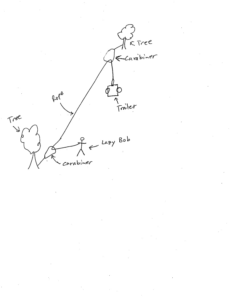

Lazy Bob,
If you are doing this a bunch, Artisan's idea should work great.
Another effective method that is simple and cheap would be to just use a rope and 2 carabiners. I've done some rock climbing and can easily lower another person down a cliff using equipment similar to this (but more specialized for climbers). Lowering your trailer down the hill would be no problem at all.
attachment.php
attachment.php
Tie one caribiner to a tree at the top of the hill. Tie the other caribiner to a tree at the bottom of the hill. Tie the rope to the trailer at the top and run the rope through the carabiners as shown. The friction caused by the rope's rubbing on the carabiners will reduce the force that you have to put on the rope when lowering the load down the hill. Don't load the trailer heavier than the load you can physically handle with the rope. My guess is that an average man could easily lower 200 lbs in the trailer down the hill, maybe much more. If you wanted to lower a heavier load, just put 2 wraps of the the rope around the bottom carabiner to give you extra friction so you can lower a bigger load.
Just make sure you use carabiners rated for carrying a load, not a cheap keychain carabiner. You can get carabiners at many outdoors stores or could easily order them from the internet. You could also just use 2 clevis hitches with pins through them instead.
Let us know how you do it and post some pictures!
Hope this helps,
Obed

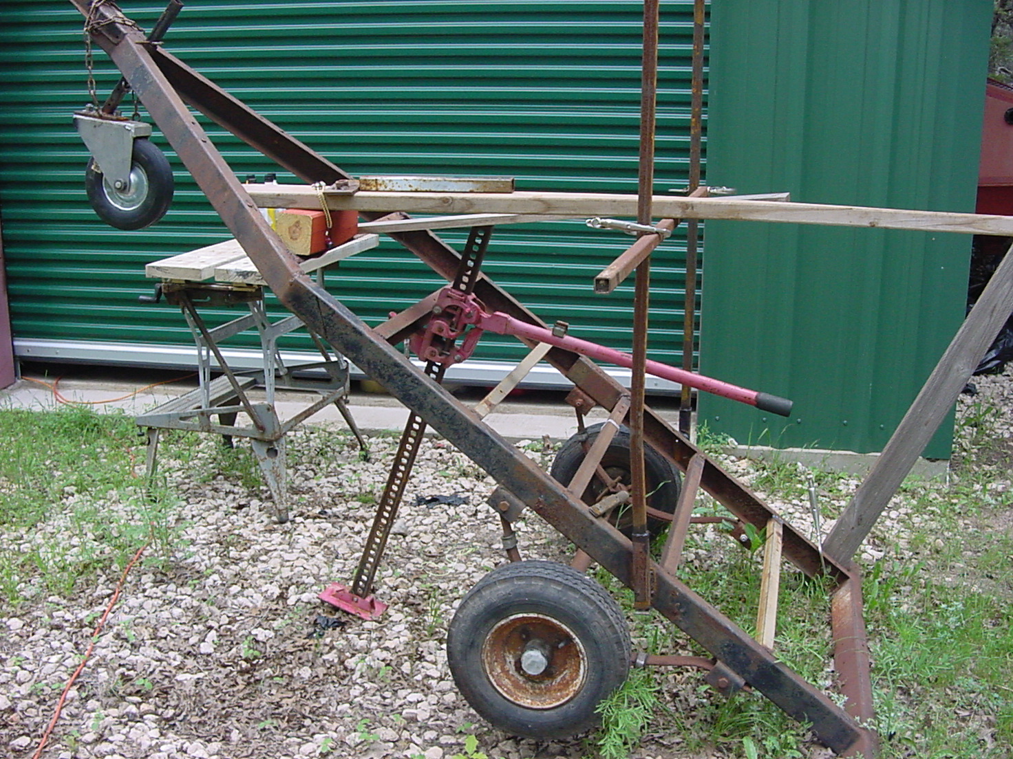

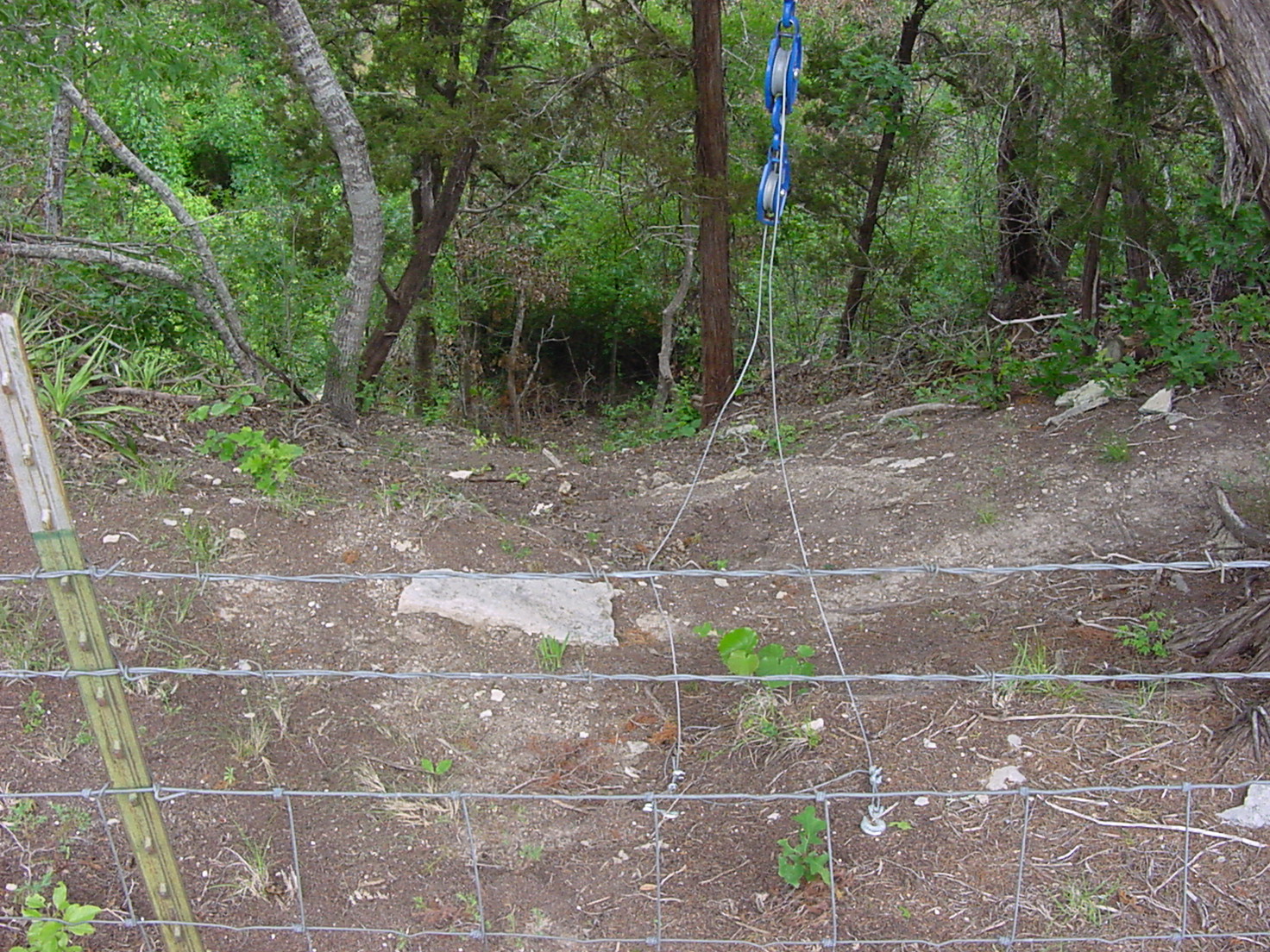

Here's a progress report on my tool funicula.
First a requested picture of the intended path- about a 40 degree incline 100 feet long. As expected its hard to tell much from this but here it is FWIW.
Second, a picture of the funicula trailer I am building. A few more welds and its ready for the horizontal plywood bed. A miscellaneous note: the "nose" wheel is off a Bensen autogyro my brother and I were building when in highschool.

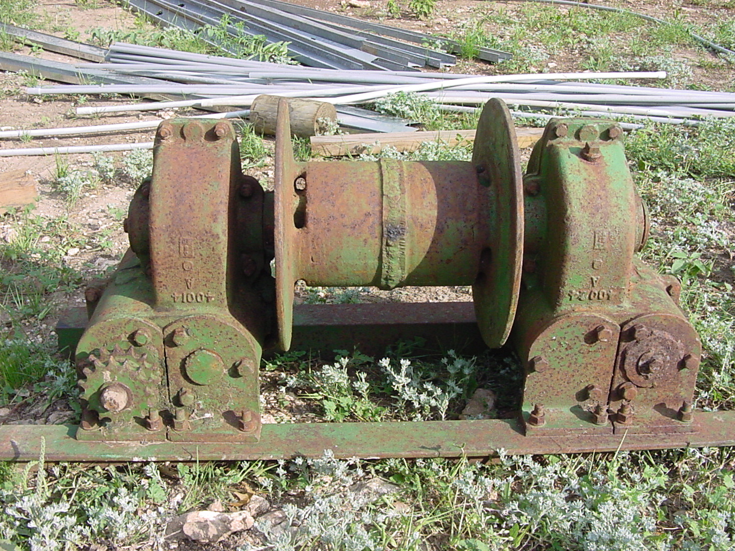

Lastly, I just bought a huge old PTO winch in the third picture from the Silent Winch and Crane company. If I can figure out how to drive it with either my tractor PTO or with an electrical motor it will be my intended mode of moving the funicula trailer up and down. That would then replace my plan for a redneck winch by substituting a drill pipe "drum" for my auger on my posthole digger as the takeup spool and using my tractor PTO to power it.
I'll keep you posted as I get further along but I've got a bunch going on at present.
Many thanks for your input. If you have any suggestions on using the winch, see my other post "Big ol' winch: HELP !" and please append. Thanks !
