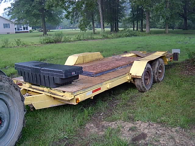

I have hooks welded to my bucket, and use 1 High test 5/16 chain on the front but hooking to the trailer then to the hook, then throw the chain to the other side and repeat. Then at the back, I have a clevis on the draw bar and run a 3/8 high test chain through it and use a standard binder with a 2 ft pipe to cinch it down. This setup works great, and is safe and quick. When I load up tonight, I'll try to take a few pics to give you a clear visual.
Does anyone use the ratcheting type binders? I bought one to try but don't care for it as much.
