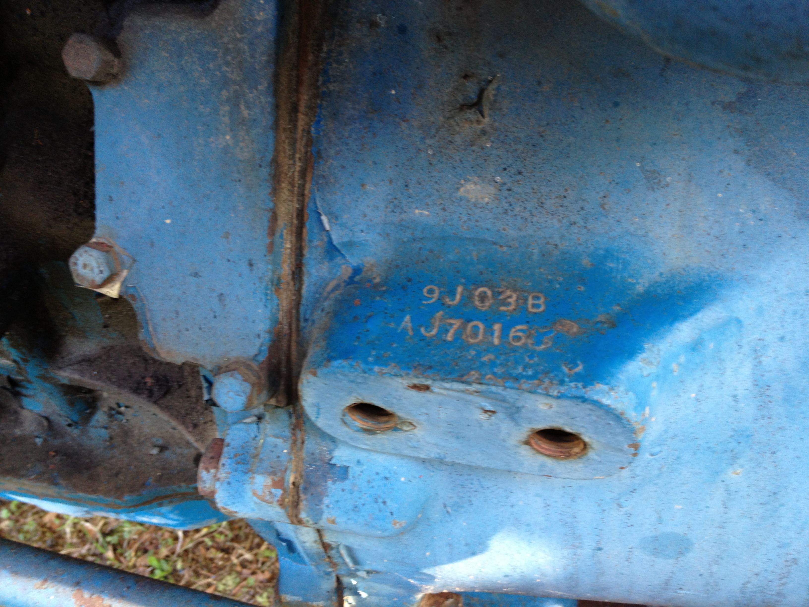

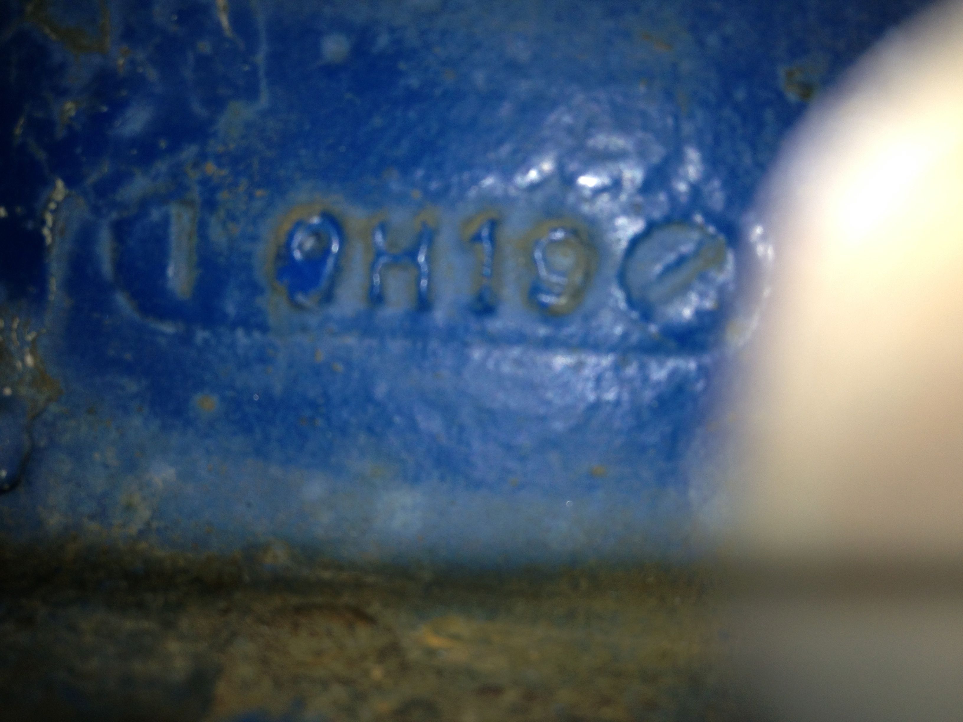

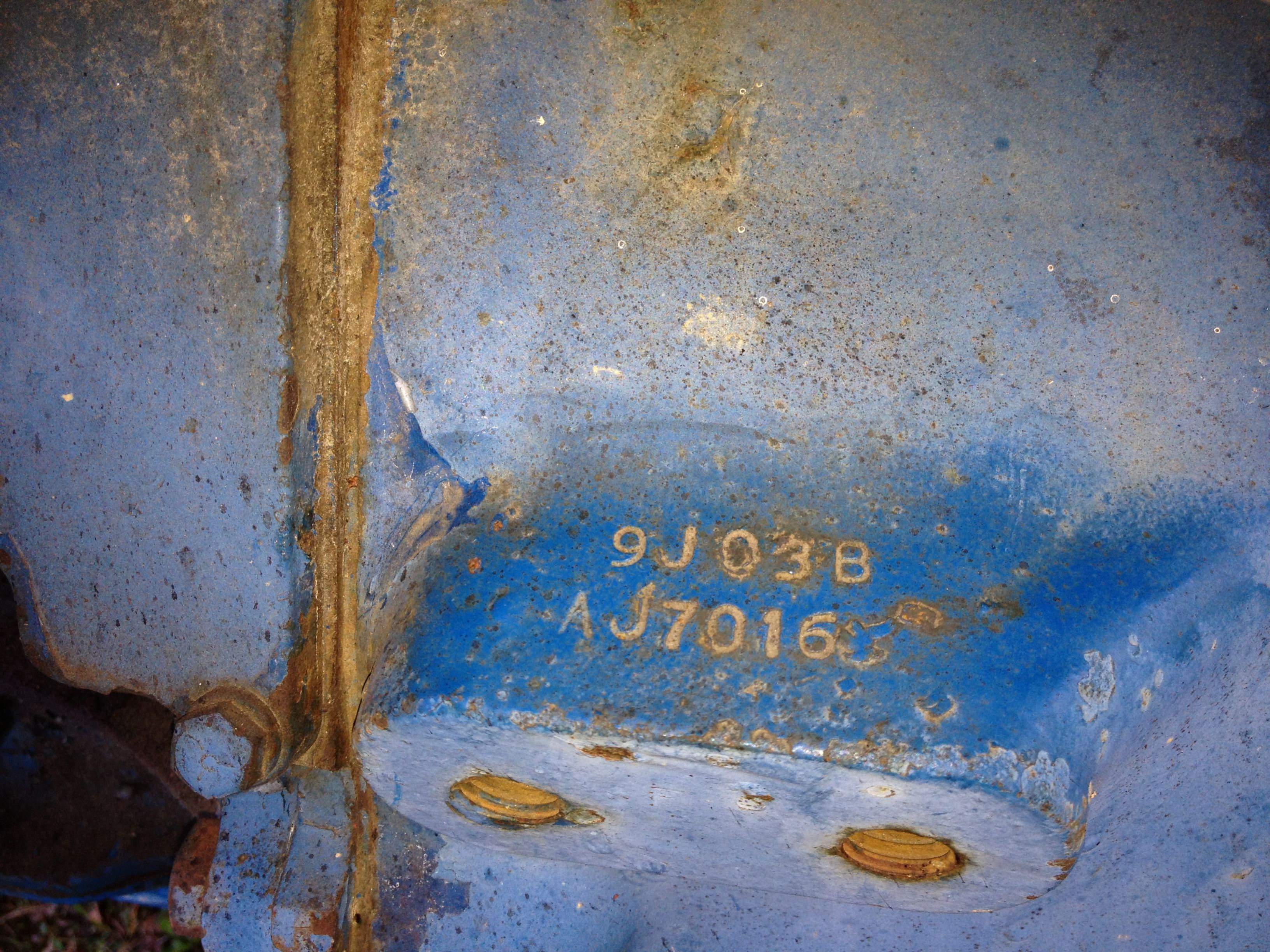

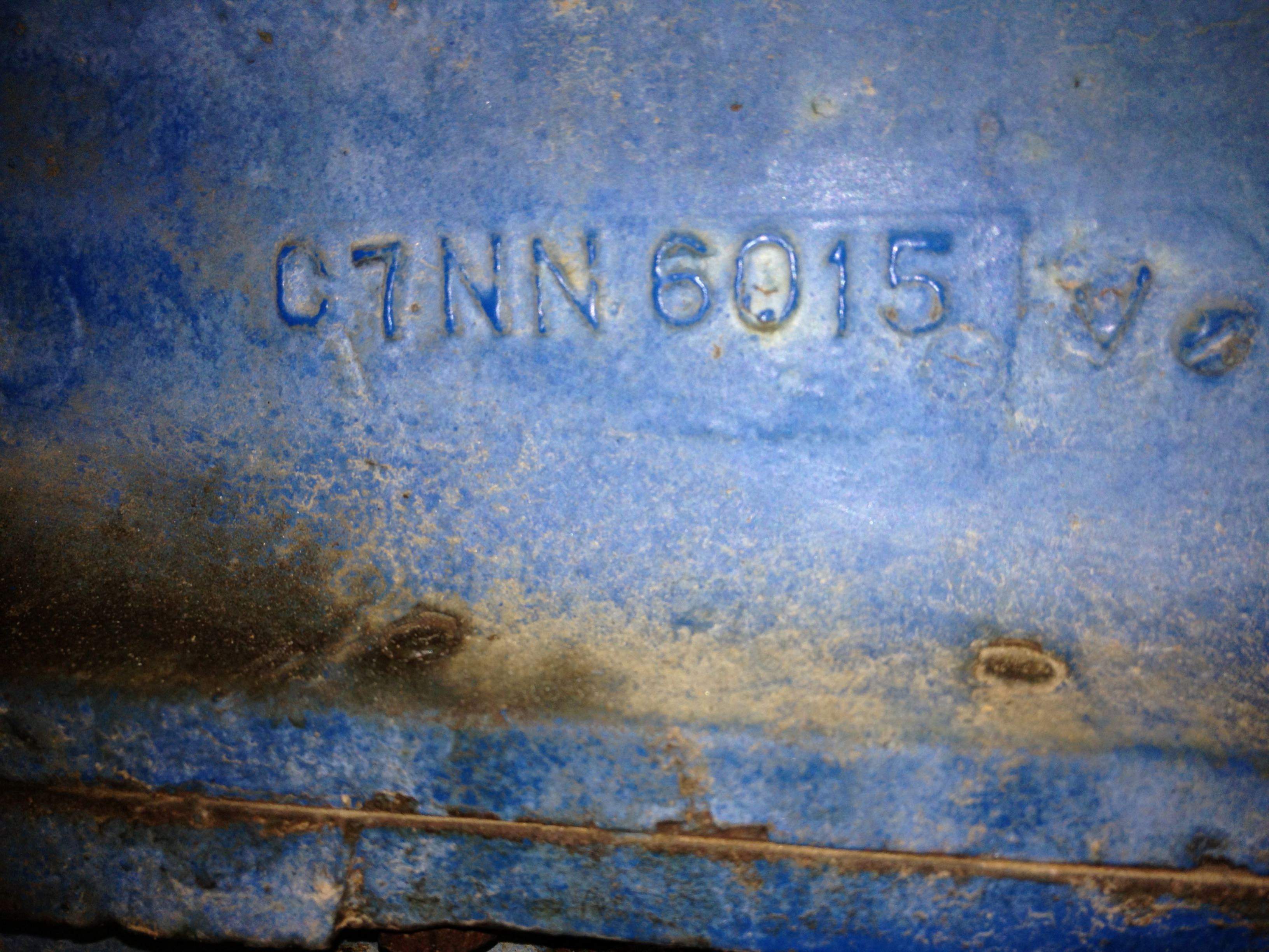

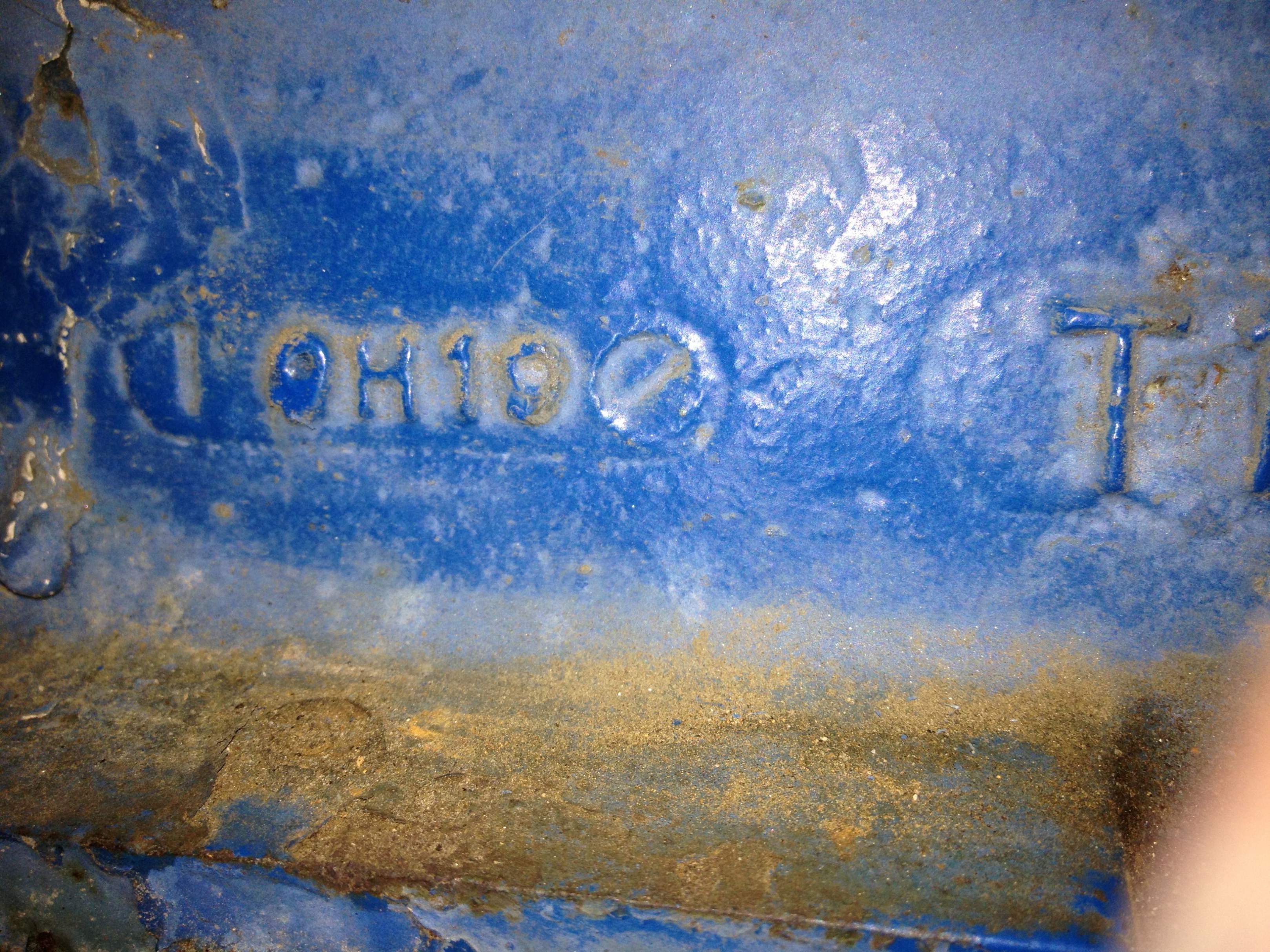

I ahve tried to find the info on the tractor to identfy the year and other info. I have looked around the started and did not see anything. The photos attached are what I did find. Any other ideas? It is a gas model.

One of those # is a build date of sept 03, 1969 on day shift.
The c7nn6015 is the part # of the block.
You don't seem to have listed the model code. This may help FORD CODES and SERIAL NUMBERS

don't look BY the starter.. look on the bellhousing flat on the same side as the starter, where you found those other stamped numbers.

iay be under 6 layers of paint.. but it left the factory with something on it..
