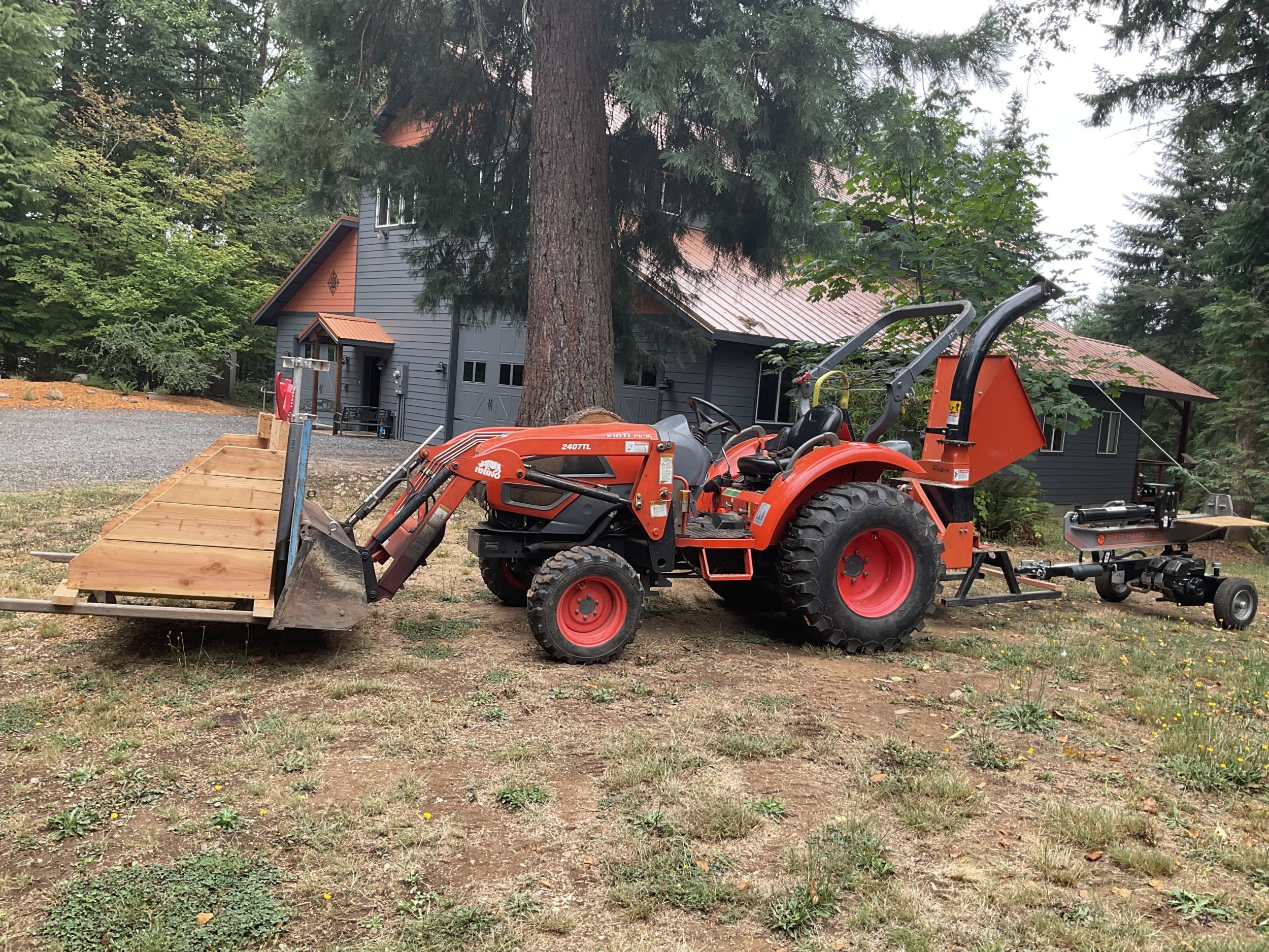

Hi all,
I was wondering what is the norm for letting my Kioti 3 cylinder diesel idle between using and then doing some hand work, say for 5 to 10 minutes. Would you shut it down or let it idle? Thanks as always for the expert advice!👍🏻View attachment 807535
Hey there,
Sorry, I don't have the same model tractor as you do but some things are similar with all diesel tractors...like some others have mentioned, I believe it's better to let it idle in cold weather when the engine is up to operating temp. Long as it's not too long...maybe up to 10 min or so. In hot weather I will still let my tractor run a short while at idle as long as cooling system is working good. Engine temp spikes soon as you turn it off and the cooling shuts down so I'd rather keep those temp spikes to a minimum and keep the cooling system running at idle---long as it's not too long. Be careful to check the cooling gage often when mowing as you could have clogged the radiator screen with grass debris and ole Nellie will overheat. Also starters wear more when overheated.
Now I'm not a fan of Regen on a residential tractor and if you have it on your tractor it can cause you some grief if you idle a lot and build up soot. But you'll have to figure out your own Regen system since they are not all the same. I say idle your tractor as long as you are comfortable with, all this discussion considered. All the best.
