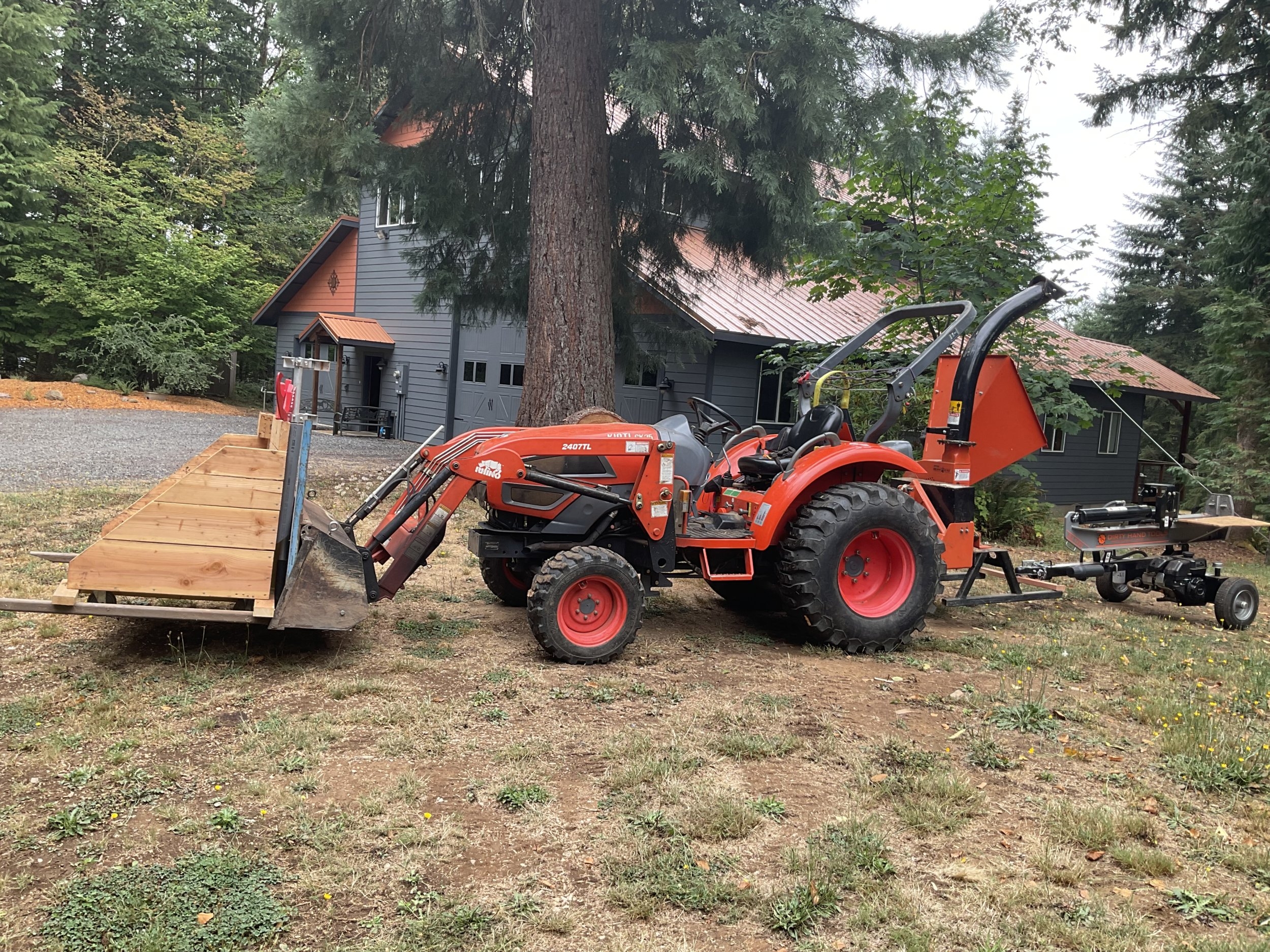

Hi all,
I was wondering what is the norm for letting my Kioti 3 cylinder diesel idle between using and then doing some hand work, say for 5 to 10 minutes. Would you shut it down or let it idle? Thanks as always for the expert advice!👍🏻View attachment 807535
I have a Kubota and letting idle is bsd for it. Mine is set up with the tier four system to burn off exhaust, letting it idle will throw it into a combustion mode. I have to run mine at or over 2000 rpms
/ Tractor idling #42
You show a CK25, if that's correct you do not have regen, idle will not affect yours as it would regen units, I only idle to warm it up when needed for a couple of minutes. Outside of that I shut it down, the regen should not be idled, if I do leave it running it's running at minimum of 1800 rpm

As I said I don't have a DPF, with my use case I was afraid of it. Just the other day I was splitting wood, BIG rounds I needed to move each with the tractor, then it would take a good 5 minutes to split the big round, then I bring a new piece in, So I "use" the tractor for less than 1 minute and the tractor exerted no effort moving the piece of wood, then it sits for 5 minutes. Say I'm splitting wood for 1 hour, giving no weight to fuel usage, Is it better to leave the tractor running, or start the tractor 10 more times in that hour. If it were a DPF tractor would the answer be the same?
/ Tractor idling #46
Without DPFs and regen, I think you’re okay with some idling while working the tractor. Would be kind of inefficient to start it up every few minutes. I assume you are not concerned about fuel economy, so C’est la vie.

Normally I would say let it idle but with a regen system you are loading up the muffler with unburnt particles that will need to be burned off sooner or later by a regen cycle. So anymore than 5 min I would turn her off.
Clearly the other posters here are not considering the regen systems now incorporated into many new tractors. If your tractor has one, know that "scootr's" advice is sound and you should disregard the others.
So then that is the question... does your tractor have this kind of emmision contol system or not?

We use our tractor about the same. It's a 2007 Kubota without DPF. About 1200 hours. Doing some firewood work yesterday we use the backhoe - at idle - to pick up tree trucks and hold them at waist level for cutting into rounds. It idles efficiently without smoke or smell. Pretty much typical of any pre DPF type.
So yesterday's use was half throttle to drive a mile to the wood lot, idle for a few hours continuously while working the backhoe, followed by 10 minutes at half throttle to get back to the woodshed with the bucket full of rounds. Once there, we turned the tractor off to enjoy the silence while stacking wood. Then everyone clambers aboard to ride the mile back home. Nice afternoon.
Sure it does idle a lot, but it is built to do that. Idling doesn't mean it burns fuel any more or less efficiently when idling than at full throttle - it simply uses less fuel and air to idle.
Almost 20 years, 1200 hours, worked hard & idled lots, no problems and little or no obvious wear. My guess is that idling an old style engine is not a problem. I can't see any reason why it would need repairs in the next 20 years. New tires and battery would be my expectations.

Apparently some diesels (Cummins in pickups, for example) regens based on time, no matter what the circumstances are. Sounds like your tractor is doing the same thing.
/ Tractor idling #57
What he says bears repeating. Us oldtimers can forget that there are now so many new tractor owners who are not aware of diesel engine history. It has been heavily impacted by emissions regulations.
Diesel engine design took a major change about 2012 to 2014. Before then, tractors were commonly idled a often and for long periods. They were made to do so. They ran very lean at clean at idle and idling them was common.
After that date the EPA mandated that all diesels over 25hp had to meet higher standards for soot particles. Most did that with Diesel Particle Filters (DPF) that require higher throttle use and regeneration.
Bottom line is that many older diesels idle OK because they were deliberately designed to do so.
Newer ones are not made to idle for long periods. It is as simple as DPF or not.
