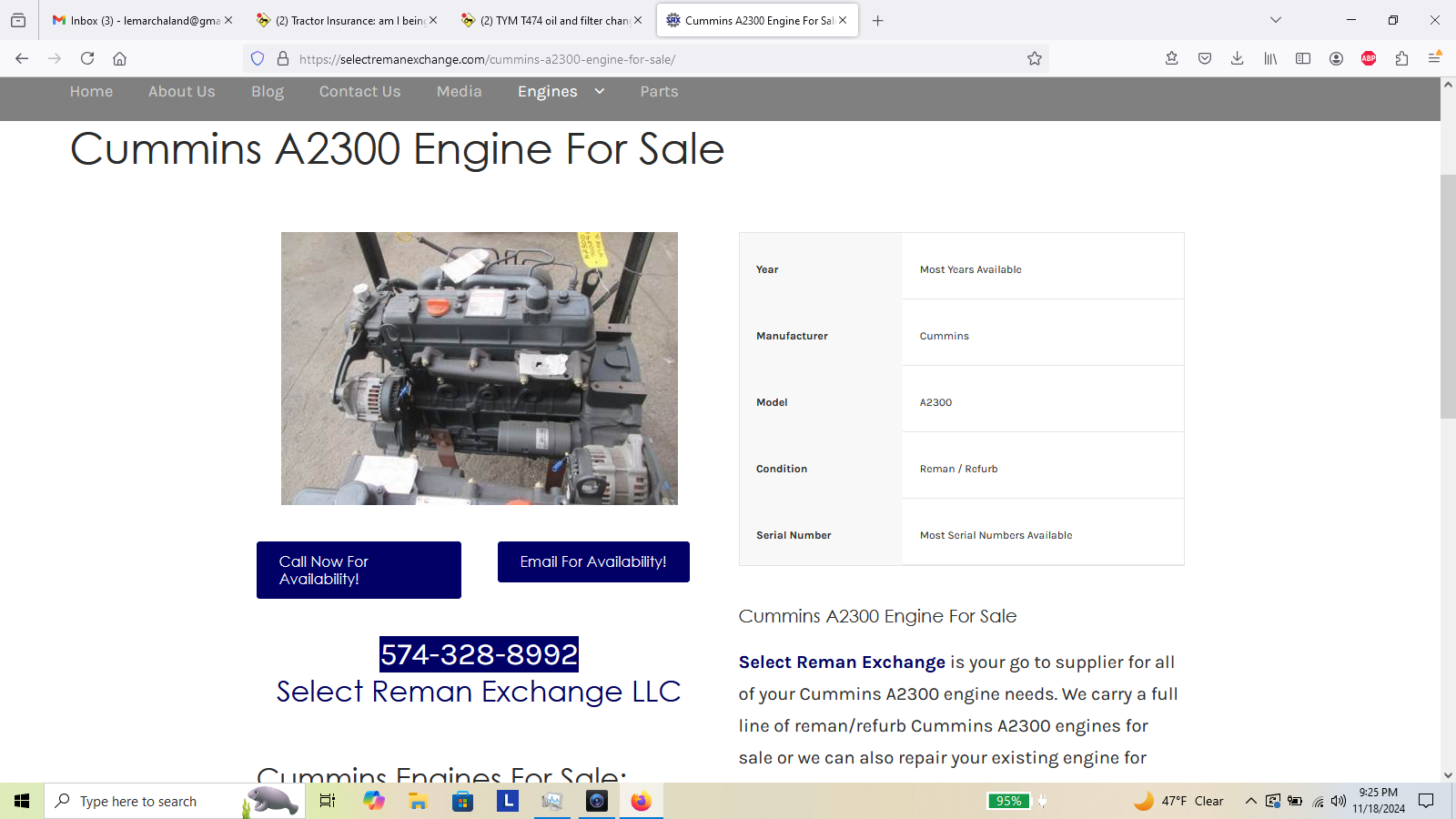

There is a chance that all that needs to be done is the injectors pulled and the engine turned over a few times to get the Water out. I know this because I had 6.9 hydraulock after the engine had been shut down and then filled with anti-freeze from a blown intake gasket.
If the motor was actually running, then maybe a bent rod or? Look for a mobile mechanic.
You should be able to get this fixed without loosing your shirt.
One of the issues is that most everyone's mind set is to replace, not many want to repair anything anymore. 😞
MVR
I pulled the glow plugs and tried to turn the engine with cheater bar.. no go..
Had it moved to the dealer. He basically did the same thing and recommended a new engine. The damage may have been minimal but he did not want to do it.

Were it my tractor,and the block has no obvious damage, I'd tell the ins. co. to cancel my damage claim_period. Then I'd begin calling mobile mechanics for an in-frame overhaul
My nephew just performed an in-frame overhaul on my MF 135 perkins engine with cylinders full of anti-freeze.
All new bearings, new cyl. liners, head resurfaced, all new gaskets, etc.
He has approx, $1,800 in parts plus his labor.
Even if you must replace rods and pistons, that's probably about another $800.
The mechanic doesn't have to know your specific engine, just have a shop repair manual ready for him when he arrives.

Is your tractor the TYM 474?
If so that seems to a Kukje A2300N2 engine. Which is the supposedly Cummins Onan engine.
