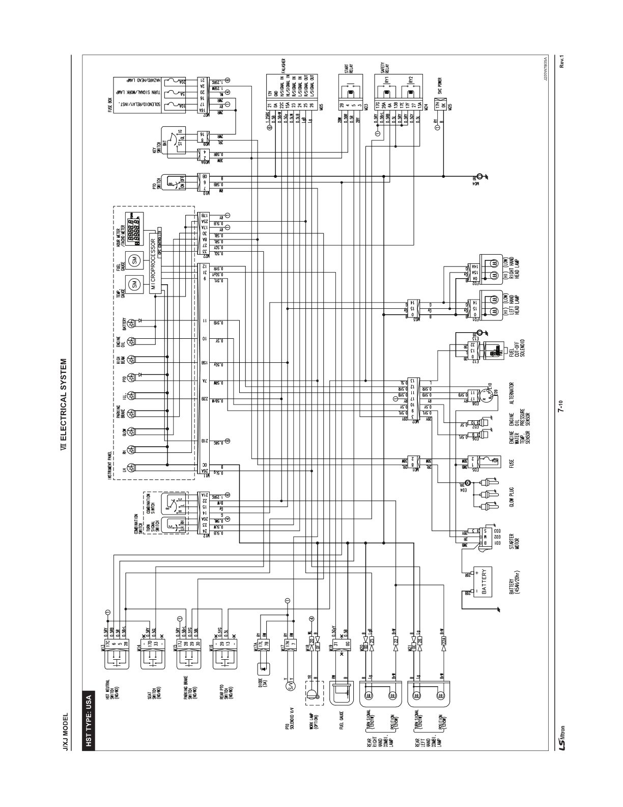

A schematic for this machine would be helpful.

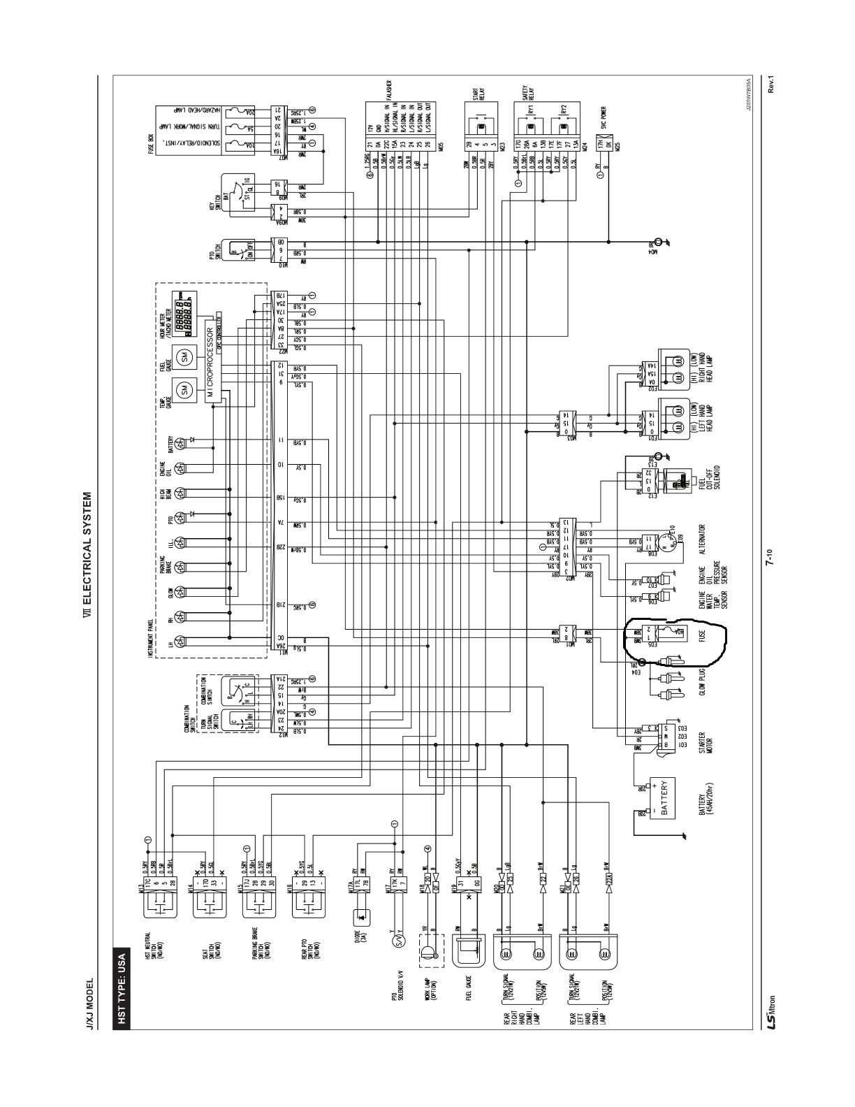

I know that the battery is new, but that doesn't mean that it is good. Having it load tested is a good place to start.
   / Tractor is dead...help #18
Look for this guy under the hood, trace from there. He'll likely be hanging in a capsule on a wire vs near the fuse panel, connects the battery to the alternator and everything else in/on the tractor. If he goes out nothing works. Work back from the alternator if location isn't obvious.
