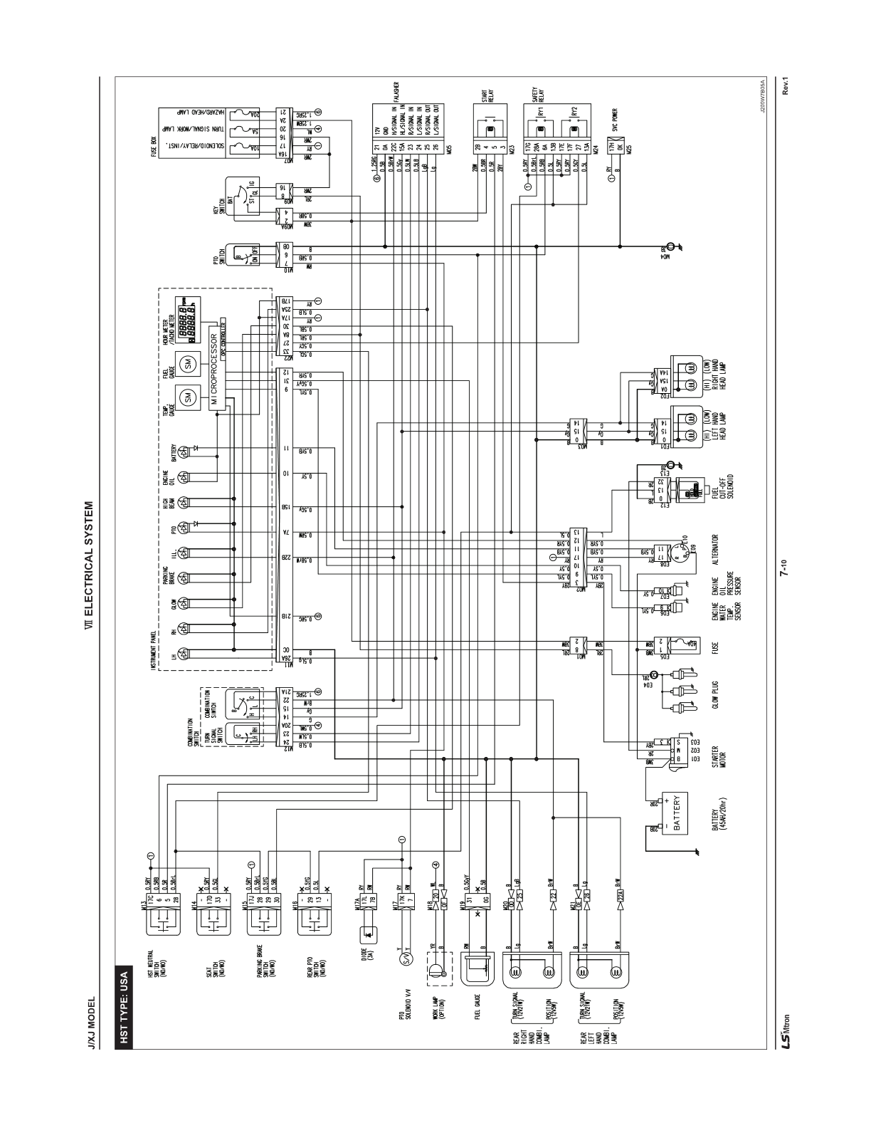

2014 new holland boomer 24
I have a 2014 new holland boomer 24. When I go to start tractor there is nothing....no lights, no clicking, nothing. Tractor is completely dead. I have bought a new ignition switch and replaced the battery. The wiring harness has juice as we tested that. Dont know what else it could be....someone please HELP....I'm desperate to get this tractor going asap as I need it to feed my horses.

We replaced battery as the old battery was old and didnt have enough cold cranking amps in it. We changed the ignition switch because the research we have done lead us to think it was maybe the cause. Fuses are all good and fluid levels are all good. PTO is in off position. I dont see where the seat safety switch is. It ran fine the last time I used it to plow driveway. Parked it and shut it off and hasn't ran since then.
/ Tractor is dead...help #5
the fact that there are no lights, bypasses all safety switch issues. there is a problem with a ground wire most likely. have someone sit in tractor and try to start unit while someone else twists the battery cables. this is how i found my ground cable was causing starting issues on my tractor. if the cables move at all, thats the problem.
also check spot where ground cable bolts to frame. ofter this requires loosening bolt, cleaning everything with sandpaper and retightening bolt.

If a bad ground has been eliminated,
Does this tractor employ a fusible link? generally located near the starter main battery B+ post on starter in the lead going to the Ignition switch on some tractors.
A schematic for this machine would be helpful.

I know that the battery is new, but that doesn't mean that it is good. Having it load tested is a good place to start.

Look for this guy under the hood, trace from there. He'll likely be hanging in a capsule on a wire vs near the fuse panel, connects the battery to the alternator and everything else in/on the tractor. If he goes out nothing works. Work back from the alternator if location isn't obvious.
