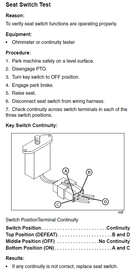

/ Tractor just died #10
Seat switch test from the 990 manual.

/ Tractor just died #12
gee, thats completely different than my JD870 was. youd think that they could keep something as simple as a seat switch the same between tractor types in the same company.
/ Tractor just died #13
Mowing in a field....Test seat switch???? I think it is time to start crawling around underneath the tractor and find the wire that has been pulled loose.
mowing = bouncing on seat...could easily affect the switch. its somewheres to start anyways.
/ Tractor just died #14
Don't know what to tell you. The factory schematics for all x70 (old and new), 790, and 990 show the same double pole switch with four pin connector. The x55 have a single pole switch with three pin connector. What did your tractor have?
