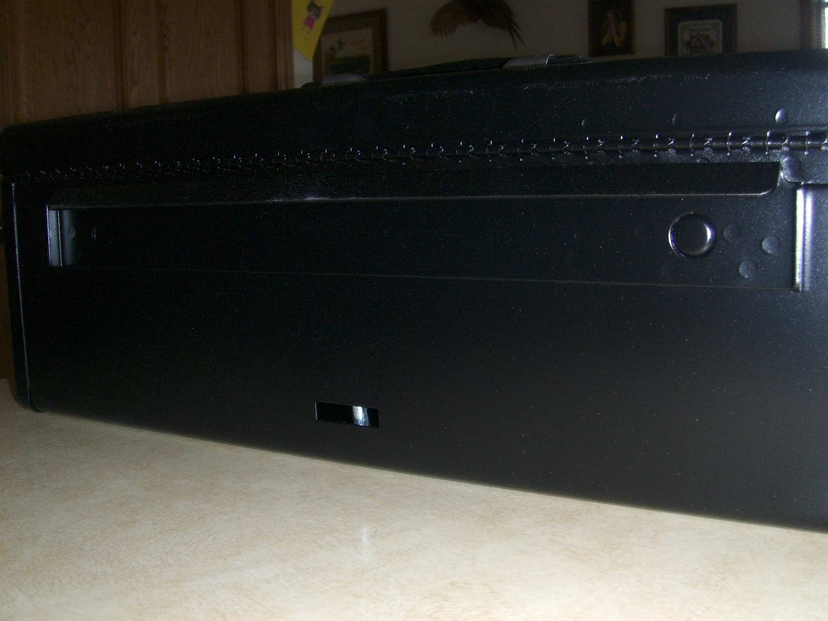

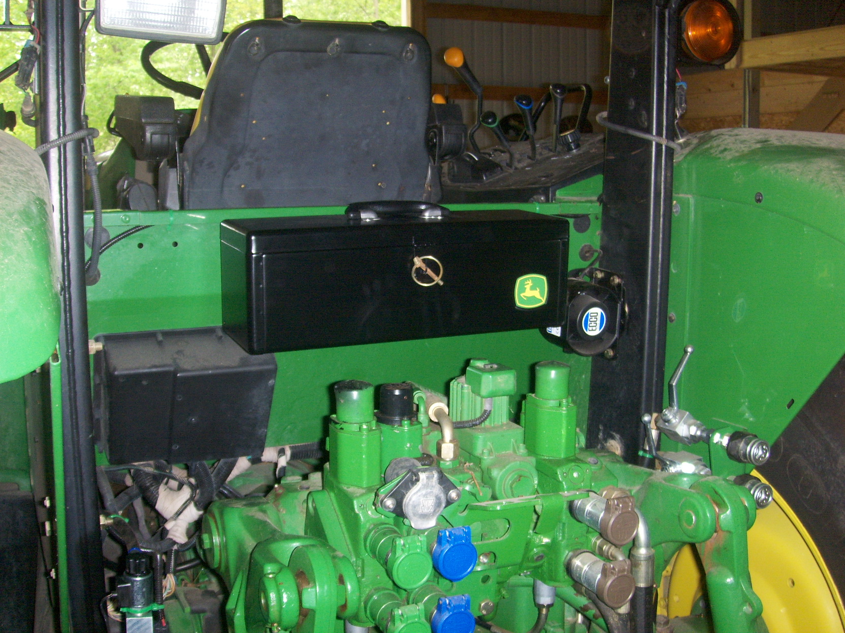

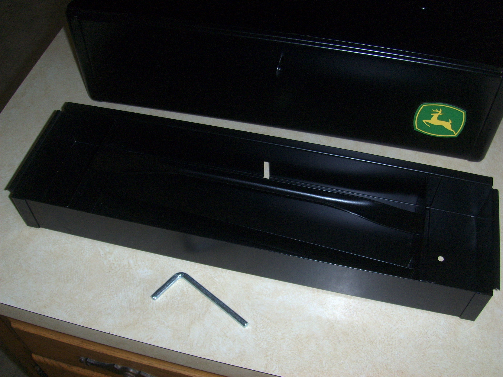

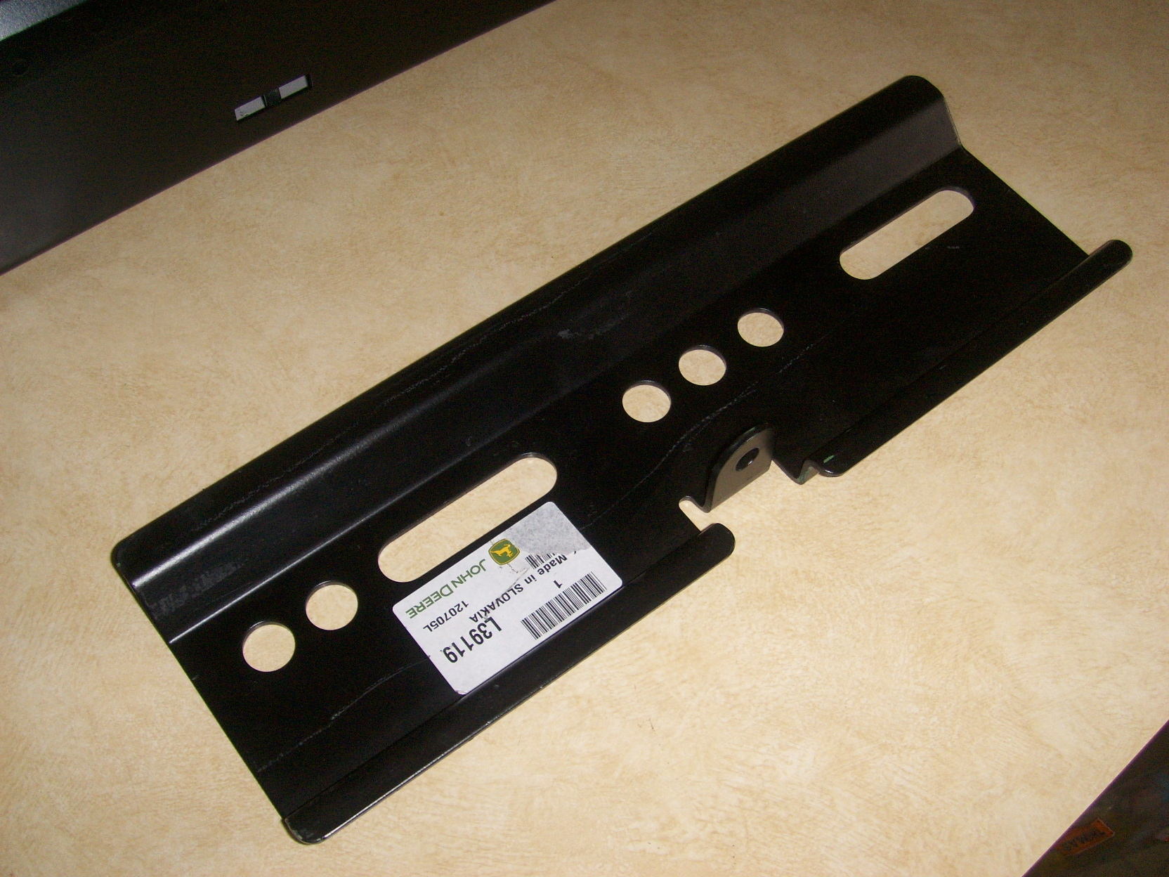

/ tractor mounted tool box #7
I bought the pricey JDS toolbox and mount. The toolbox hangs on the mount and there is a tab on the mount that goes thru a slot in the back of the toolbox. Inside the toolbox you put a pin into the tab to retain the toolbox, then the tray go in to help keep the pin from bouncing out. I bolted the mount across the rear of my tractor

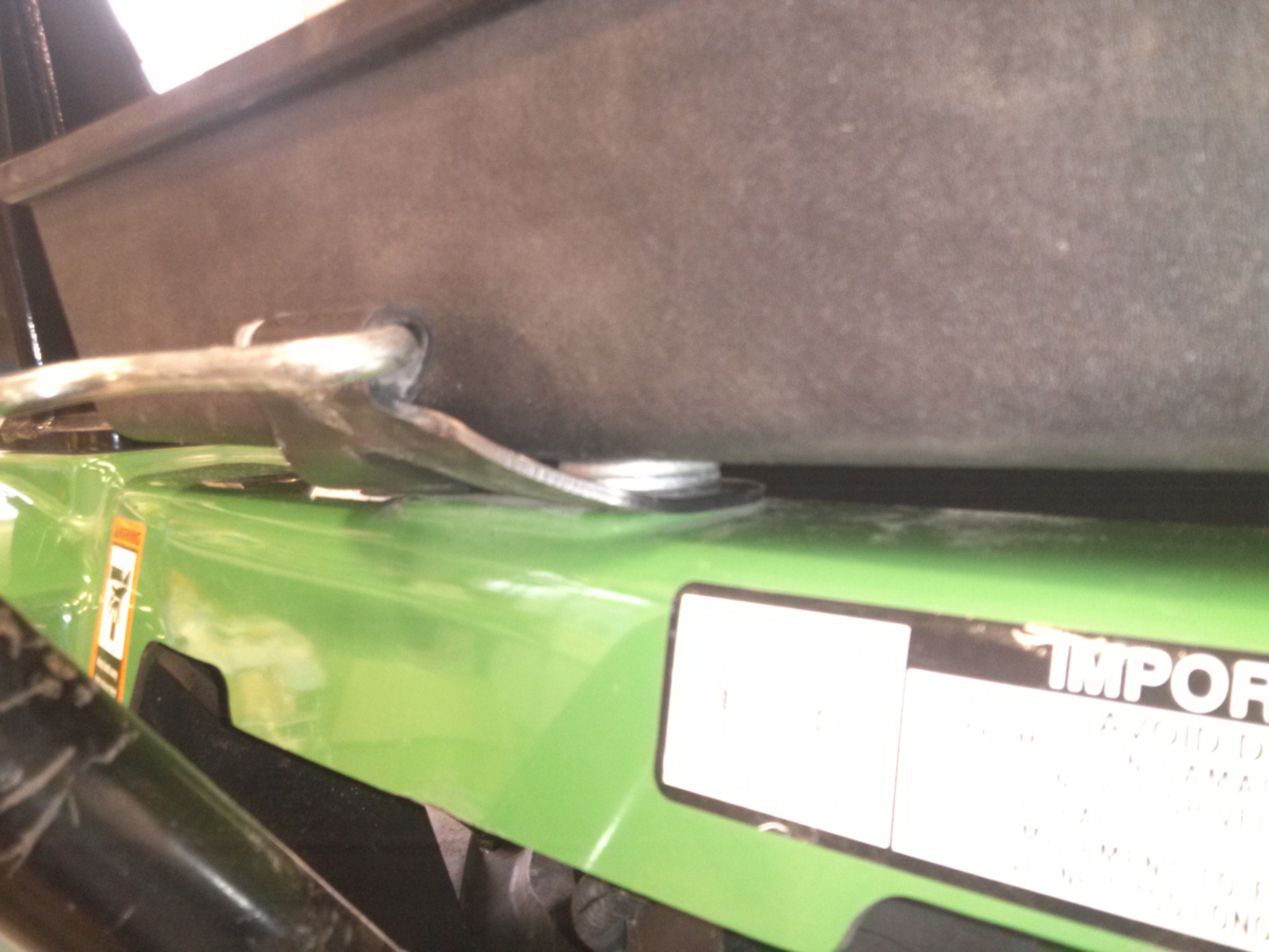

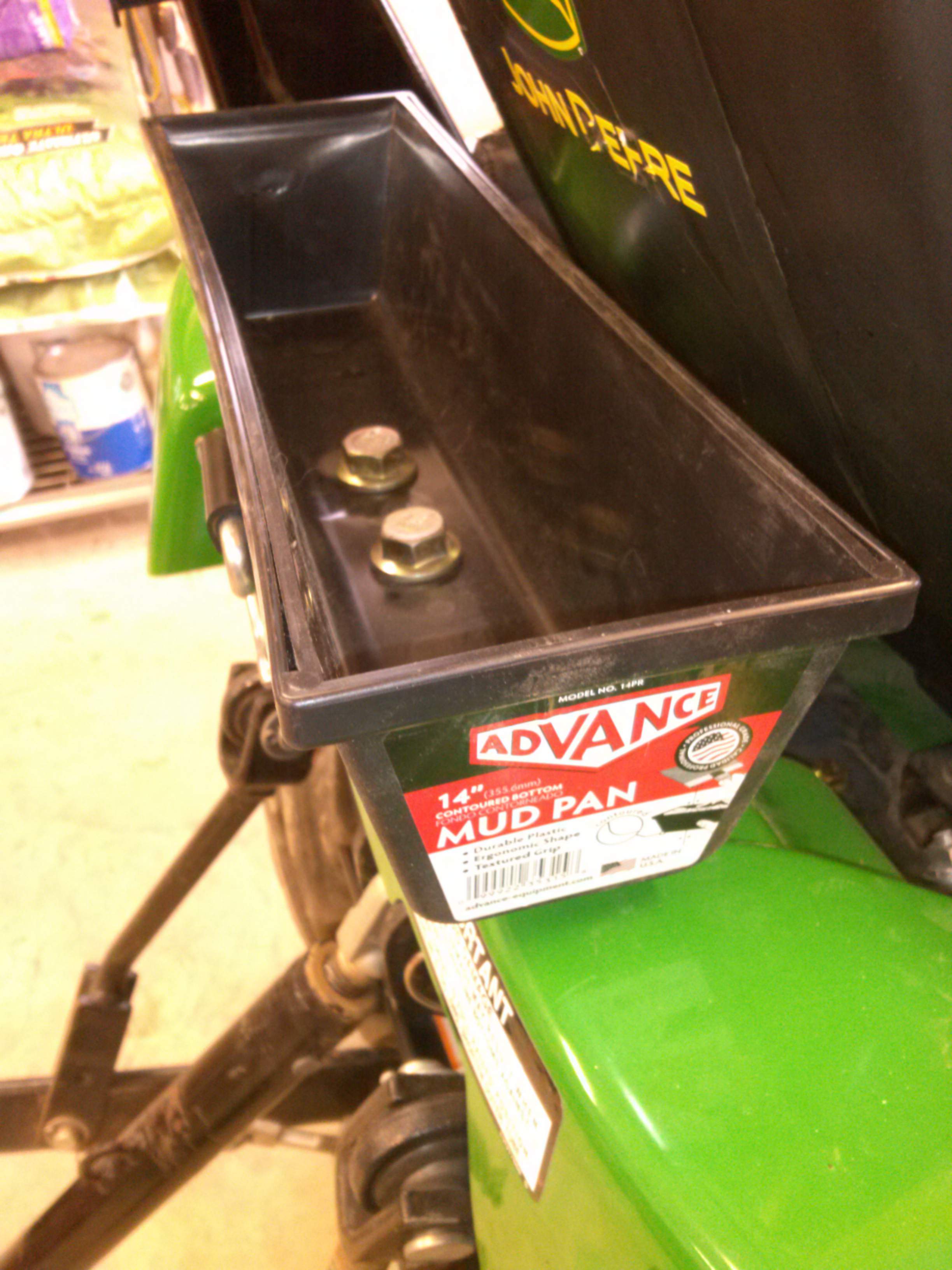

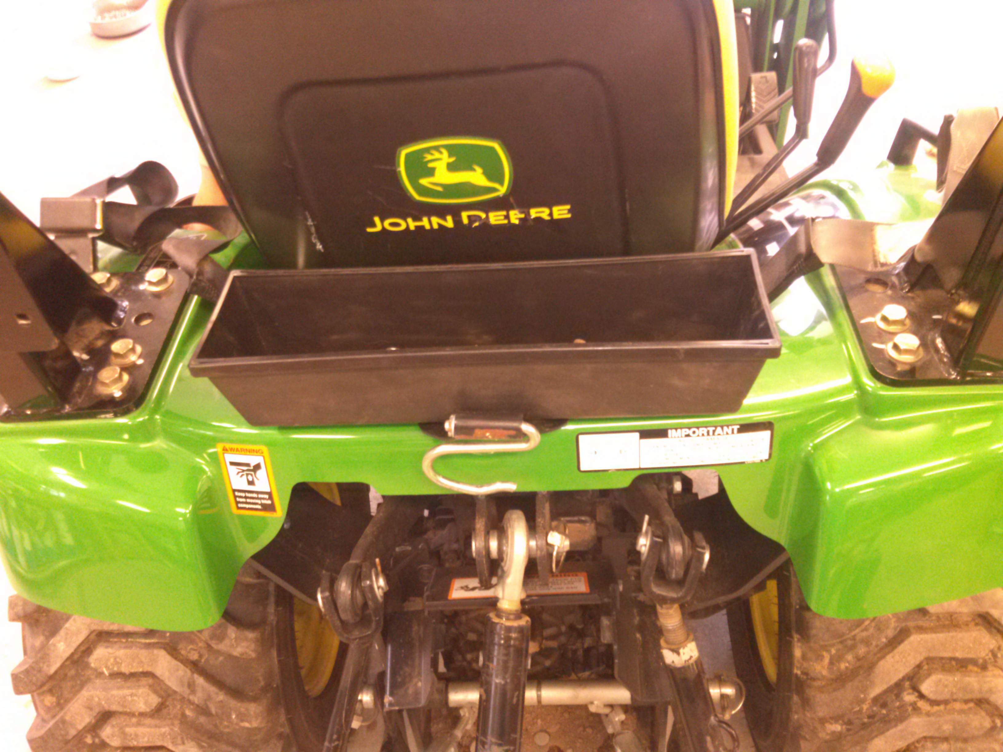

#9
IMG_20131006_165756.jpg here's what I come up with, I was messing around the shop and found this unused mud pan. Drilled a couple of 5/8 holes thru the bottom. I used the same bolts that hold the 3rd member holder bracket, that was the hardest part getting them things out, added a couple of washer underneath the pan and reattached. We'll see how it goes, I just needed something to store extra lynch pins and bolts etc.IMG_20131006_170134.jpgIMG_20131006_165705.jpg. There's not much room behind the seat or anywhere else on this small tractor.
Thanks for all the ideas

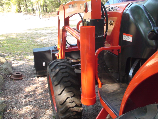

Excellent point. Proper storage and use for any item.
This is my chain storage:
This is my hand tool storage:

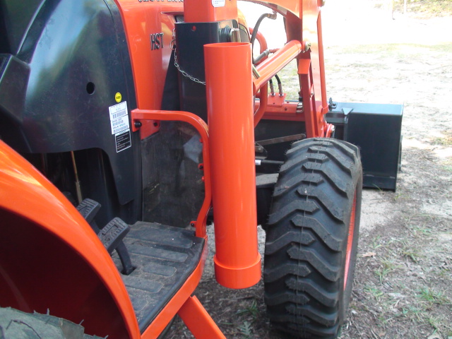

RE your chain storage: What size (diameter and length) and what size chain(s) will it hold? I am looking to carry 5/16" x 20'
Thanks
ZebraFive: Mine are 4" PVC with a 1/2" hole drilled in the bottom for any water drainage requirements. They are 24" long without the end cap installed and are attached to the tractor using 2 each, 5/16" bolts. I currently have a 5/16" chain, 10' long in each and it takes up ~ 40% of the space. I just did a space-test using 14' of 3/8" chain and it took about 60% of space. My original goal was to make them about 32" deep, but my arms will not comfortably reach to the bottom of that and reduced the length to 24".
These are also handy for carrying long handles tools such as shovels that do not have the D-handle, which is larger than the PVC pipe. I think that 6" PVC may be required for the D-handle tools but this diameter would be too large for my mounting options. I can place both chains into one side and use the other side for a bunch of tools if need be.
