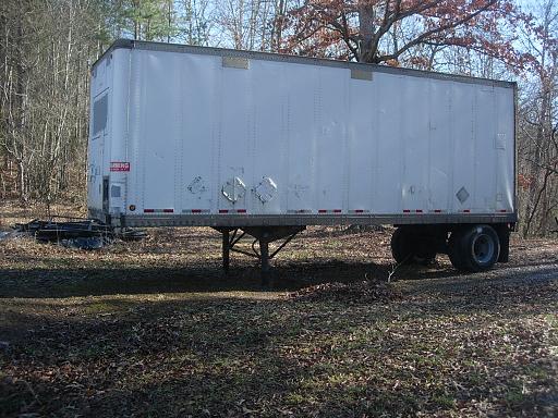

Richard, was it hard to move with the JCB once the brakes were released?
No, it really wasn't. I was in a situation where I was trying to make a 90 degree turn to put it next to a tree (probably a mistake :rolleyes:) and that let the front lip of the trailer want to slip out of my bucket (8' bucket)
I just picked it up again and carried on.
I was also in goopy mud which didn't help anything. If it was dry at the time, had I been able to lash the ... what ever they call the hitch pin (?) of the trailer to the backhoe, it would have made it easier but it was no real challange as it was...and this is something I've never done before.

I was speed reading this thread and if someone has already mentioned this then please ignore.
We had a trailer on a job site that was used for materials that had to be moved.
When the bobtail came in to hookup, he could not get any traction when he hit the sugar sand, we had a forklift on site, the type with tractor type tires.
We brought the forks in close together and chained to pin on trailer. The trailer was a 48' best I remember and still had approx. 6000lbs material inside.
This was ford forklift about mid sized and handled the trailer very easily, don't know if you have a rental center near you, but it's just another thought.

Hey Damifino, I never thought of that. My other neighbor has a HUGE skid steer - the biggest one CASE makes. Brilliant. All the power I need, easy in, easy out.
Richard, your trailer is a lot lighter than the ones I've got. Single axle, looks a lot shorter and metal post and panel sides not fiberglass. Good tips though but I think mine will be too heavy.

Run a chain from the bucket around the kingpin & back & cinch it w/ a binder. Maybe lay an old tire or two in the bucket first.
