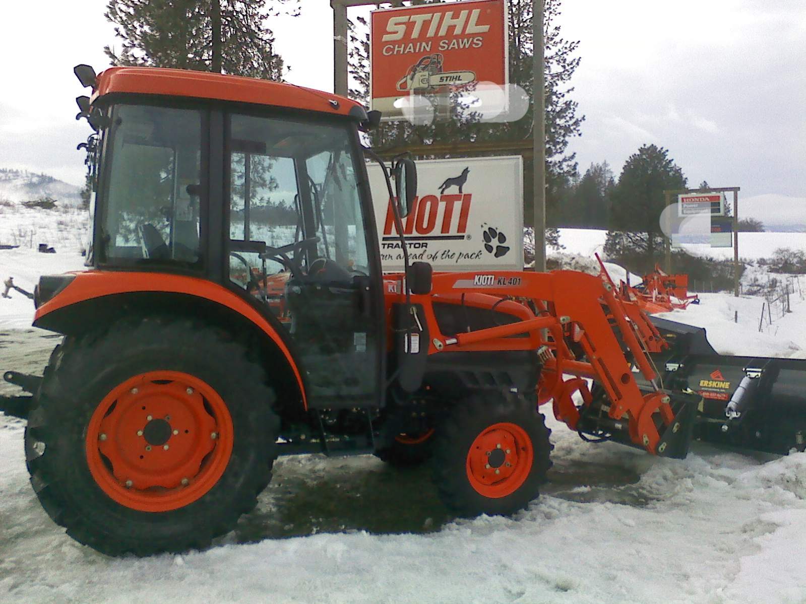

hmmmm. this post just gets me more and more confused what i need for my new tractor......the more i study the more confused i get. I have a new Kioti DK45SE HST CAB tractor and plan on taking care of between 5-10 miles of gravel roads next year. (will start with 5 and see what happens). It all flat and located in north Idaho. we get roughly 110" of snow a year. usually 4-6 inches at a time, but 2 years ago we got 36" over night. its usually semi dry to wet snow. Currently i take care of my 30 acres with my old JD870 and 60" rear snowblower. Ill be getting either a rear push or a rear pull style 84" snowblower for the new tractor (havnt decided yet) and im thinking of getting a front 84" snow blade. Since the tractor tops out at 16 MPH, i don't see the blade throwing the snow very far. But ive watched some youtube videos of front mounted snowblowers in operation, and they seem to be going real slow. so if i were to spend the $$$$$$ for a loader mounted front blower....doing 5-10 miles of roads....it would take a LONG time to blow them, or so it seams. has anyone used a front mount 84" or so snowblower in this forum to tell me how fast you can travel (on average). and can a front blade move snow at a better rate????. Im afraid of what a rear pull snowblower would do in a heavier snow. i wish i had lots of $$$$$,. then i would buy all and use them as necessary. oh....as son as the new tractor arrives (2-3 days) ill post some pics.....so far al i have is one from the lot, with ag tires on it. their switching those for r4 tires.
I think a tractor is the wrong thing for that much road. You need a dump truck or at the very least a SRW diesel pickup.
I run a 7.5' snow plow on the front of my tractor and its 10 times faster than a blower for snows less than 12". The key is to keep up with it.

I agree, but it doesnt HAVE to be a diesel. A gasser would do just fine.

im only concerned that id wreck my truck. everyone i know that plows with a truck is repairing the transmission all the time. id hate to wreck my truck. but i understand what your saying. thank you
