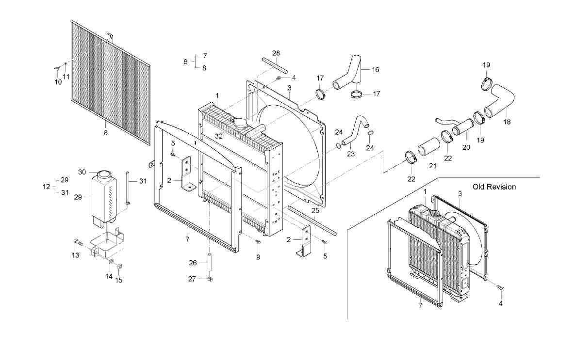

I found the problem. Not sure why it over heated but the plastic housing - top of rad - that connects to the rad hose is cracked.
Will call my dealer.
Wallace - can you order separate parts or do I need a new rad?
Thanks Lloyd
/ Tractor Over Heated #7
It is the whole thing

The top is cracked - no pieces missing.
I am assuming this is under warranty. Something failed causing the tractor to overheat and cracking the rad. What I don't understand is why it would crack. Is there not an over flow pressure release somewhere?
The tractor has 416 hours and they just completed a service about 3 weeks ago.
Up to now it has been working flawlessly for the most part. There is still 2 years left on the warranty.
