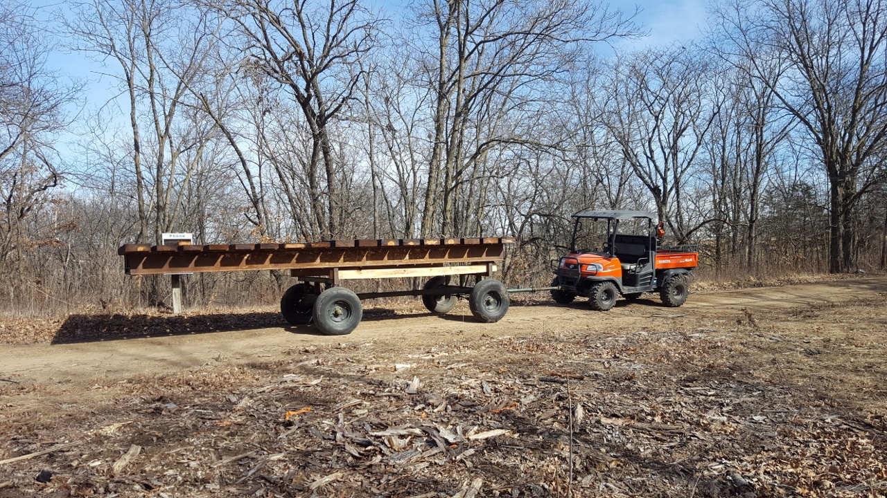

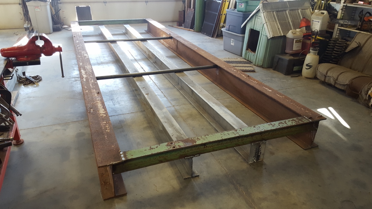

I built a 20' long bridge last year. I've crossed it several times with my 7K lb Super Duty. I haven't had my 11K Kubota on it. Yet.
I used steel I-beams. Sorry I can't help you with your wood beam construction. Something about that just unnerves me.

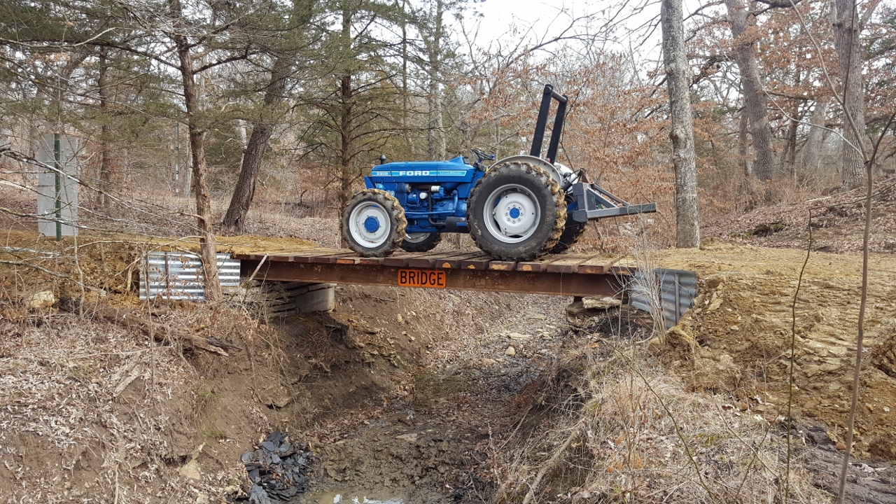

All you need to do is find a beat up 20' equipment type trailer or a truck bed. They can be had for much less than buying steel and building it. If there is any danger of abutment wash out, I would use those concrete 'pigs' that most concrete company's sell, they are 2'x2'x6' long and here they are $50 ea. So dig down a bit, lay some gravel if needed, then two pigs end to end on each side of the creek. Then winch the trailer bed across & set it on the pig abutments, then remove the tires or axles.....done.
I did one out of a 20' steel truck bed, and we just had a nice flood(as usual during winter) and the bridge stayed high and dry). I'll snap some pictures late today for you.
Hey OVRSZD....excellent job or your bridge:thumbsup:
