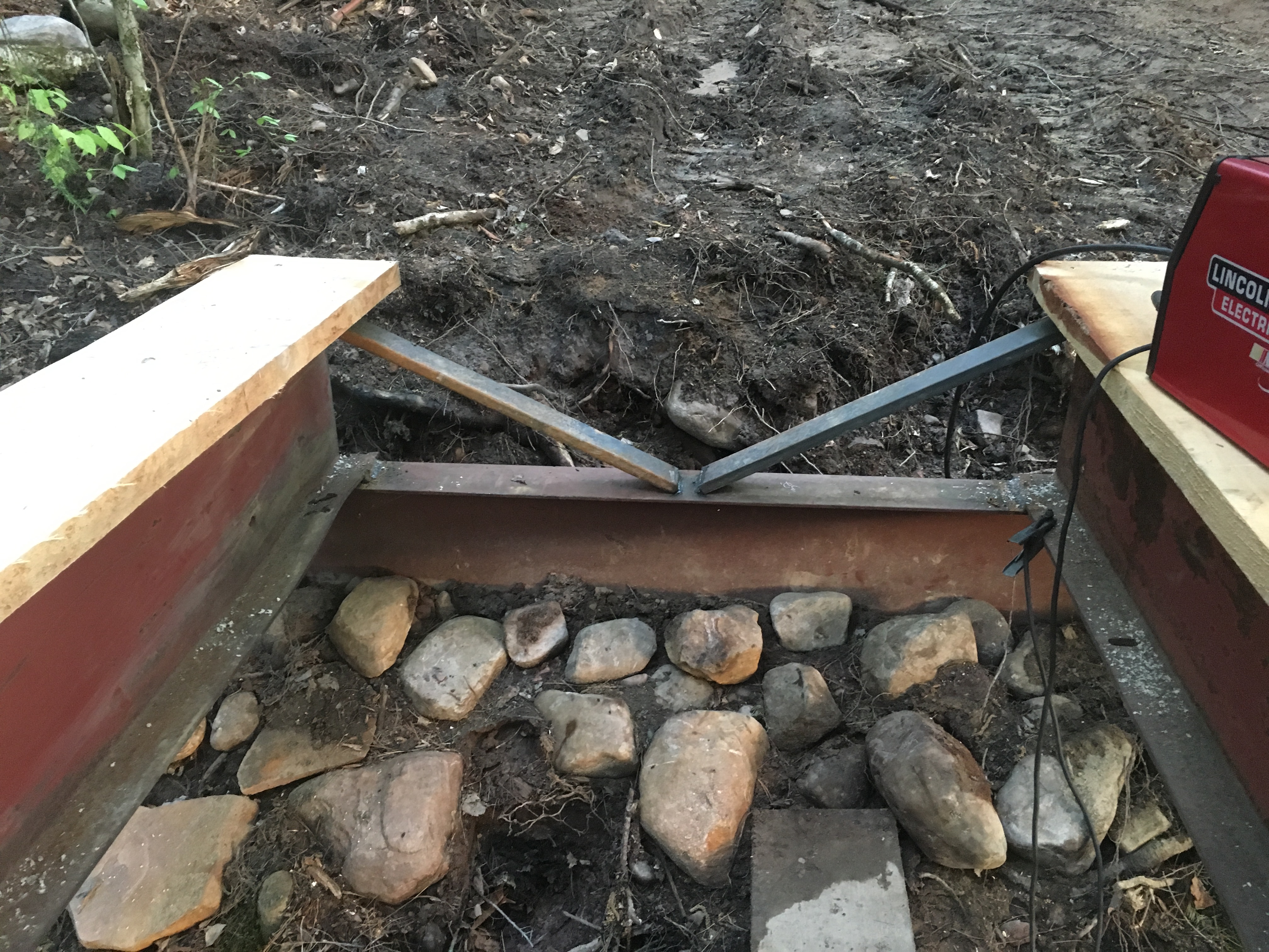

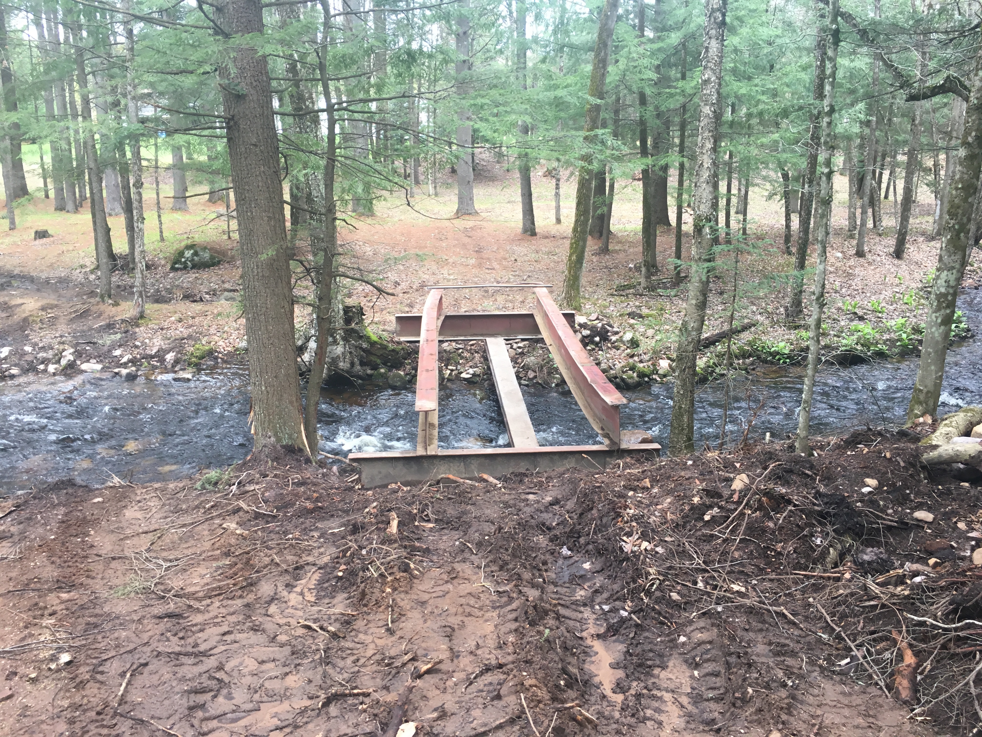

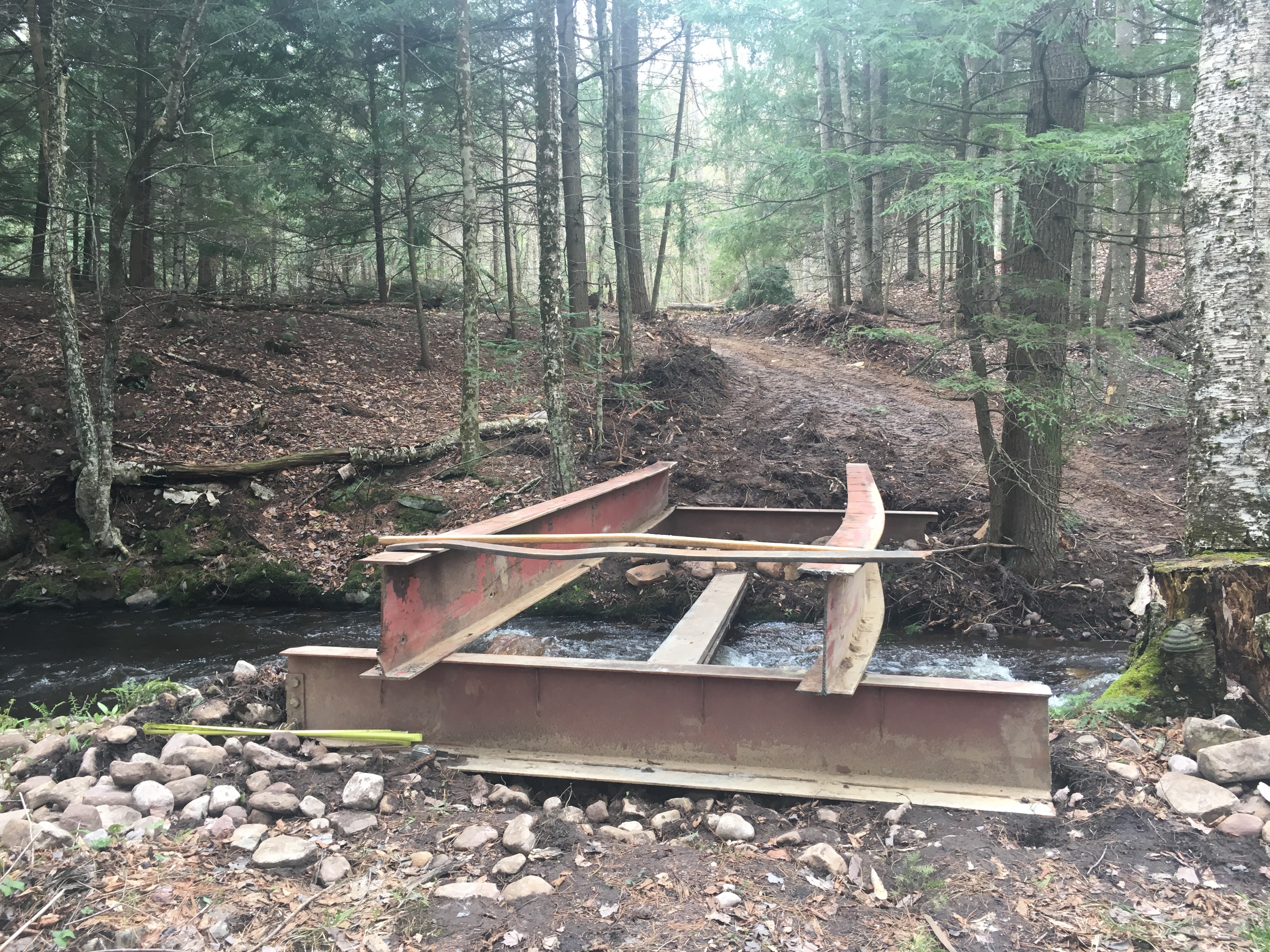

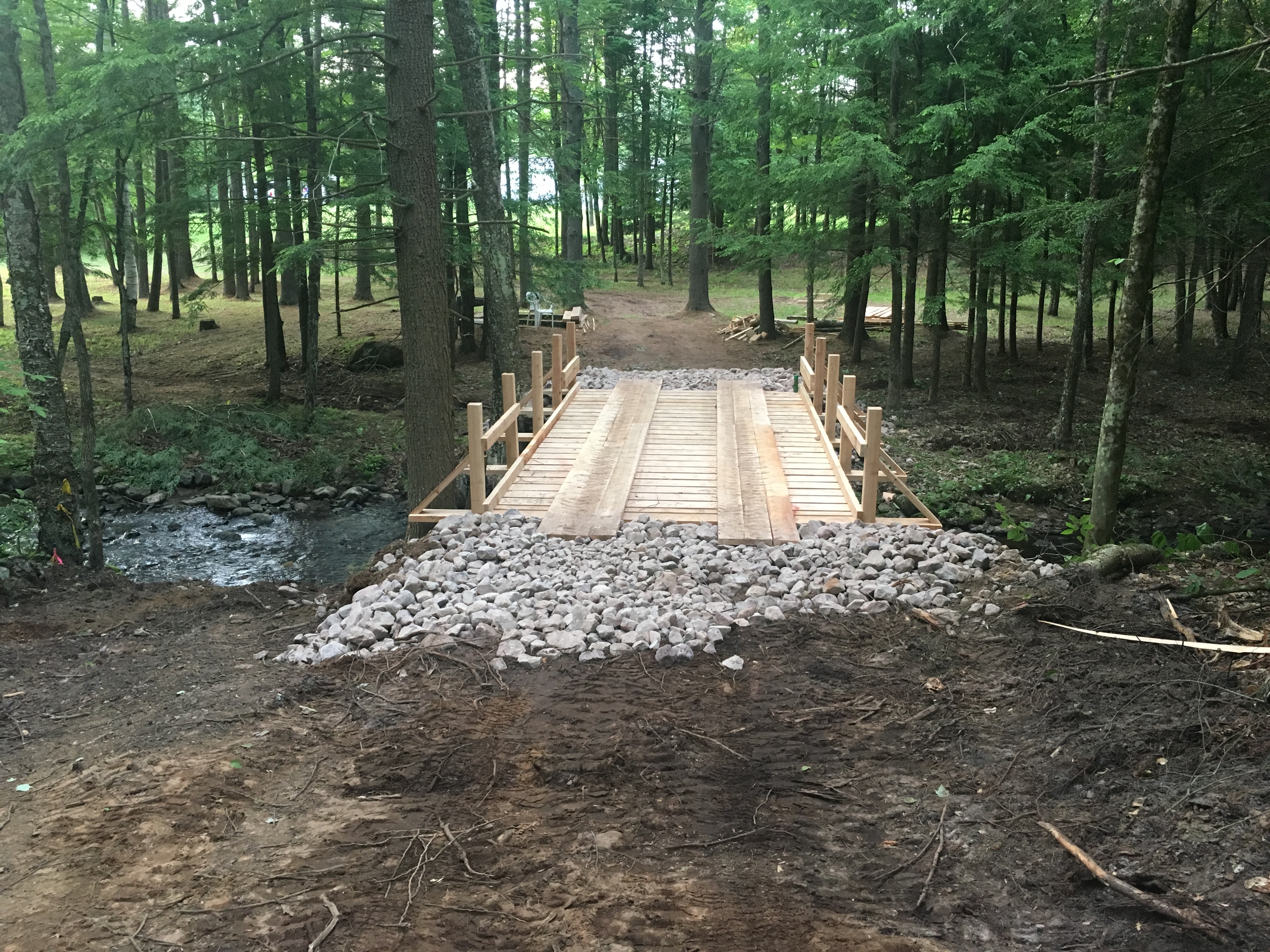

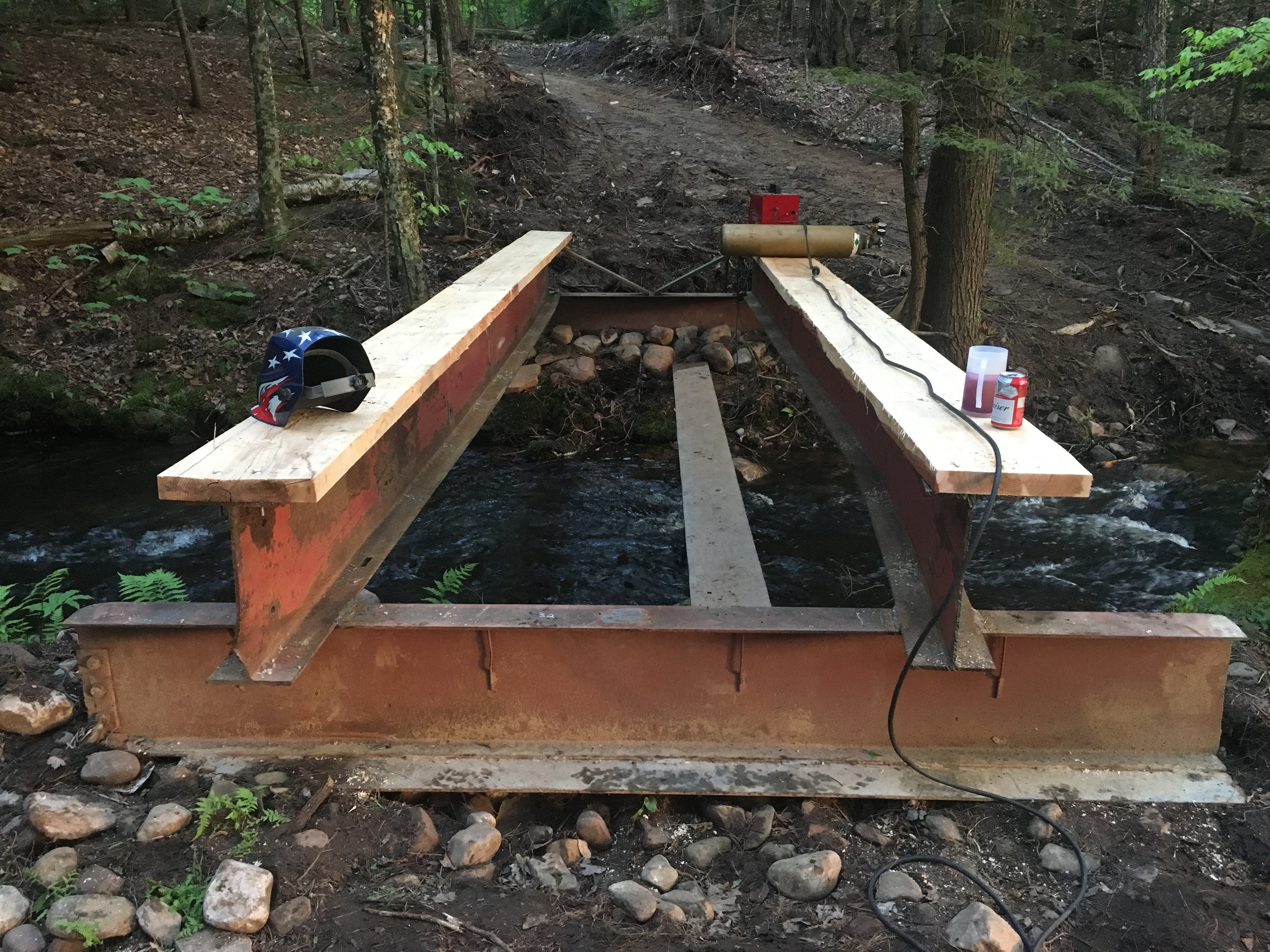

Built this last summer, 20 I beams salvaged from a 40 washed out bridge.
Saw miller lumber from our land and saw mill.
Drive the new holland across it all the time, have had the pick up on it also.
Buried the support beams in cobble stones, and made the ramp out of cobbles also with 2 minus on top.
Your bridge looks absolutely GREAT !!!
Were you able to get any real penetration with the little Lincoln 130V welder?
/ Tractor over trail Bridge? #43
Were you able to get any real penetration with the little Lincoln 120V welder?
/ Tractor over trail Bridge? #44
I actually stick welded it all first, then cleaned it and went over it with mig.
Something I was taught in welding school.
Thanks! We love the bridge!
