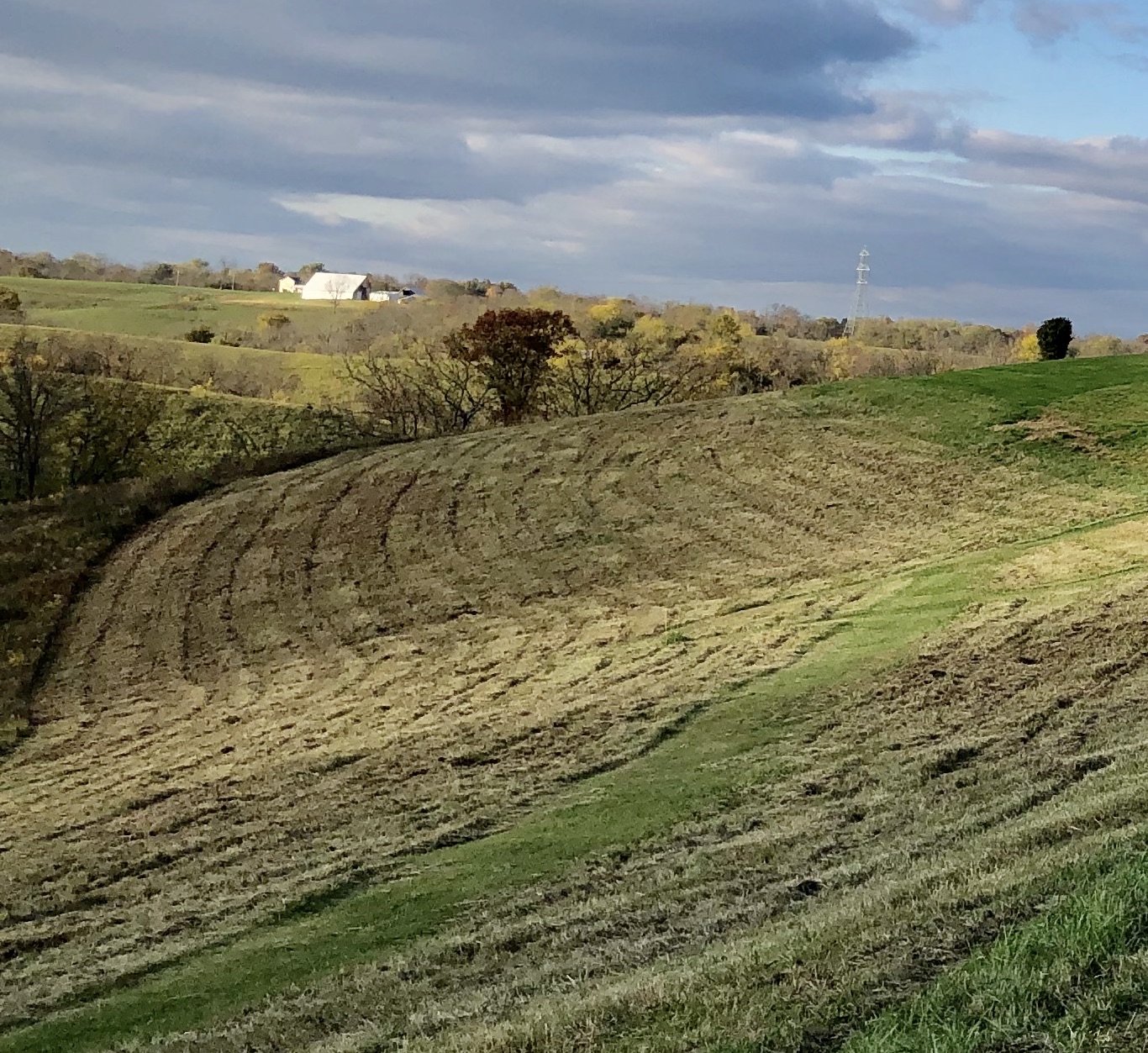

Radj,
Thanks for the swift reply from Texas. Good suggestion. You wrote;
"Insure the rotary cutter is higher in the back and lower in the front by adjusting the deck height, this is to eject the cut material most effectively, otherwise you load up underneath the cutter and over mulch, which simply over works the tractor."
My rotary cutter is already higher in the back - it is set about right - but your suggestion got me thinking about the design of my rotary cutter. This Tartar brand bush hog has a circular-shaped back end that is all metal. It also has a enclosed metal front end. It is therefore enclosed by rigid vertical metal the same height all around the deck - no chains or rubber flaps in back or front like I've seen on other cutters.
I have been setting the height of the bush hog at 4 on the 1-10 scale on the raise/lower lever - about as low as I can set it without the edge of the mower creasing the ground on turns on the hills. The debris from cutting the dense growth makes lines shown in the photo. This photo shows cut areas and lower down uncut growth.
You may have identified my problem. If I raise the mower an inch or two during mowing it may allow the mulch to exit more effectively. I can do this because I'm not going to plow the field, just reset the "meadow" growth for spring.
This week the temperatures dropped so an apples to apples comparison isn't likely this year, plus I'm done with the high growth cutting. My neighbor offered to let me try his 5' rotary cutter and if raising the mower height doesn't do the trick I will try his out. I'll check the things on the list of suggestions and see if any of them apply. I'm feeling more optimistic!
