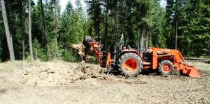

Got half of the poles peeled. Put the forks on the bucket and decked about 400 BF of fir logs (skidding is faster, but this keeps them clean for the sawmill) Then dropped the backblade and 3 point hitch, hooked up the Woods backhoe and spent the rest of the day digging stumps. Got 6 out by 4:30 and decided to call it a day. I will spend the evening on the net researching bandsaw mills. This is going well so far. See attachment

Great looking building site. Looking forward to more pictures as project progresses.
