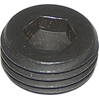

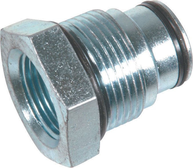

If your valve has PB, you should install a PB sleeve or hex plug and connect the valve in series only, no parrallel anything.
If you did not use the PB outlet when connecting the BH in series, what I said above is true.
What would happen is when you used the 3pt, and maxed it out, causing the relief valve to operate, it does this at tractor max operating pressure. This pressure is felt from the 3pt, back up through the BH valve, loader valve, to the pump.
Most OUT/return ports are limited to about 500 psi.
Read the excerpt from Prince again.
If you want to get rid of most of the back pressure, run the OUT port hose from BH valve directly to tank. The 3pt will not be usable until you put the 3pt back in series with the hyd flow.
Whatever back pressure you have will be working against the fluid flow.
Who set up the BH for you?
Can you show a picture of the BH valve on the OUT port side.
Installing the PB might not help stop the leakage, but PB is the way to connect valves in series.
These are two kinds of PB adapters.
