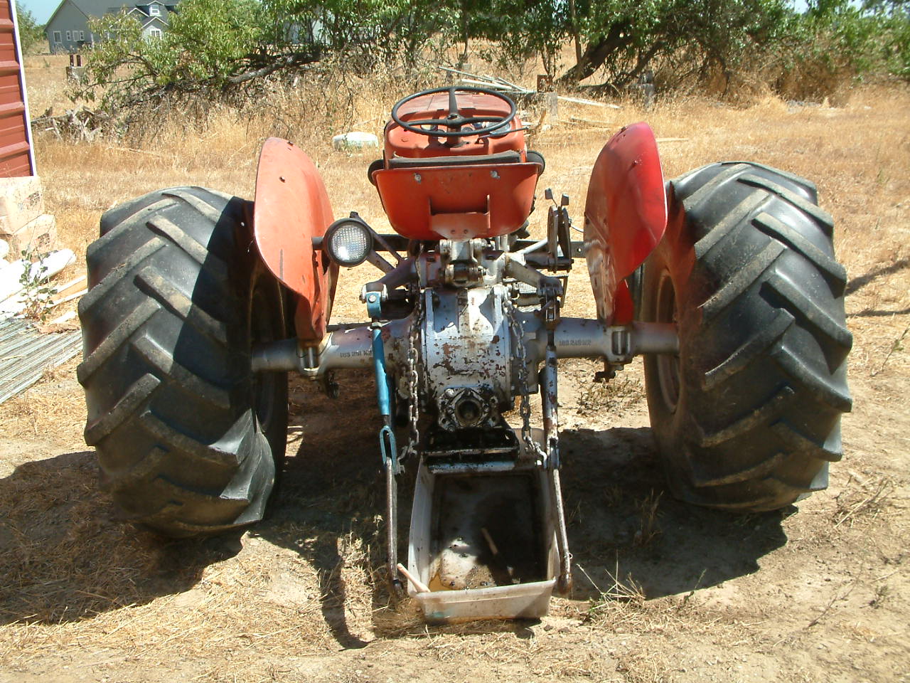

I would be looking for a 40-60hp (pto) tractor with a wide track. I have a used 1966 MF-135 diesel tractor (37hp pto, 45 hp engine) that has water-filled orchard tires on the rear. Track measures 82" wide. You could probably find a new or more recent used tractor with similar features from any of the tractor manufacturers.

flusher--That's some seriously wide Ags you've got on the rears of that MF. I'll bet with those things loaded it would be very stable with low COG. Good thing too with no ROPS.:eek: Be careful out there!
Those are B.F. Goodrich Silvertown 18.4 x 16A Power Grip tube-type orchard tires on 16" rims. Tires are filled 2/3 with water. They're pretty worn so "Power Grip" probably is a misnomer at this point. Probably will have to replace them to get enough traction to pull the 7-ft offset disk that my next-door neighbor dragged over to my place a few weeks ago.
I'm refurbishing the 135 now (gauges, paint, decals, lights, steering wheel, seat, etc). Work is going slow. Don't need the 135 until next Nov when the planting season kicks in around here. So there's no rush on that job. Anyway it's too cold and damp to do a decent spray paint job now.
I'll probably invest the bucks in a ROPS before I do any serious tilling with that beastie. I bought the front weight frame so I'll be looking around for suitcase weights before long. Don't want to do a wheelie with that tractor.
No kidding!! Good idea on the ROPS before doing anything serious. I'm sure that all the people who are killed in tractor rollovers think, "It won't happen to me." Once again, be careful out there.
