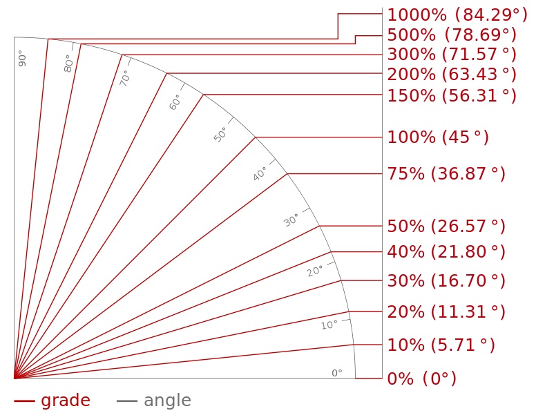

Maybe I didn't phrase the question correctly.
On this graph, which most resembles your slopes?

Don87,
Walking up from the pond up 100'. there is a 20' difference in elevation. Is that slope of 20%?

Don87,
Yes, a 20 foot rise in 100 feet is a 20% grade.

20% is not steep.
/ Tractor Recommendations for slopes #13
20% is not steep.
Right, 20% is not steep at all, So now she can be at ease looking for a tractor to ride on, instead of walking behind. And she can mow sideways on that mild of a slope.

I concur that 20% is safe. The expression "steep incline" as used by the OP had me worried about her safety.
Me too. But now we know with that type of slope, she can use any type of riding mower for it. It doesn't have to be 4wd. Although 4wd would help greatly if the grass is damp and slippery.

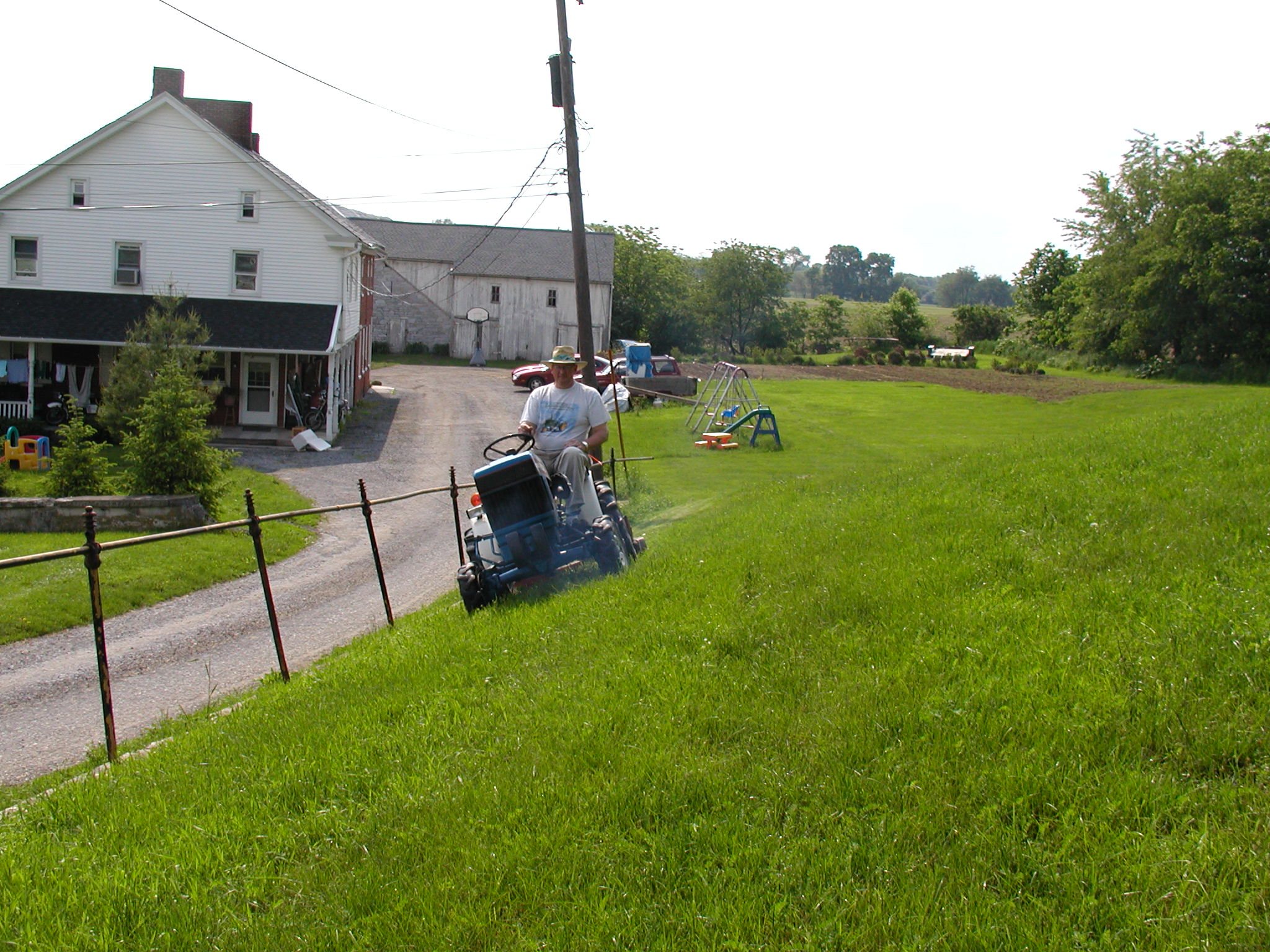

When I mowed for my Mom-in-law there was a hill that I really shouldn't have mowed across. As long as the grass was dry it was possible in 4WD. I usually used the old Ford on the hill because I could keep one cheek on the uphill fender and the other on the seat. The RFM doesn't allow any twisting between it and the tractor, so it was pretty stable so far as rollover from the slope itself. Even in good conditions the tractor tended to "crab" along the hill. My one fear was that I'd slide sideways. There was a concrete retaining wall atthe base of the hill that was flush with the ground I was mowing. The ground on the lower side of the wall was about 18" lower and the rusty pipe fence at the bottom would have served no purpose other than to be something to hurt on the way through it. A few times when the grass was damp it did start to slide. I steered sharply uphill and floored it and the tractor got itself pointed uphill.
Here's a pic and it doesn't look as bad as it really felt. That may be partly due to the utility pole behind me being out of plumb.

Judging by the tractor itself(if the camera is level) it appears to be approaching 40% slope on yours.
But judging by the roofline of the house, the camera isn't level. So maybe 35% slope?

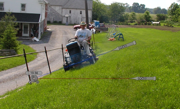

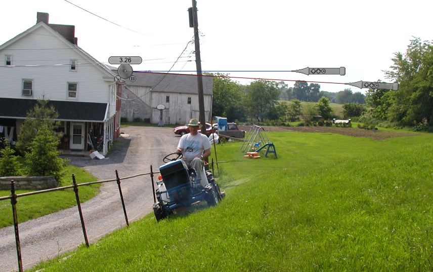

I have a program called Screen Protractor.
Barn:
Tractor:
