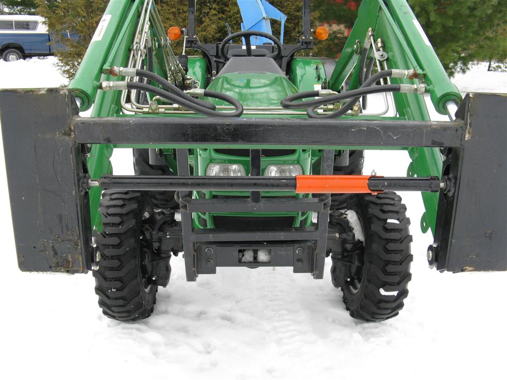

I keep forgetting to post the finished pictures:mad:. I built and installed the same QA on my Dad's Kubota L3400. Here is a pic of the finished product that shows the single lock tube. I will try to get a pic of mine this weekend.

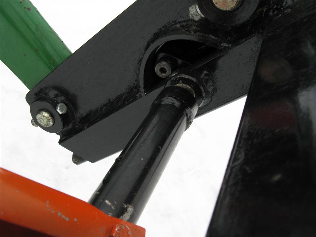

Yep; finally got around to getting the final pics. This has been in use for eight months or so and it works great. The orange handle has a rare earth magnet cemented to the inside; it sticks to the torque tube when not needed.
To unlock the QA, hinge the handle down and rotate up about 90 deg, the compression springs are released. Pull the handle up to release the pins (this can require a little force. Fold handle against the torque tube and then rotate the tube to fully retract the pins.
Bucket locked

handle swung down (pins still locked)
Compression springs released
Handle parked again and tube rotated to fully retract the pins
Another view of pins retracted and handle parked.

Sorry for the Kubota orange on the handle; makes for good visibility though.
