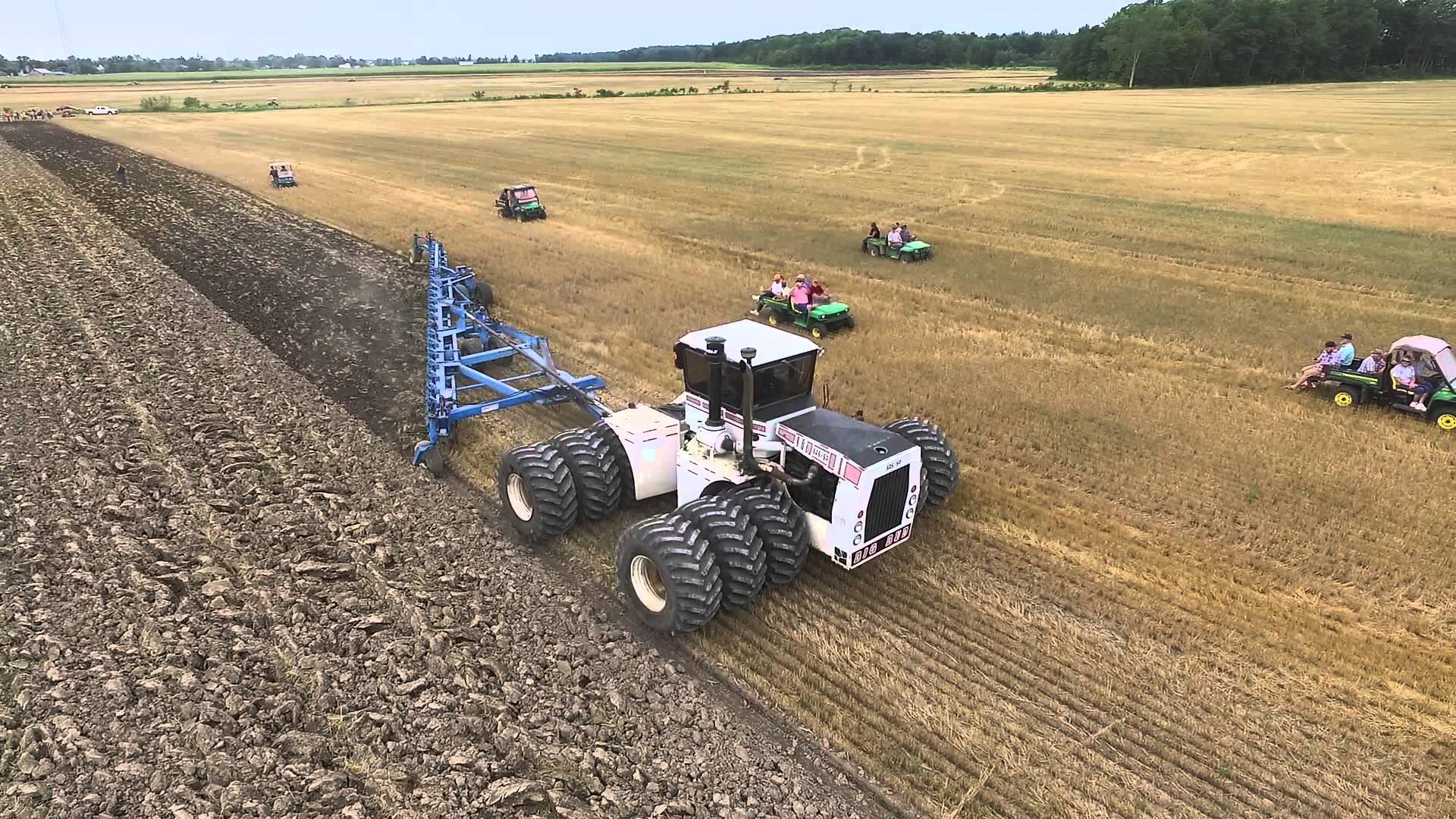

If bigger was always better we would all have 400 hp monsters...... wait that doesn't sound like a bad thing.
   / Tractor size for 17 acres? #25
Correct. My 3 point will lift like 1300 lbs. So I could do a round if I had to. However I could never do it with the FEL so no stacking. Wife only does small squares for the horses so I am set there.
It is a matter of figuring out what you are going to do and getting the right tool for the job.
If only my barn could house a 400hp tractor or above.
That's exactly what I need for my place. I wonder if I can fit a FEL on one?
