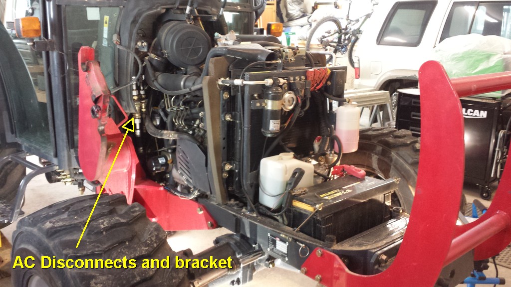

AC:
This seems like a problem. I don't use AC but I would like to keep it functional. The AC hoses have a nice disconnect section that is mounted into a bracket which is attached to the rear of the engine (not sure yet how hard it is to remove this bracket from the engine). I would like to not disconnect the AC hoses as I will lose all the refridgerant from the system. If I could dismount all the AC stuff from the front section I could hang it off the cab and not lose the refridgerant.

My tractor might have the AC quick disconnects. In the disconnect zone, where the bracket holds the lines, there's a bunch of fittings. They don't look exactly like the hydraulic disconnects with the knurled releases, but they might be some kind of quick disconnect. I will look more closely when I get out to the shop. If I do have quick releases... at the point of disconnect, can I expect a pressure release like hooking up to the air compressor?

Highly doubt they are disconnects that hold pressure. The norm for years has been a couple of O rings on a fitting that mates with a female end having a garter spring lock. Have dealt with those leaking for a lot of years, upgraded rings were available. Diffent sizes of removal tools are easily obtained. A couple of pics would be helpful. Manufacturers prob still use them as they are the quickest, fool proof method for assembly.

Here's a picture (not very good) of the AC disconnect zone.
I still have to look more closely and see if they are quick disconnects.

The AC connections were not quick disconnects. But I was able to unbolt the entire AC system and hang it on the cab without emptying the system so as long as it doesn't leak out... I should be able to reinstall and still have the refridgerant intact.
