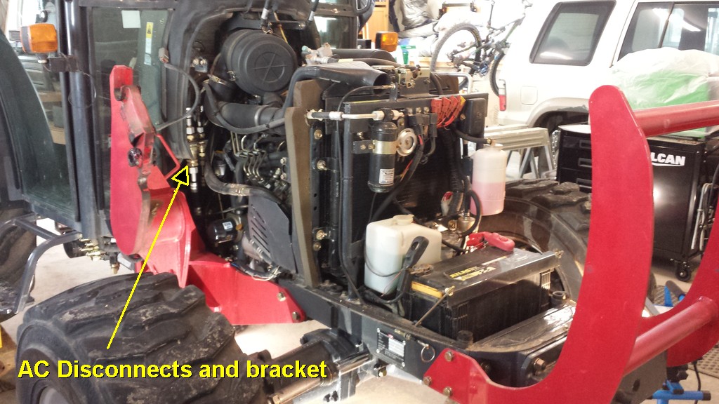

My tractor might have the AC quick disconnects. In the disconnect zone, where the bracket holds the lines, there's a bunch of fittings. They don't look exactly like the hydraulic disconnects with the knurled releases, but they might be some kind of quick disconnect. I will look more closely when I get out to the shop. If I do have quick releases... at the point of disconnect, can I expect a pressure release like hooking up to the air compressor?

Highly doubt they are disconnects that hold pressure. The norm for years has been a couple of O rings on a fitting that mates with a female end having a garter spring lock. Have dealt with those leaking for a lot of years, upgraded rings were available. Diffent sizes of removal tools are easily obtained. A couple of pics would be helpful. Manufacturers prob still use them as they are the quickest, fool proof method for assembly.

Here's a picture (not very good) of the AC disconnect zone.
I still have to look more closely and see if they are quick disconnects.

Don't look like push together type in that pic.

Only one of the "lots more" I alluded to in a previous post. If and when you find system must be opened,we can talk more before wadeing in. Quick,slow or skinned knuckles type,wear eye protection and gloves while disconnecting them. Liquid refrigerant can burn worse than steam.

The AC connections were not quick disconnects. But I was able to unbolt the entire AC system and hang it on the cab without emptying the system so as long as it doesn't leak out... I should be able to reinstall and still have the refridgerant intact.
On the hydraulic steering hoses. These are just another hydraulic hose and should be handled accordingly, correct? Carefully bleed off pressure and drain and disconnect?

Yes for the hydraulic hoses. Also cap both sides of any connection you open.
