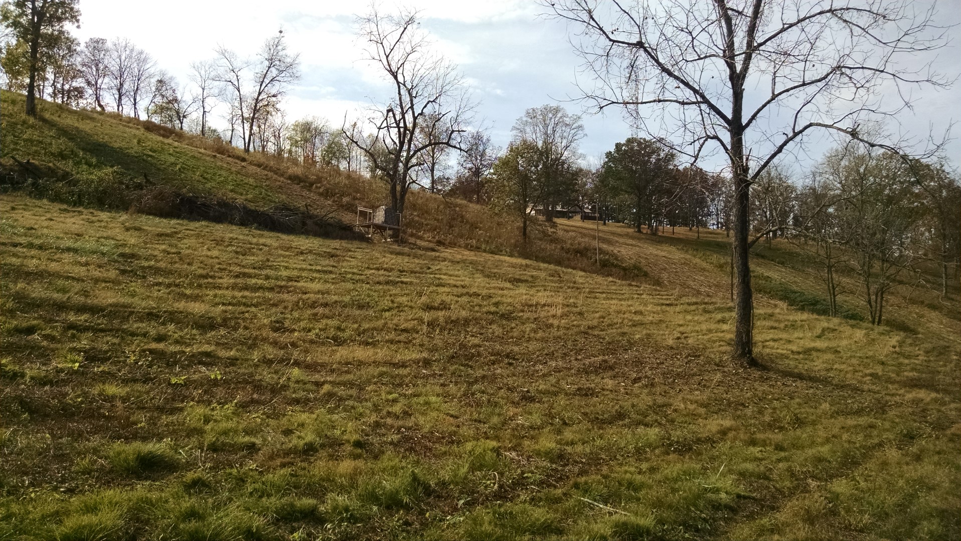

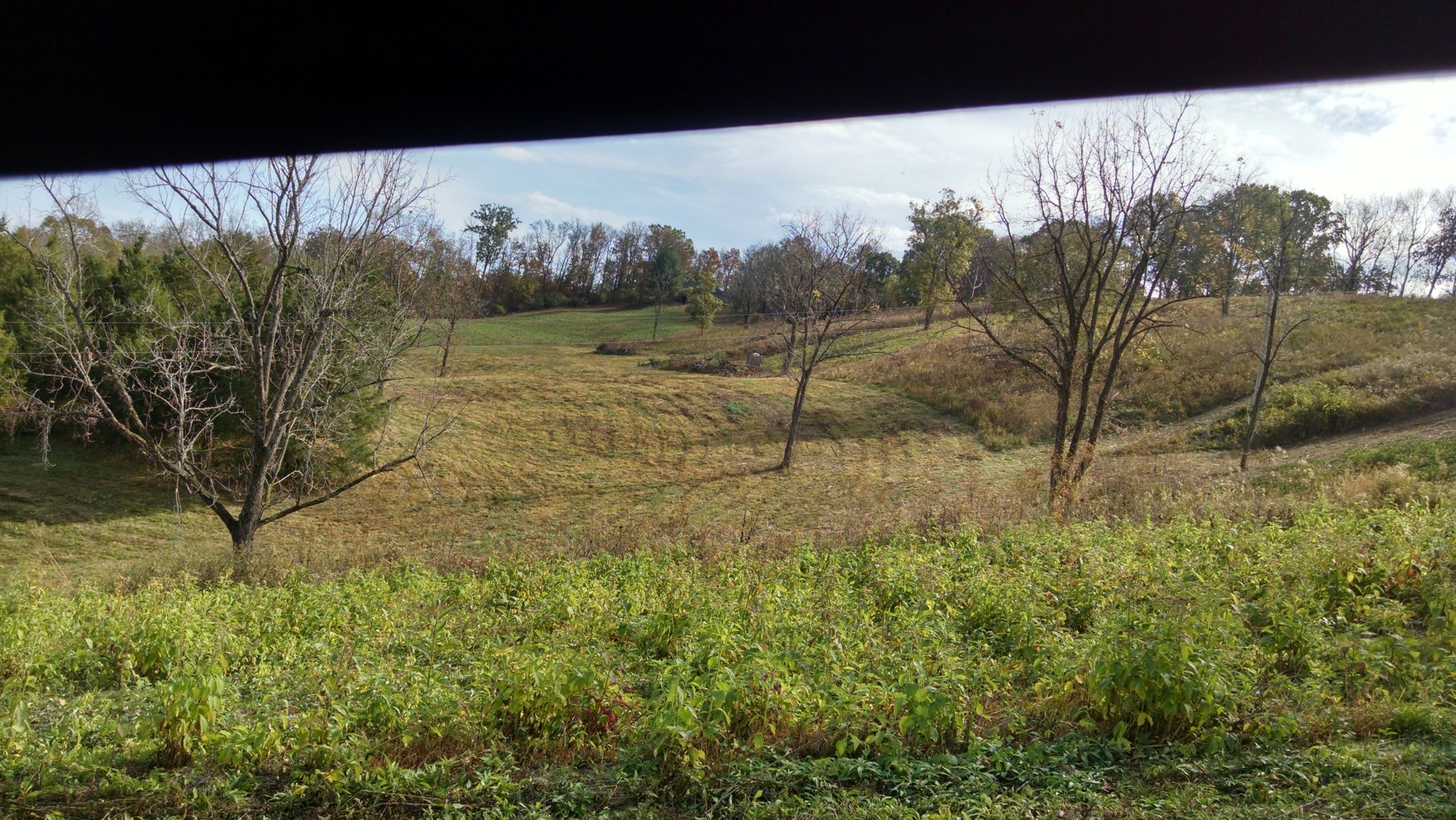

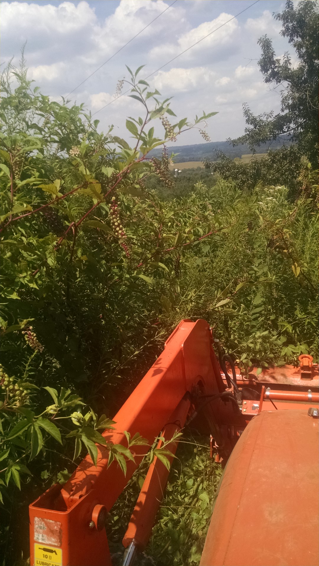

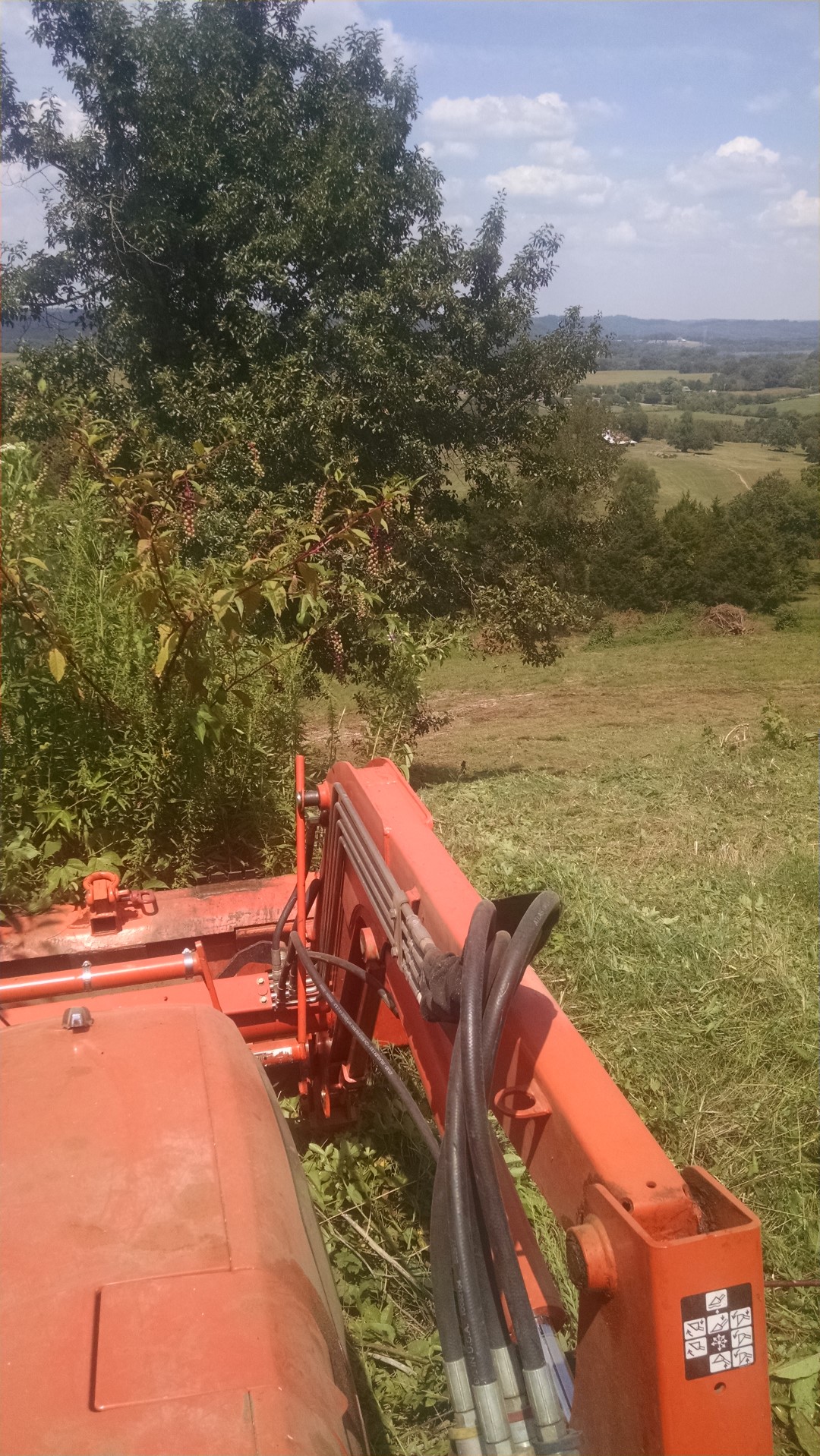

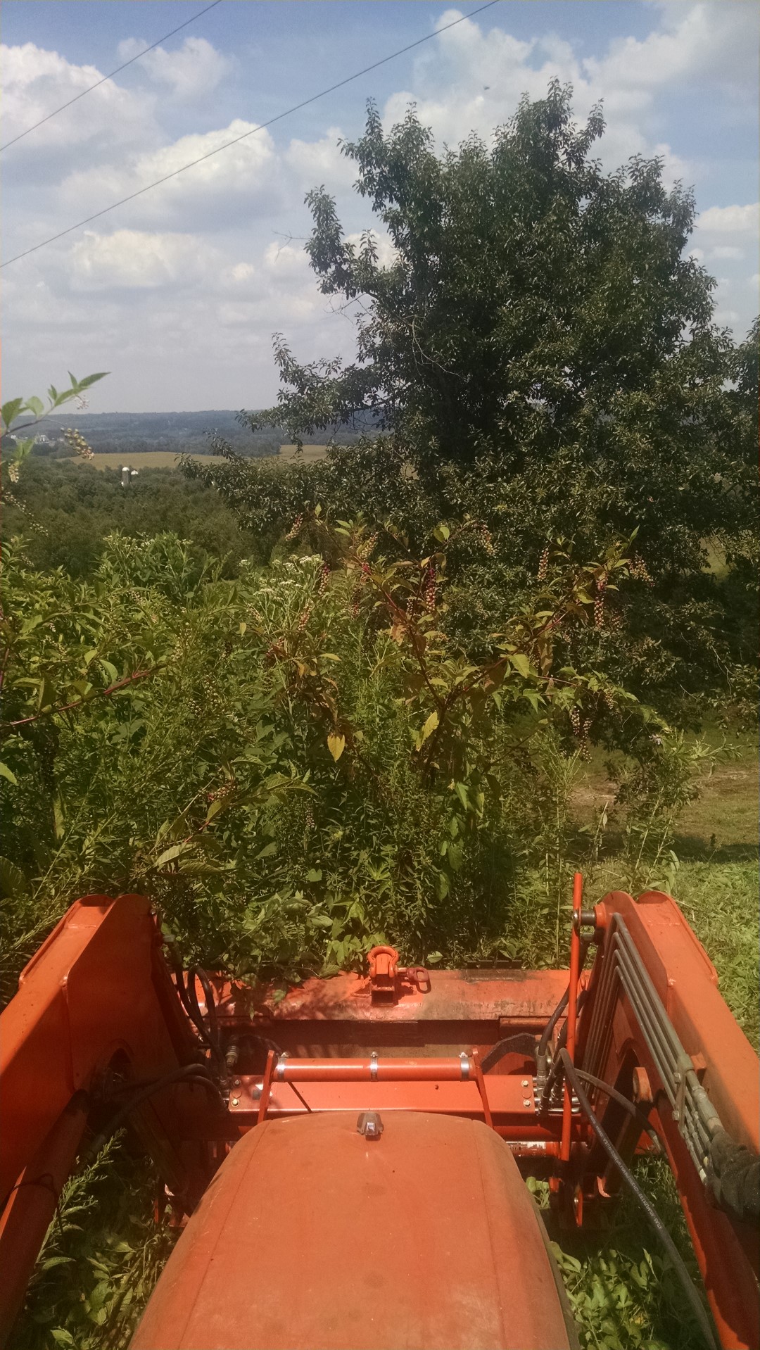

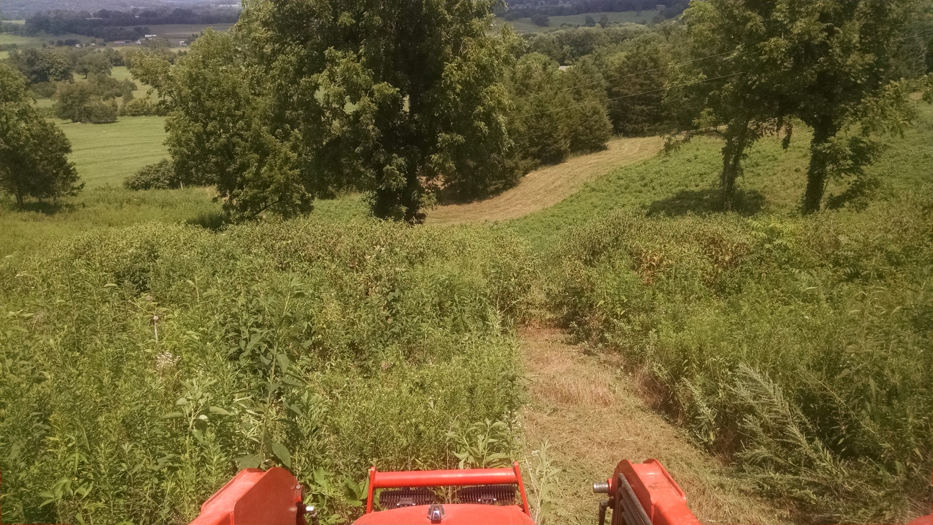

I live on a hill, but since I'm retired, for the most part I get to decide when and where I go up or down.
Some things I've done to improve my tractor's ability to go up and down:
- Filled both rear and front tires. Rear wheels have concrete, steel and lead wheel weights (500 lbs total). Loaded front tires worked better then 2 30 gallon water filled barrels in the FEL).
- Added front weights to the weight bar.
- Added 910 lbs to my 675 lb BB, which is my usual 3ph counter weight; if I'm bushhogging, I use my BH286 ~1k lb bushhog.
- Lowered the rear and front tire pressure for full tire width contact.
- Had the rear tires and wheels widened to their widest setting (Grand L's have about 5 settings, IRC). The downside: too wide for most implements like my 6' wide BH and BB.
Some advice for going up and down hills:
- Never go down a hill without 4wd engaged. You'll do it once, take the 2" ride*, then never do it again.
- Never go down a hill without significant weight on the 3ph.
- Try to never go down a hill when it's wet, either from rain (slippery mud/ground) or dew (slippery grass).
- Except to bypass an obstacle, I never back up a hill. I want the rear tires doing most of the work, not the front. Plus it's far easier to see where you're going. Personally, I think backing up a long hill like I have is retarded. No offense.
Some pics showing the hill I have to work on:
Pics while bushhogging it:
IMG_20160723_140517494 (Large).jpgIMG_20140815_135717364 (Large).jpgIMG_20140815_135720274 (Large).jpgIMG_20140815_135730780 (Large).jpg
I hope this helps!
*2" Ride: Uncontrolled ride down a hill, whereupon you suck up 2" of seat cushion before you get it back under control. Also known as "I just crapped my pants" ride in some circles.
