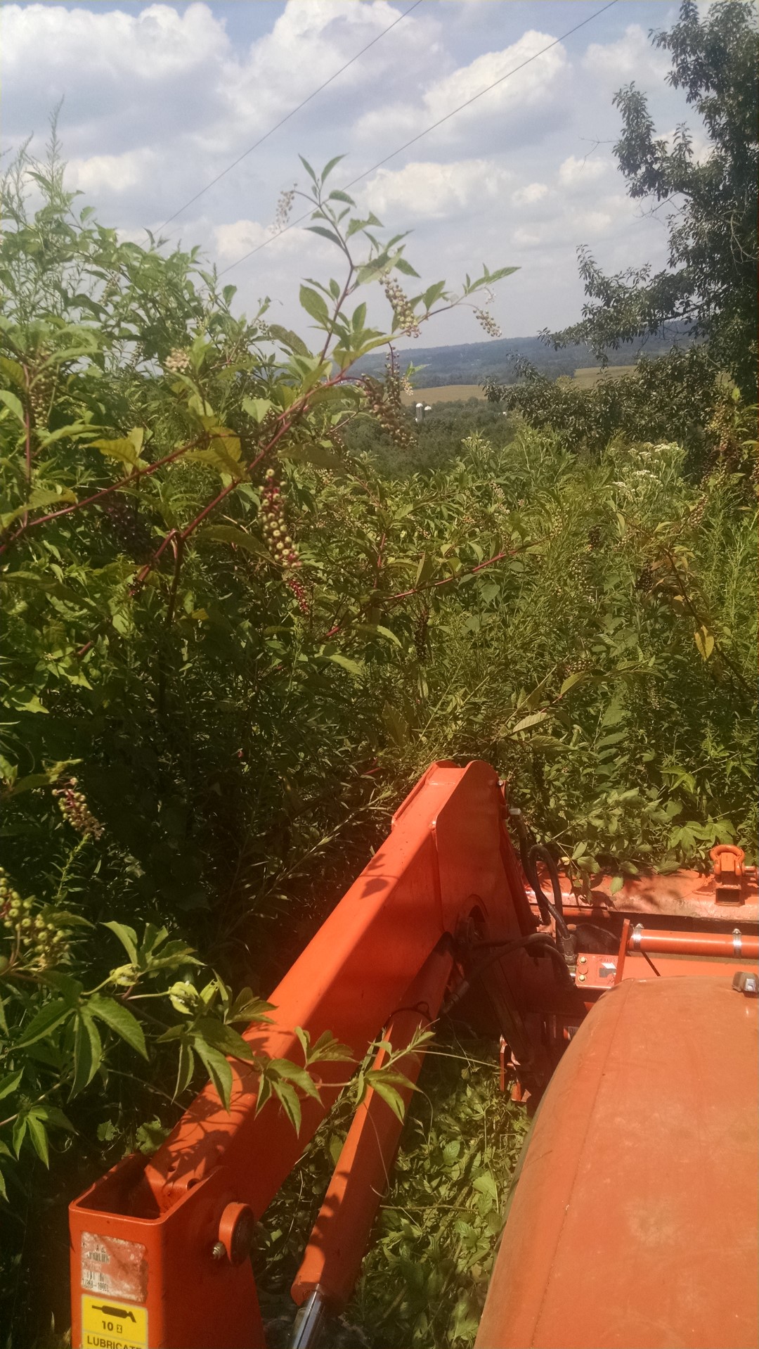

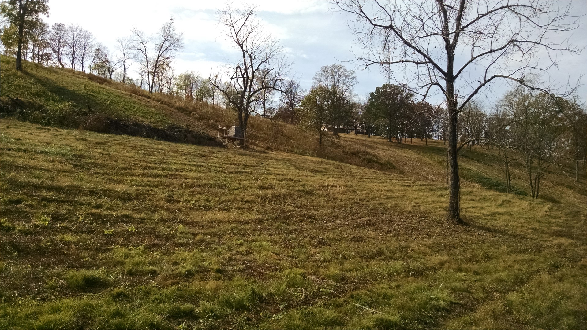

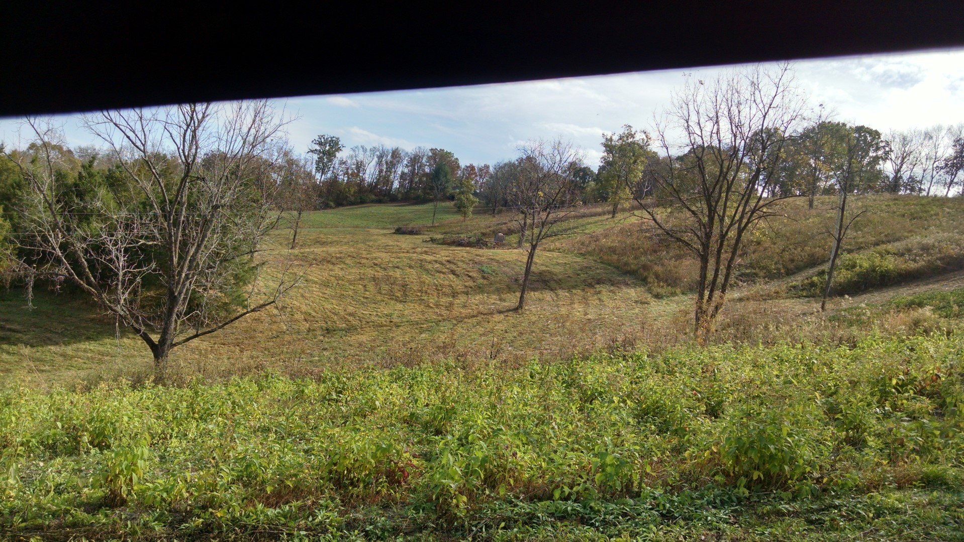

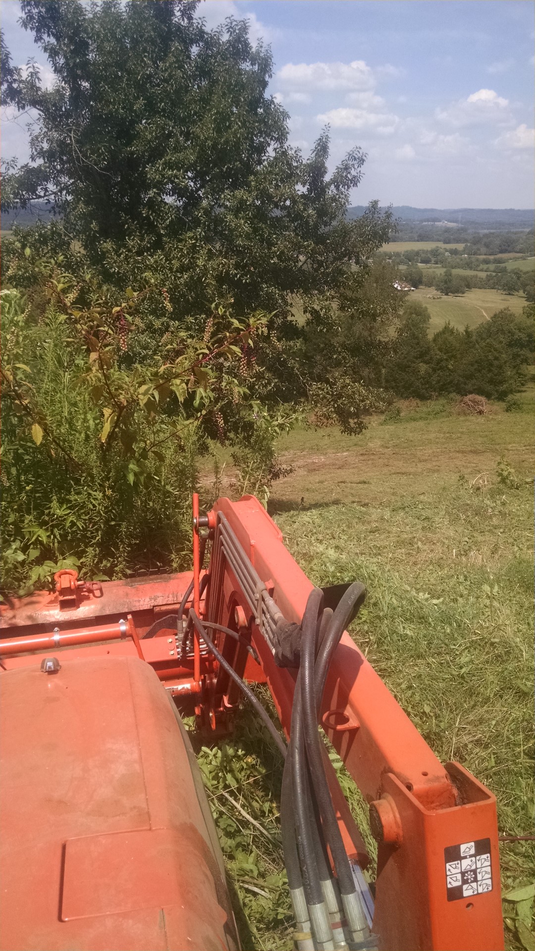

Regarding backing up long hills, especially with a bushhog.
Look at these three pics; note how high the vegetation is, particularity the Poke Salad Annie (don't recall it's scientific name). In these pics, it's about 10-12' high, I was sitting in my tractor (L4330) when I took the pics.
IMG_20140815_135717364 (Large).jpgIMG_20140815_135720274 (Large).jpgIMG_20140815_135730780 (Large).jpg
Basically, there is no way to realistically go backwards against that heavy and high vegetation. I can barely go up the hill forwards and only by taking a small 3-4' cuts instead of a full width 6' cut. I couldn't see crap going forward, there's no way to see anything going backwards.
BTW, that was the first time I bushogged my field after I bought the place. I first BH'd it August 2014 and it was probably 3-4 years since it was last BHd. There was a thread here on TBN about bushhogging my hills from around that time, but I can't find it right now.
