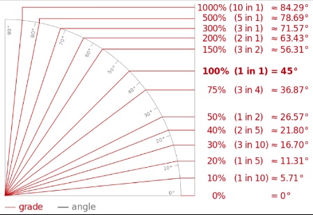

You can get a free inclinometer app for your smart phone and measure the various slopes around your house. Most will give you a slope measurement in both "percent" (as in percent of grade) and "degrees".
Slope chart:
As to safely "discovering" your tipping point, you can put a jack under one side of your tractor and start lifting that side, stopping to test pull from the opposite side to see how far over you can raise the tractor before the center of mass gets close to the tipping point. Once you feel the weight start to come off of the jack from pulling on it, that can be your hard stop, "not to exceed" number for that tractor.
