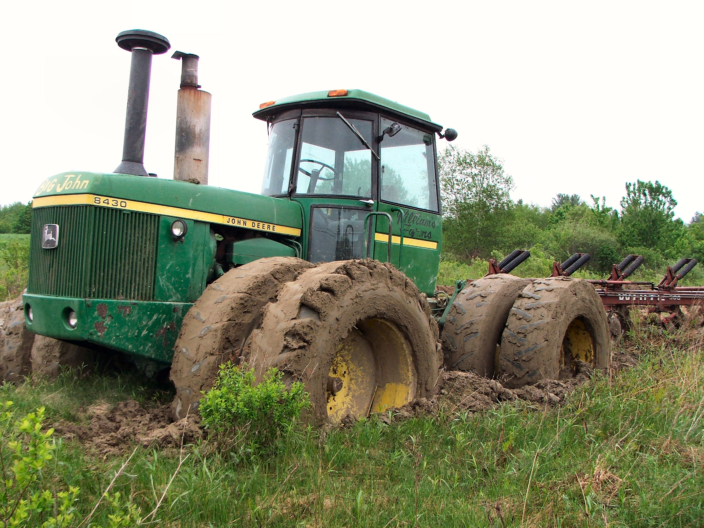

   / Tractor stuck in field, rite of passage? :) #19
Only a little stuck.....
