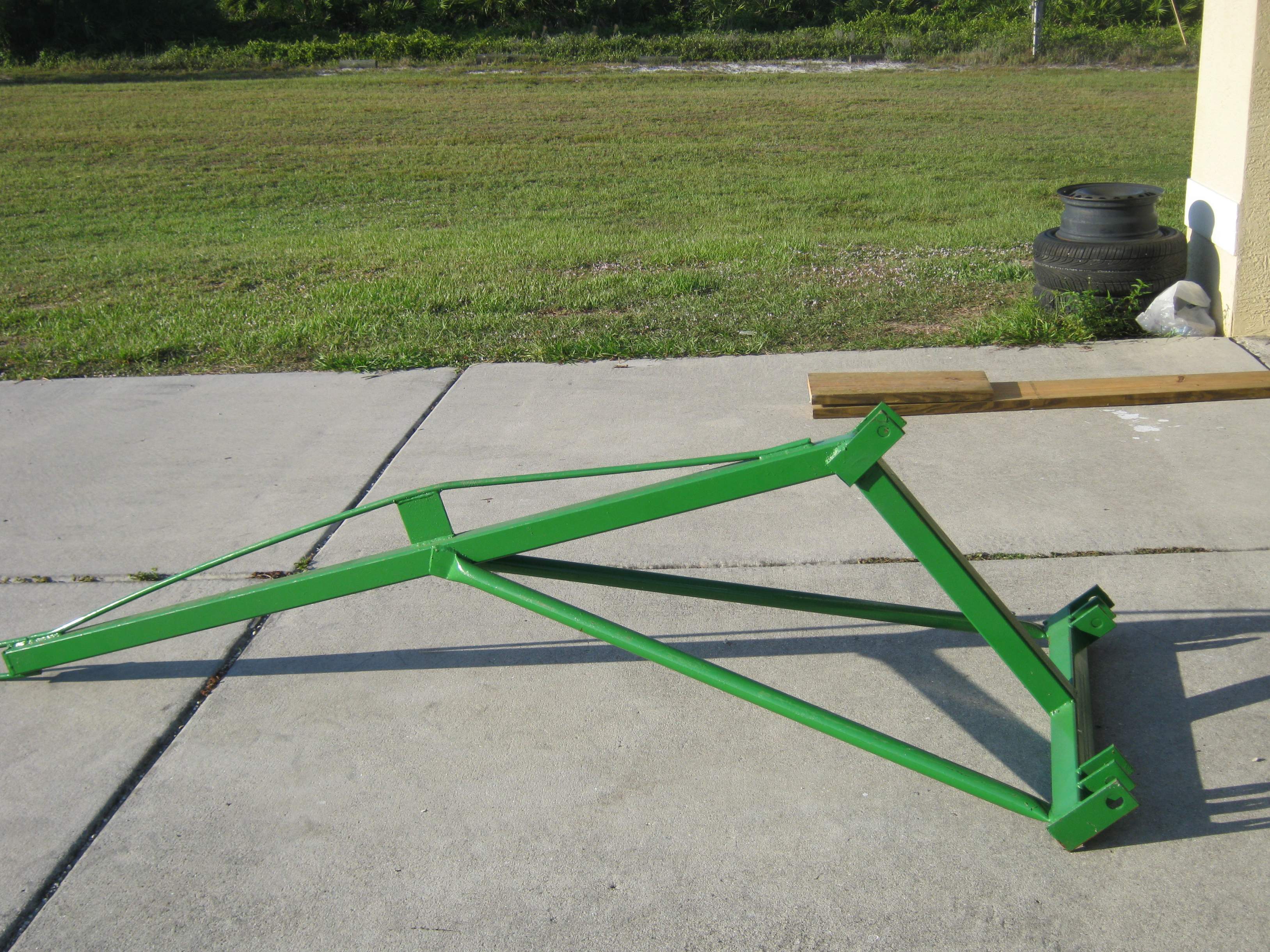

The paint is unfortunate, but the misaligned holes are definitely going to impact performance. Looks like poor quality control. I would take it back and ask them to exchange it for another, then take the time to have a boo at the next one to see that the holes line up properly before you load it on the truck.
I don't blame you for being upset. I would be ticked off about that too.
Maybe to save $ they have a cyclops on their assembly line. :D

Having the top link pin at some small angle might change perception, but it won't affect performance.
Besides, ol' one eyed Joe has got kids to feed, too.
I didn't notice how crooked mine was until i got it home, unloaded it, and went to put the top link pin in it.
If I had seen the misalignment at the store, I never would have bought it.
Now that I have thoroughly abused it for several years with no ill consequences, it just doesn't bother me.
I could cut it off and weld it back on in about ten minutes, but I've got more important things to worry about.
Like we still haven't planted the corn ... I guess we're buying from the guy up the street. Again.
