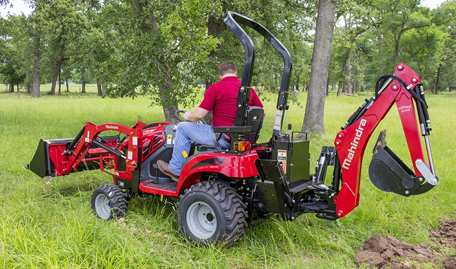

I have a sub-compact, emax 20s with a bucket and backhoe. A couple of times with a heavy load on the front (clamp on forks) I've felt a rear wheel lift off the ground. Lowered the bucket, inched forward, and lowered the backhoe outriggers to help keep from tipping. Is that a stupid think to do? Does it help?

Clamp on forks puts your center of gravity way out beyond your front axle. When using forks, you should cut your lifting ability by about half to 2/3rds. Being your front axle is a pivot point, Yes, when the back wheels come off the ground, you are very quickly going to lean to one side or the other. Filling the rears might help some. That small of a tractor, I personally wouldn't use forks on it.

With the backhoe on the tractor, you have all the counterweight your machine needs. Tipping means you are seriously overloading the tractor. someone or something will get hurt.

The outriggers aren’t gonna help prevent you from tipping because the fulcrum is the front wheels. Sounds like you are lifting close to a max load and the inertia of your movement is causing the light rear. Slow down, don’t carry so much, or….get a bigger tractor :poop:

I would suggest getting a quick attach and forks. The clamp on forks push the weight to far forward. You could add weight to the rear tires to help. Or put some dirt in the backhoe bucket. This would help as well.

The real method is to not lift such a heavy load. The machine is not stable unless you can add more rear weight.
