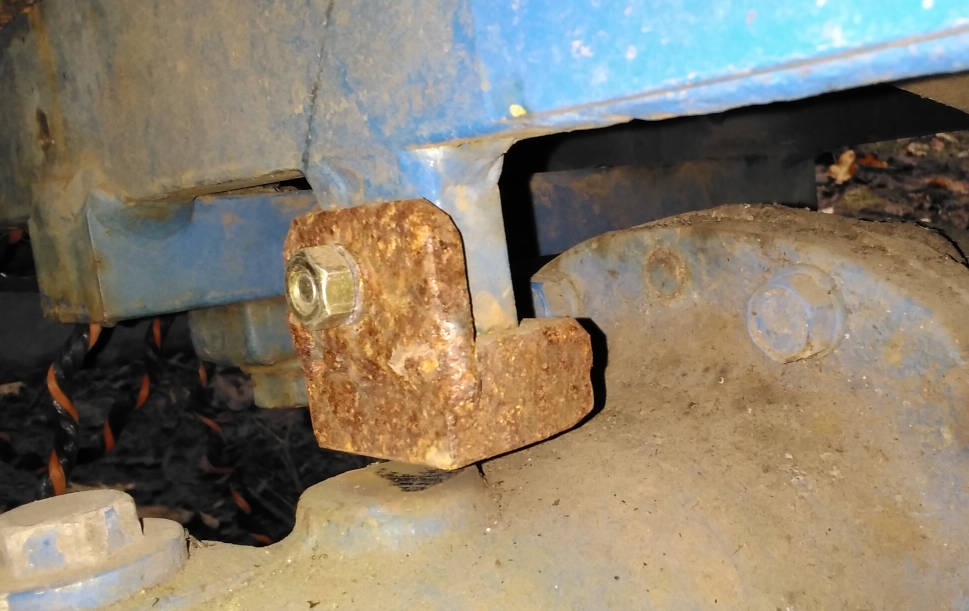

Overall, I like having the forks. Rear ballast helps a lot. I don't think they negatively impact hill performance. However, I've mentioned before that I've added front axle stops to keep the front axle from rolling to the side with the bucket filled.
So, having the bucket cause the front axle to roll on a hillside could mean dire consequences.

Angles are also critical. So, I had one load of steel that seemed to be doing OK, but the tractor veered to the left down a very slight incline on its own, and I rapidly went from balanced with rear wheels on the ground, but a little floaty feeling to the bucket dropping to the ground and the rear wheels high. Rather disconcerting but no real danger since the front axle is blocked from tilting, and the bucket wasn't up that high.
