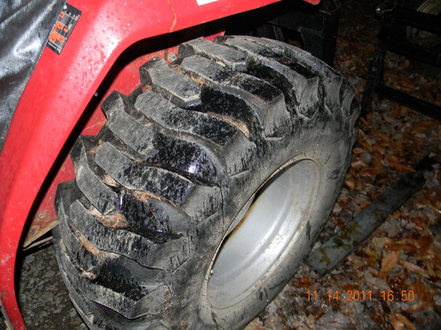

My tractor is a 2004. So I guess that's 8 years since 2012 tractors are out.
I run R-4 industrial tires. Rears are in great shape. Fronts are the ones that seem to get the most abuse mainly from turning. They have various nicks and cuts and have been plugged from nail holes.
The tractor sees minimal road use and only has about 400 hrs. (My tires are pictured) They still have plenty of life left in them. From what I can see and from other friends tractors the front tires will be the first ones that need changing. One friend just changed his front tires on a JD 790 with about 2000 hours.
