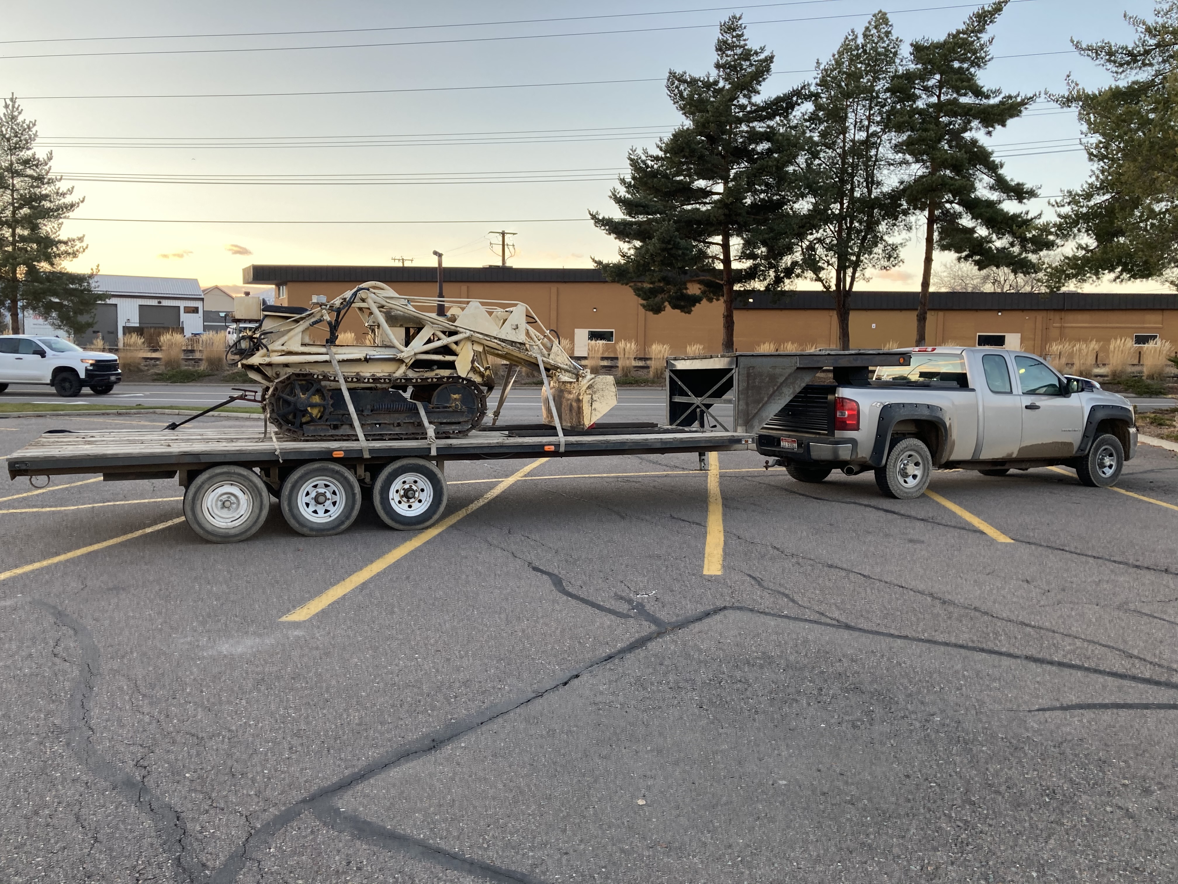

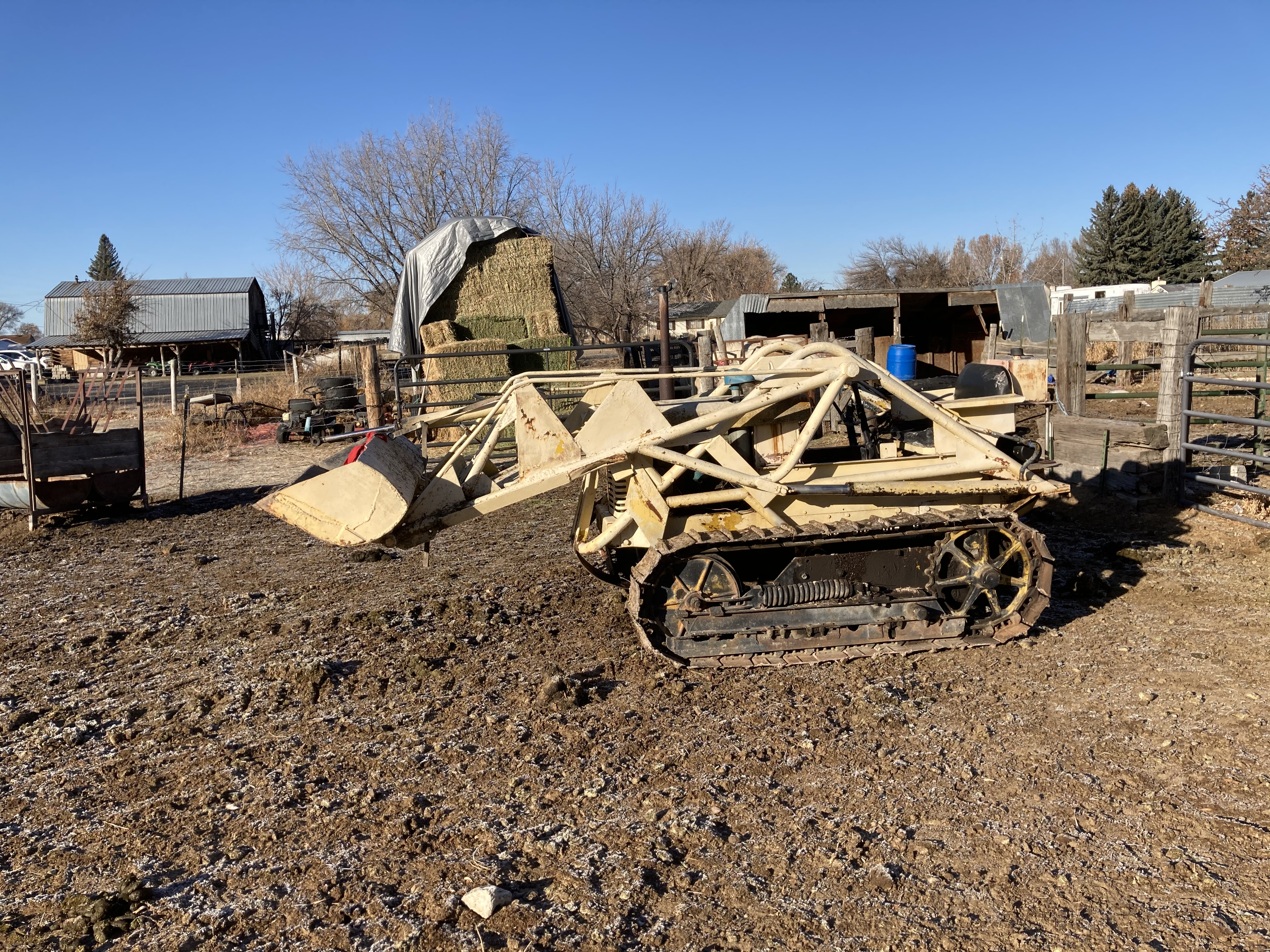

Here are some pictures. It looks like this machine spent a lot of time sitting idle in its previous life.
The first picture is in Missoula before we came back home. The last two pictures are of the crawler at it's new home. You'll notice a bit of a "smile" in the bucket in that last picture. That's something that I'll probably be asking for advice how to fix in some future thread.

If you could put the bucket under something that won't move, and then use a heavy hydraulic jack with a piece of hardwood under the edge, that should do it.
