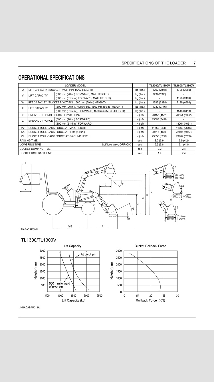

Found some great info with a lot more detail on the L47 owners manual. Also seems like Kubotas breakout definition is similar to what jb1390 described because they have different specs for bucket rollback.
