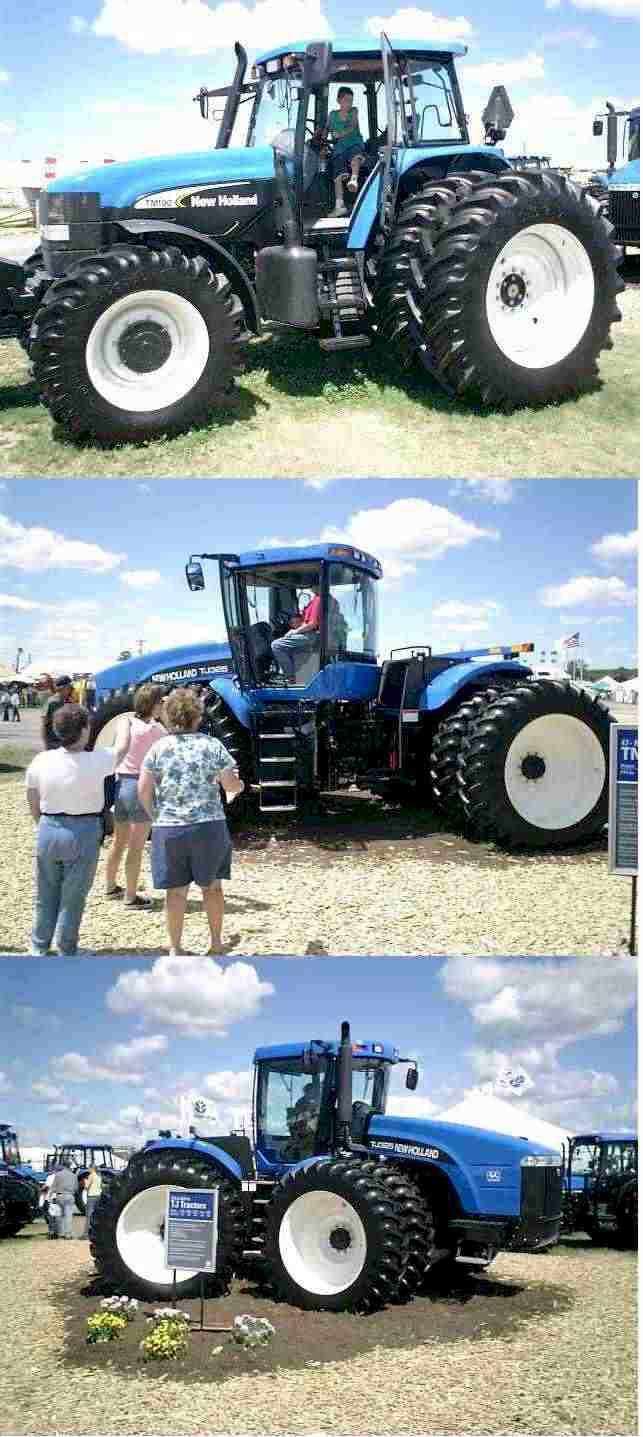

/ Tractor vs. Tractor/backhoe #11
Daryl, that's not me peering at the back of the 110. I was taking the picture. /forums/images/graemlins/cool.gif
I'll give everyone a hint about the person's TBN username...Billy Joe Royal.
Here's what I was drooling over. /forums/images/graemlins/smile.gif

Hey give the guy a break! He is peeing all over that machine while wearing his blue hat /forums/images/graemlins/grin.gif
/ Tractor vs. Tractor/backhoe #13
Mike:
TOOOOOO big for you. Is that you in the drivers' seat? You look young for your age /forums/images/graemlins/smirk.gif
/ Tractor vs. Tractor/backhoe #14
I hope you meant pearing, not peeing, if peeing, I hope he has a BIG bladder. /forums/images/graemlins/smirk.gif /forums/images/graemlins/smirk.gif /forums/images/graemlins/smirk.gif
