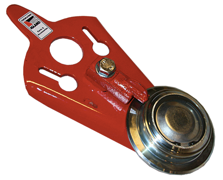

A self releasing snatch block is really useful. I found this one works well and was the best price I could find (but that was a few years ago and things might have changed):
You can find youtube videos of the snatch blocks in action. I rig this one so its upside down which I think makes tripping the release easier.
I use cargo sling straps to hold it instead of chains, which will damage the tree. The straps can also if it rotates around the tree so plan out the forces in your head and set if in the right place. I got slings with reinforced loops which are too stiff and want to slip off the point on the block if there's not enough tension on them. I need to weld an extension on.
