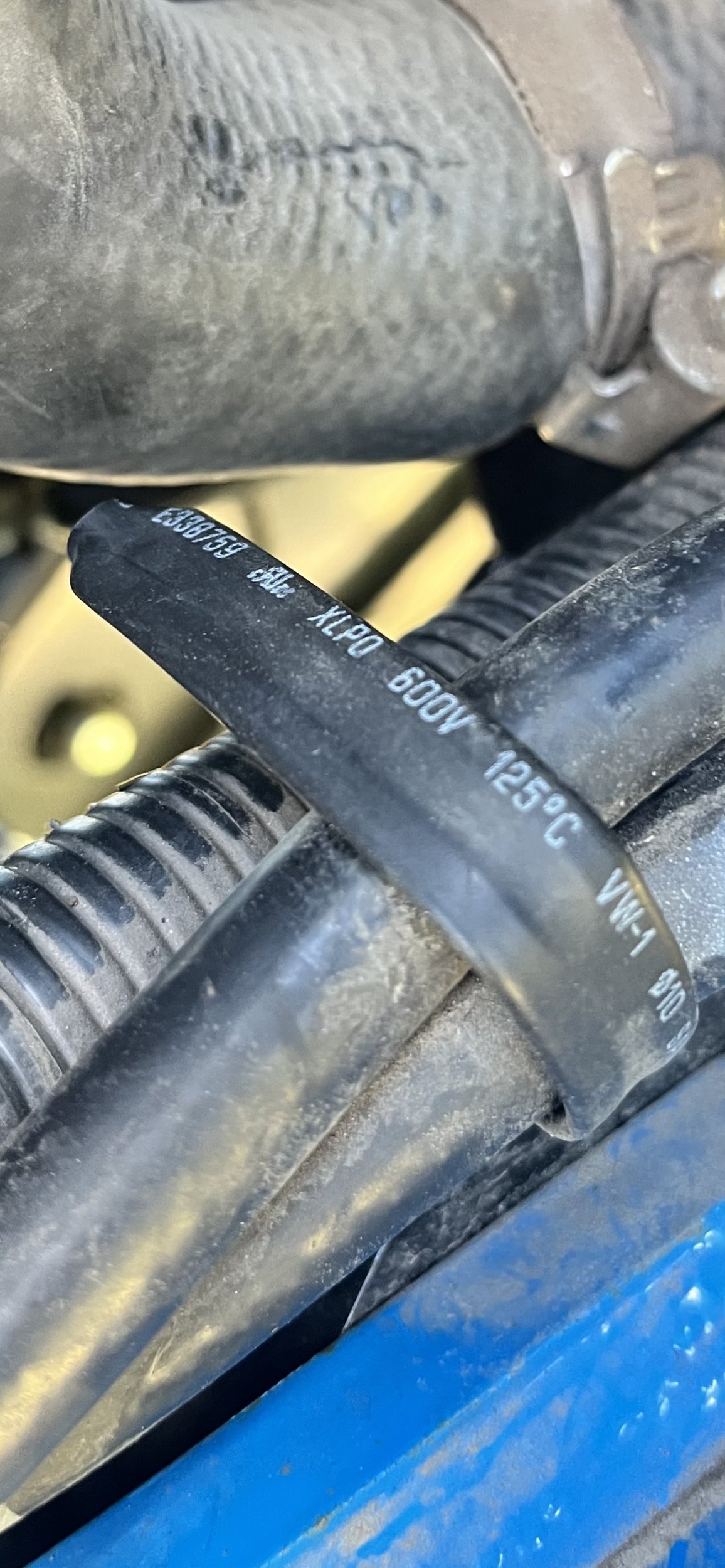

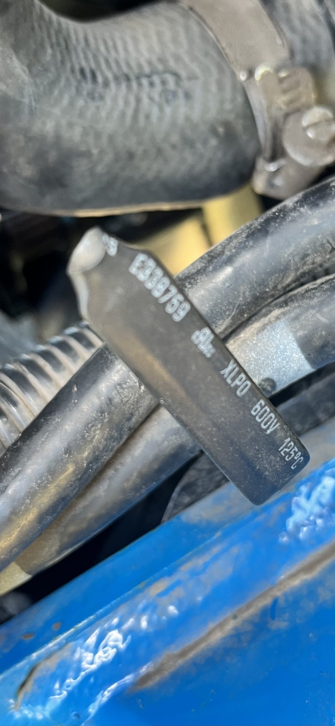

Our tractor will click but won’t start. We replaced fuses, checked safety switches and can’t find anything except this weird wire that seems to go nowhere. What is this and should it be attached to something?
That just looks like a clamp for all the wires and hoses to me.
