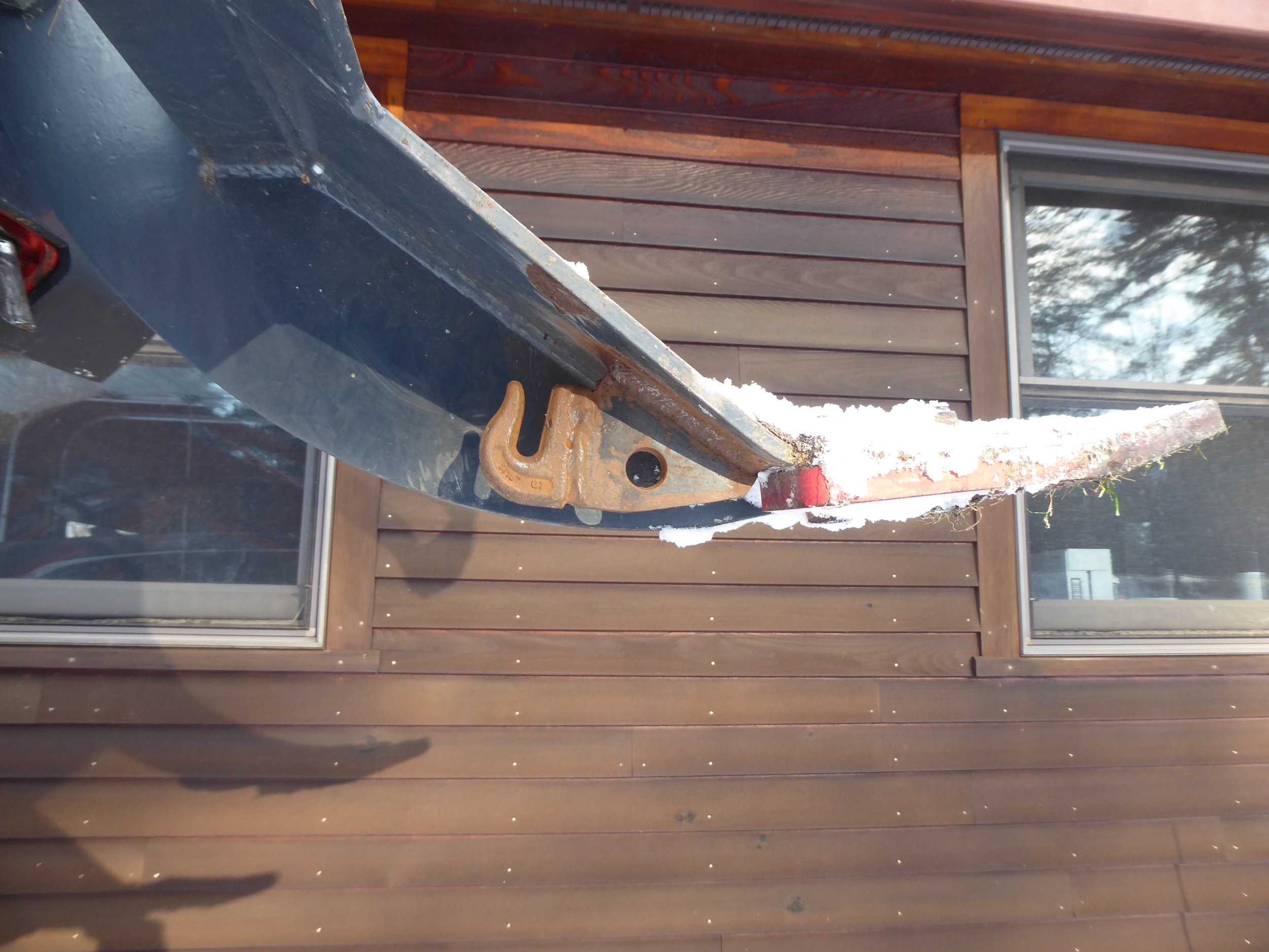

Gordon - exactly where did you weld your grab hooks on to your grapple? I have a similar grapple and have been trying to decide where to put some.
If you didn't want the shackle lug you could rotate the grab hook 90* and weld it to the vertical side of the tine.

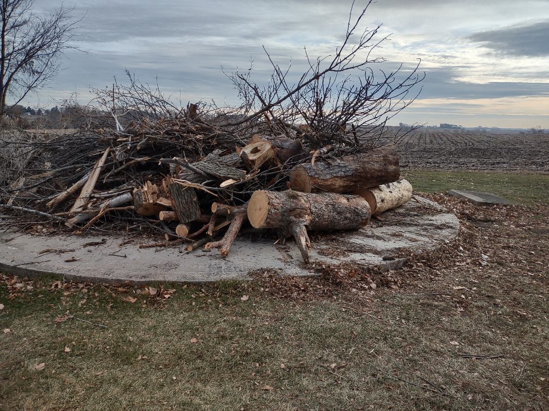

Green tractor and Husky saws are resting in the barn. My back hurts. I got a lot of firewood in the last few days. This is where the rest of it goes. The big logs are Ponderosa Pine, which I won't use in the wood stove. I'm debating on lighting this off now, or letting the critters winter in there and burning it in the spring. Thoughts?View attachment 838372

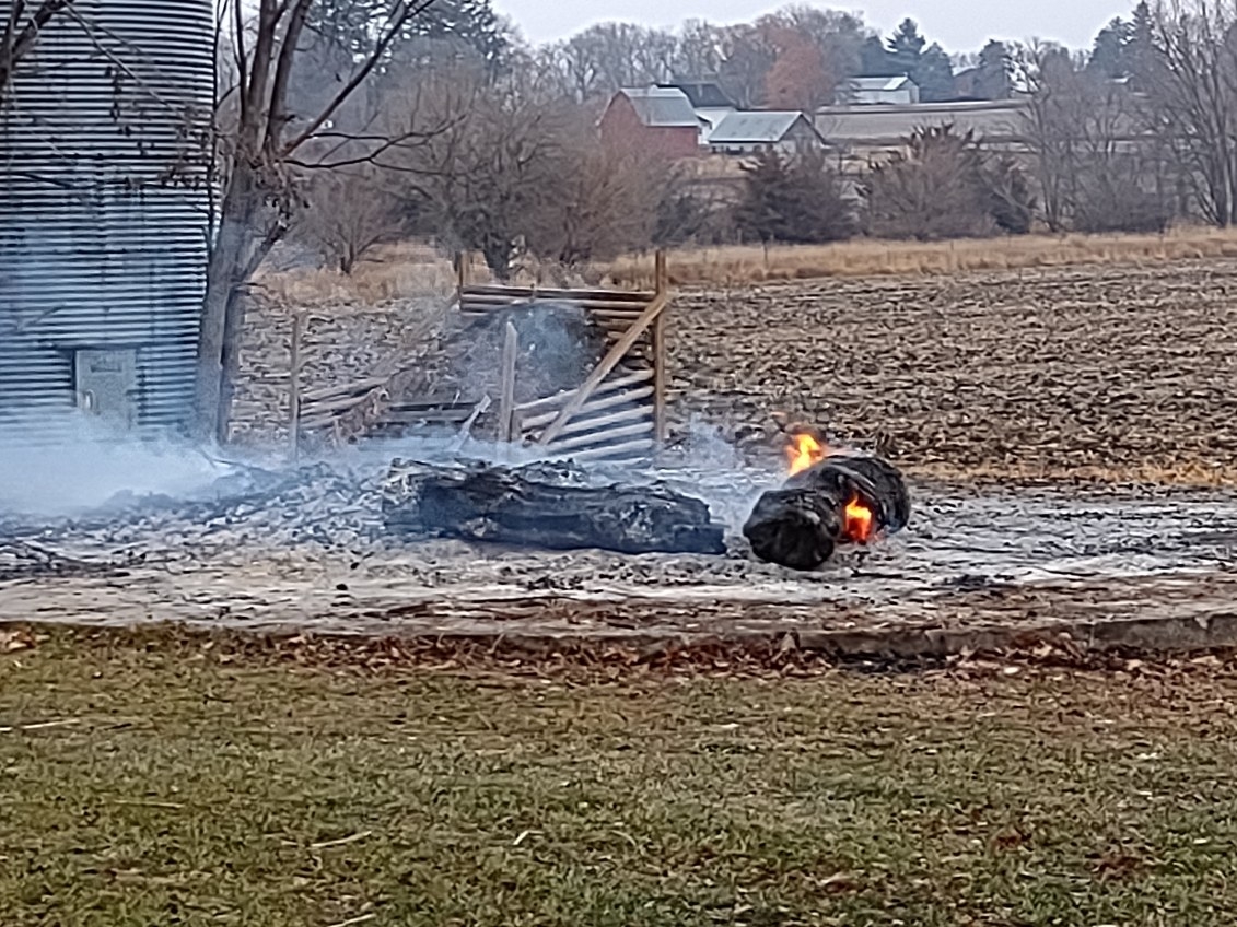

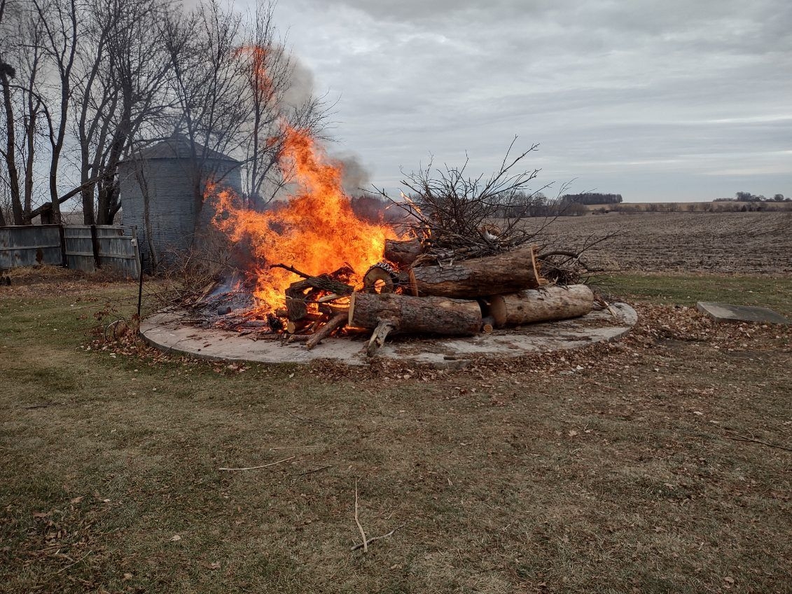

Couldn't wait 'til next spring. Nice, dry, calm day.

I put a shackle lug under there and welded a grab hook to it.

Thanks Gordon. That's helpful. I like the set-up with the shackle lug as you have it better than welding it on the vertical side of the tine. If I end up backing up with a log or something heavy attached, the load will be in-line with the hook, rather than a 90˚ side load.
Is that shackle lug something I might find at a tractor dealer or farm supply place?
Google 'weld on lifting lug' to start. Might have to poke around to find the shape you want with a surface for the grab hook. I cut mine out of a scrap piece of 1/2" plate and used a hole saw.
Good point about the 90* side load !

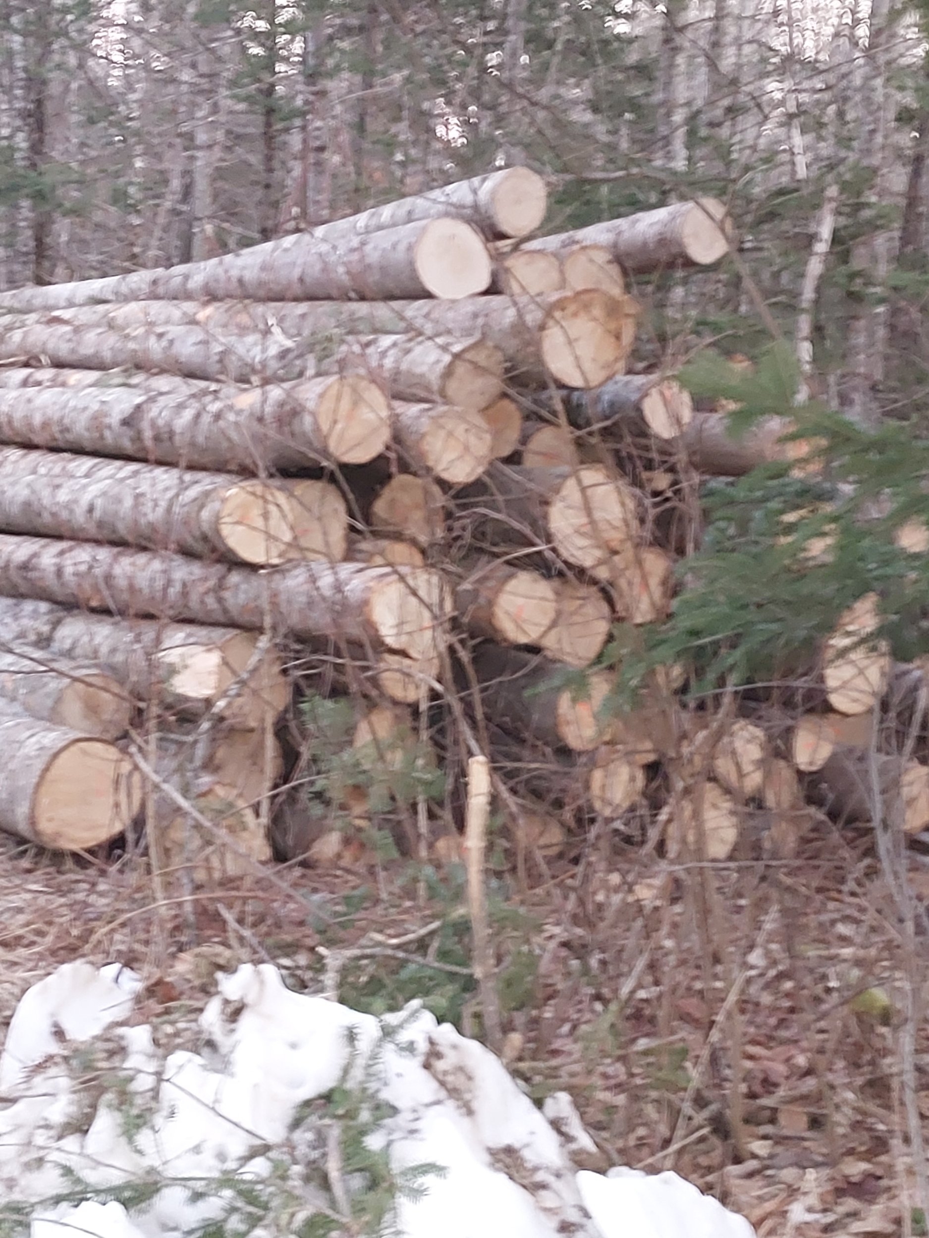

Nothing like what Gordon and a few others do, but I'm slowly working up a pile of fir studwood. I've been picking away at it for 2 months, hopefully by Christmas I'll have full 9 cord load to send.
Looks good - nothing wrong with a little at a time as you have time. You need a lot of sticks to make up a 4 mbf or so load. Seems the weather might be on your side this year if you have a dry lot.

I don't even know exactly what I'm looking at, but it looks very useful. anything that gives me a place to hook a chain or strap gets my approval.(y) that's not a ripper is it?

It's a side view of his forestry grapple

Nope - a log grapple.

What was the original purpose of that slab? Another silo?
Yep. 28 foot, poured in 1980. A neighbor bought the bin, tore it down and moved it 5 miles away (long before I moved here).
