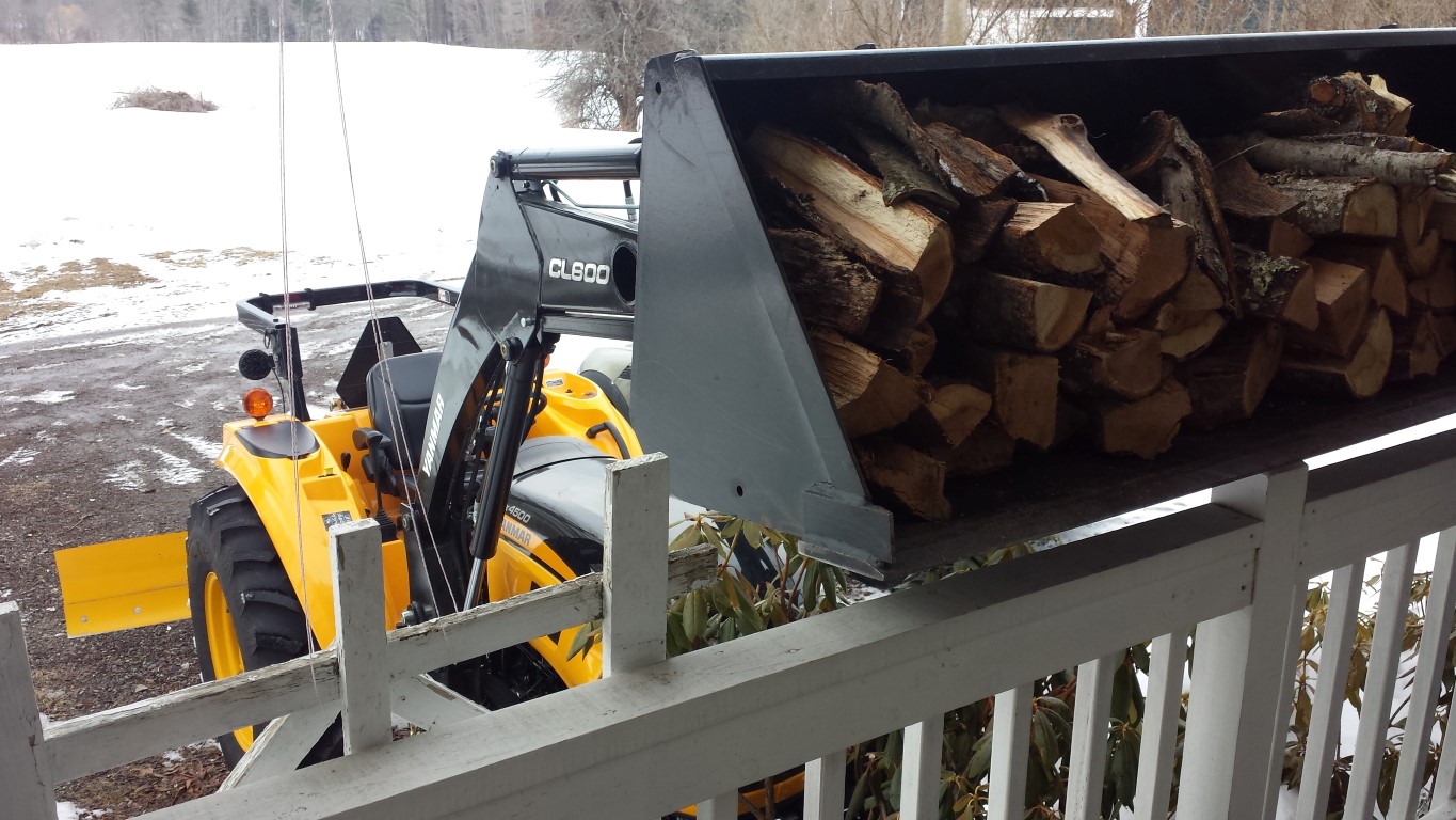

Here's how we bring firewood to the porch now that we have a tractor. It sure beats the old wheel-barrow method!

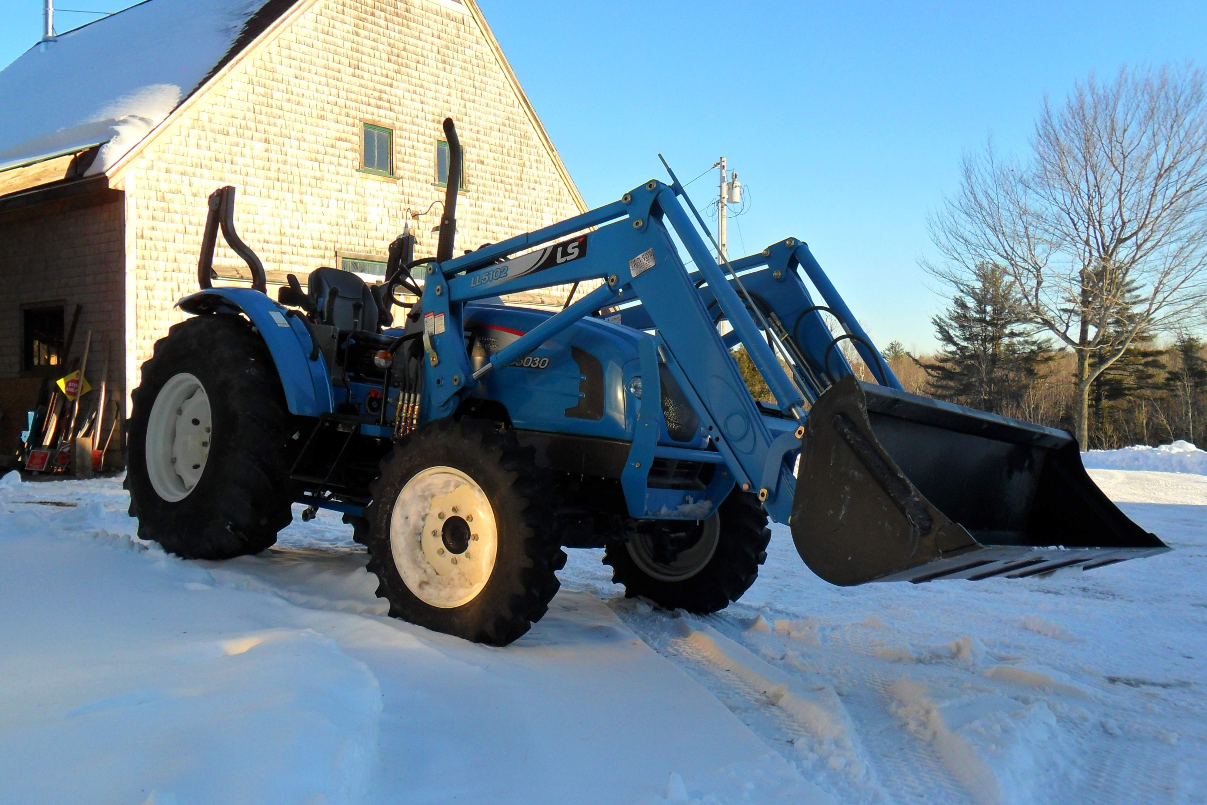

My method of getting it down to the basement where the wood furnace is has just gotten easier:
First, I got a new tractor. LS U5030.

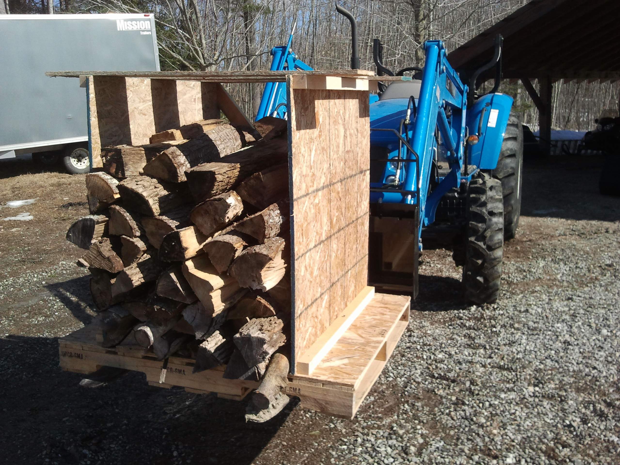

Then, after I got a set of pallet forks from Titan, I built a carrier out of a good pallet. I narrowed it down to 30" because my bulkhead stairs are 36" wide. Even narrowed down, 2 rows deep, it's about as much as I could fit in the bucket.

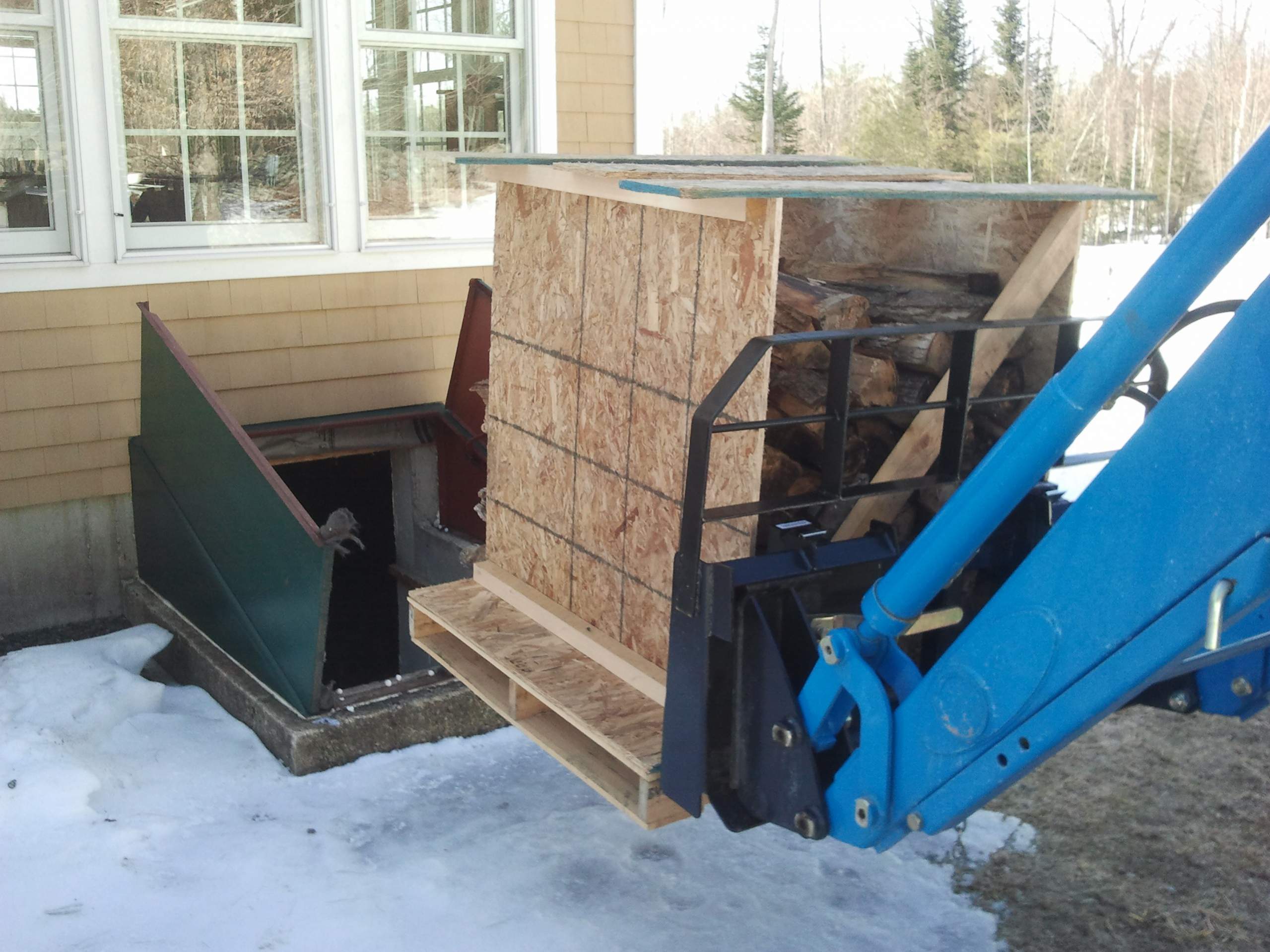

Drive her over to the bulkhead and dump her down. I chained the pallet to the fork frame so I don't lose the whole thing.

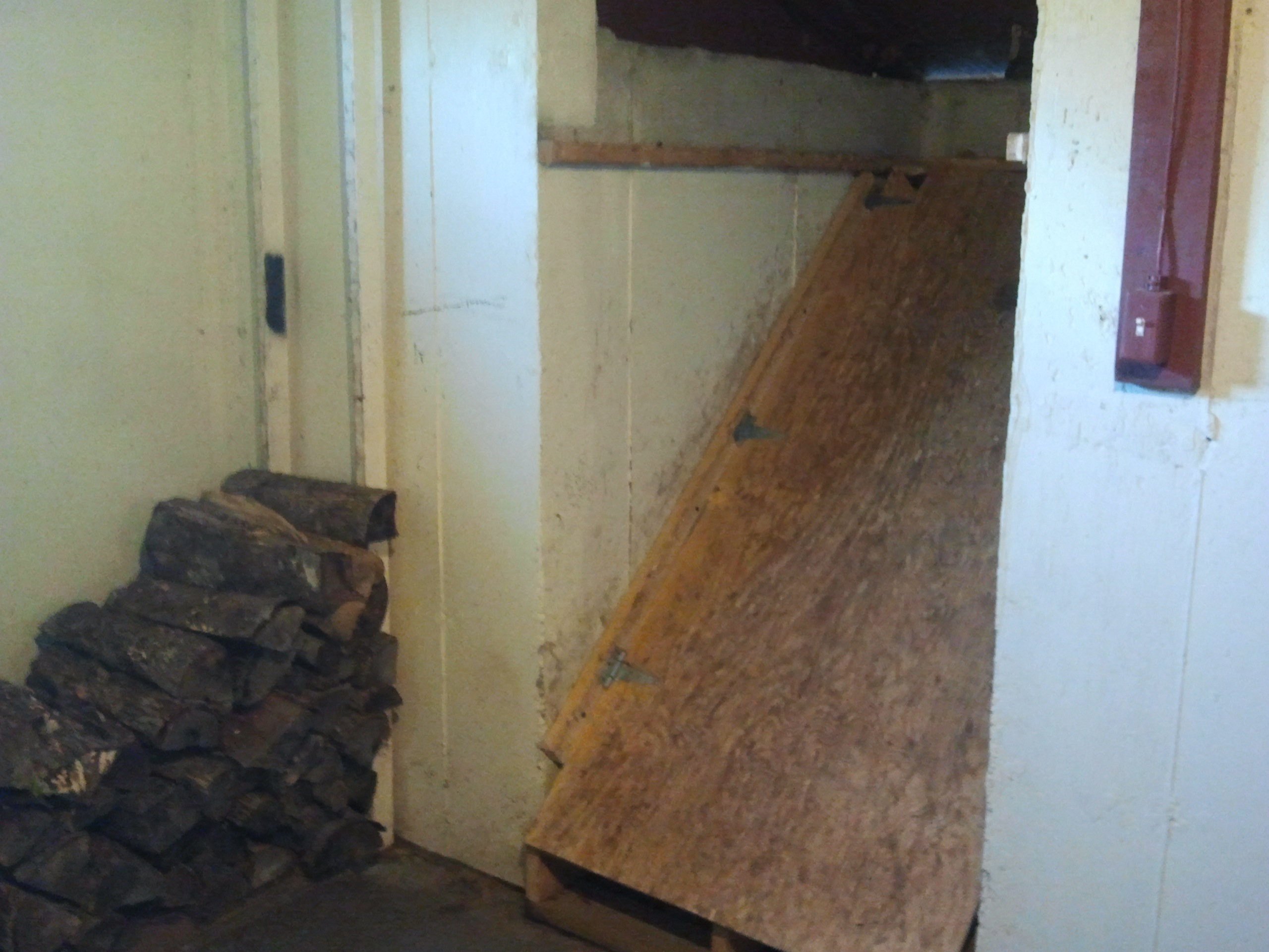

I hinged a piece of plywood on the stairs so I can fold it up and use them like regular stairs when I'm done.

Could you get a pallet jack and put a pallet on it and just catch the wood?
